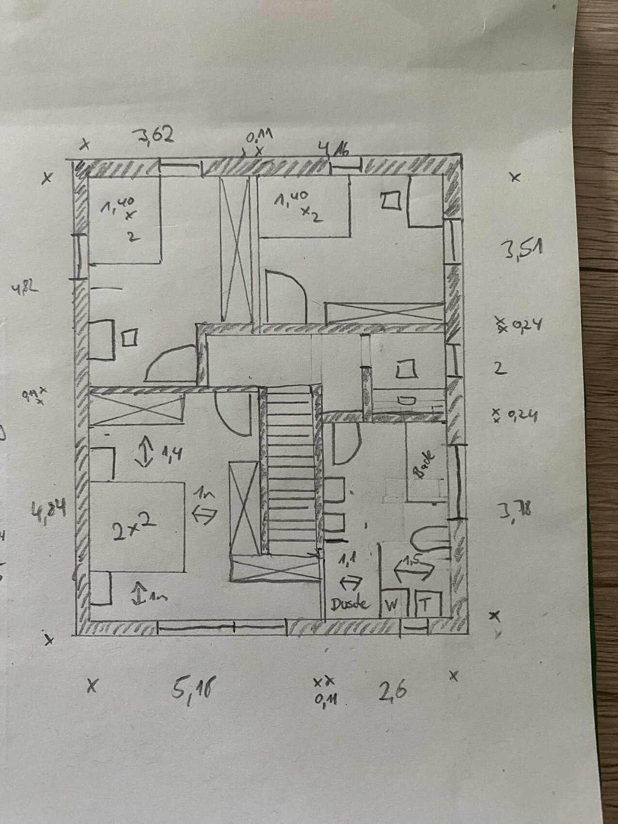

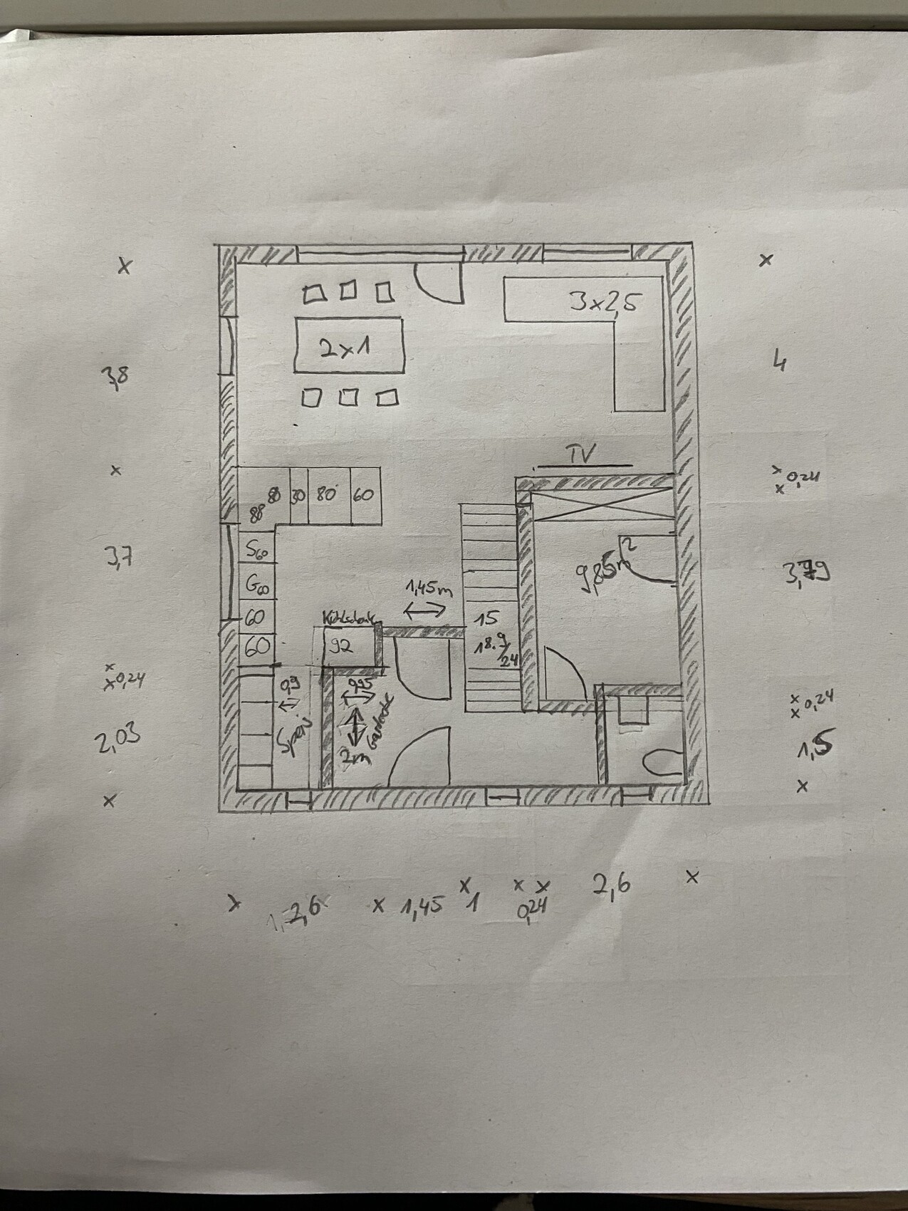

Milka010510 Jul 2025 18:01Milka0105 schrieb:
I spent my evening drawing.
Don’t stone me. But I tried to improve the current floor plan. I will draw the others tomorrow to see which one I prefer.
So, about the floor plan I drew.
What did I do? I swapped the kitchen and living room.
The staircase stays the same, attached. The upper floor layout remains unchanged here, so only the ground floor image is included. The staircase could also be placed on the other side, in which case the upper floor would look like plan 3. In this plan, basically only the kitchen and living room have been switched. There’s a huge cloakroom, a shower/WC, and a nice kitchen with space for the dining table. The living room feels a bit narrow and the hallway is quite tight. Otherwise, the utility room is bigger and includes a niche for the washing machine.
Now to floor plan 2. Staircase to the left. Living room and kitchen have a similar layout. The WC is located behind the living room on the left. This creates a pantry upstairs with access from both the kitchen and the utility room. There is also a small cloakroom.
The narrow hallway and somewhat narrow living room are still negatives.
However, the upper floor is much more spacious and gained an open kitchen as well as an office. Nearly square children's rooms, a master bedroom with the possibility of direct bathroom access, although I didn’t include that. The bathroom feels more airy. I really like this upper floor.
Looking forward to your opinions. Tomorrow I will draw the other floor plans so I can get a good overall impression. I went to the kitchen planning meeting this morning.
First of all, it was a relief. Even in the original floor plan, a kitchen of sufficient size is possible. Everyone has different preferences, but the kitchen is bigger than in some restaurants (exaggerating a bit).
Still, the planner suggested a few improvements like the ones I proposed in my floor plan, which would improve the kitchen even more.

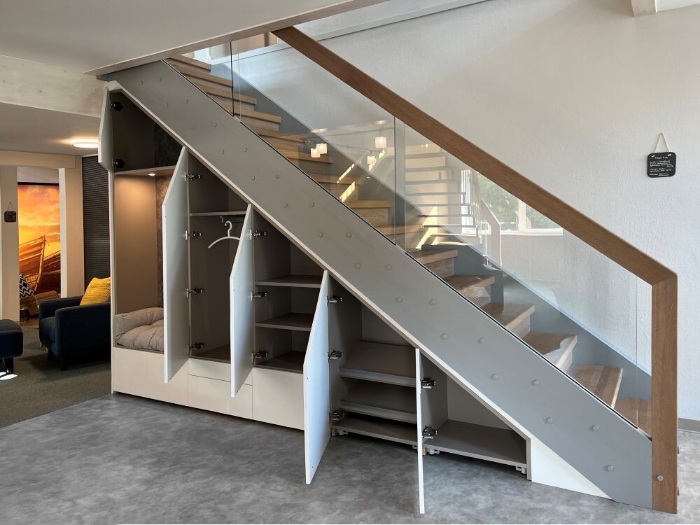

We have now removed the wall and placed the fridge only on one side. This reduces the kitchen width to 2.60m (8.5 feet), and the hallway is practically included in the circulation path. So, 28cm (11 inches) gained plus hallway space.
It might even be possible to build pull-out drawers under the staircase.
This could eliminate the need for a pantry, but I do find a use for that storage space. If not, the pantry wall could be removed to enlarge the cloakroom. So, very flexible.
For now, the staircase will remain open to keep the hallway feeling wider.
The narrower kitchen allowed me to move the staircase 20cm (8 inches) more towards the center, which relieves the utility room and bathroom on the upper floor. The utility room will still have two doors, and I will have this precisely planned by the developer. The guest WC is now just a toilet.
By shifting the staircase, the bathroom became more functional. I swapped the children’s room and master bedroom and completely removed the corridor. The bathroom now extends to the back. With clever planning, a doorway could be made from the master bedroom (I will commission this). A small office was also created.
The children’s rooms, especially one, have a somewhat awkward shape. I could extend the dividing line, which would give both rooms 13.6m² (146 square feet) and add a storage room at the end of the hallway. As it is now, both children’s rooms are about 14m² (150 square feet) each.
As I said, I was out all day and for now have only explored the original floor plan because we liked it. Attached are the images.

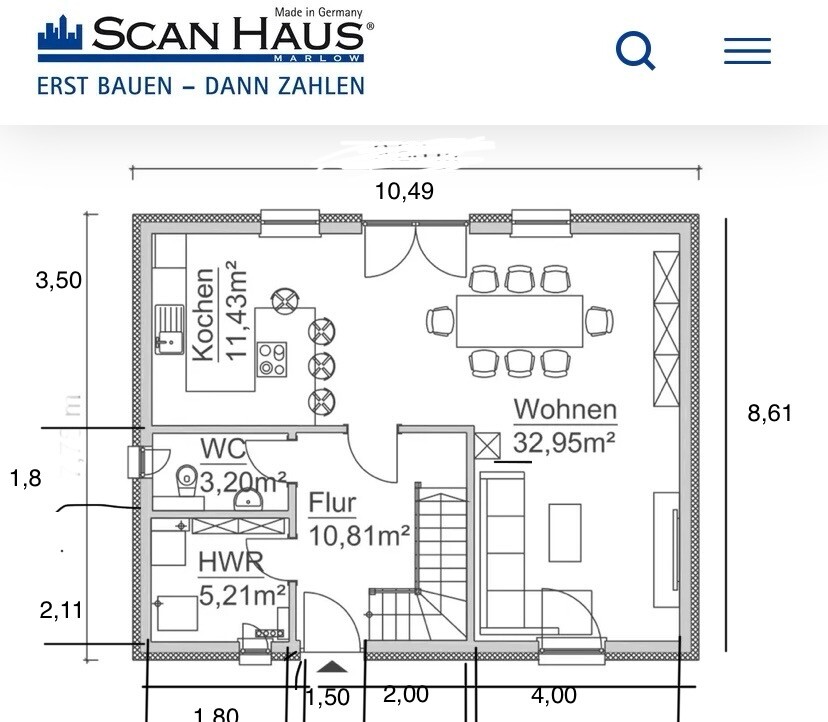

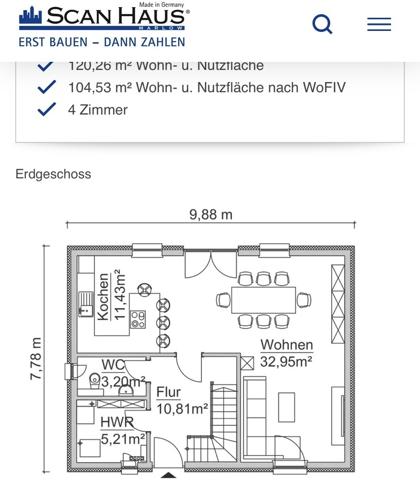

Milka010512 Jul 2025 16:00ypg schrieb:
No, not really, if you leave out the standard elements—kitchen, bathroom, living area, stairs—in a single-family house. The difference in this segment always lies in the details. Here you can see a dressing room, an open space, and a fourth room, which enlarge the house. But you don’t want that. Also, the plot is oriented differently.
Here, the staircase has a very different layout, requiring more space upstairs.
By the way, internal links are allowed here.
You had the two ducts in your original draft on page 1, if I may remind you.
I posted two designs on page 5 or 6. Also, for you, the rough floor plans of the following gable-roof houses fit well—if you raise the knee wall accordingly, you get roughly 140 sqm (1,507 sq ft).
- Almost all smaller Viebrockhaus Maxime and V- houses,
- From Scanhaus Marlow, most variants of the SH 122 slightly enlarged,
- The SH 116 about one meter (3 feet) wider,
- The SH 142 D
(With the SH 145 knee wall, you have the same problematic situation as in your draft, resulting in two narrow areas)
- Weberhaus with its Sunshine series,
- Town & Country with the Landhaus 142 and the smaller ones (noting they then have a higher knee wall).
Heinz von Heiden has declined in their series, so I won’t mention those.
- And many others.
In principle, any standard floor plan will work for you if you adjust the house dimensions accordingly. And it’s easy to stay around ±140 sqm (±1,507 sq ft). The problem arises when a pantry is squeezed into the furthest corner, making the kitchen no longer furnishable and therefore unusable, or when attached to a side entrance. But all that has already been mentioned.So today I worked on the other floor plan. Either I made a mistake, or it’s simply not feasible based on the rough calculations with the other data.
