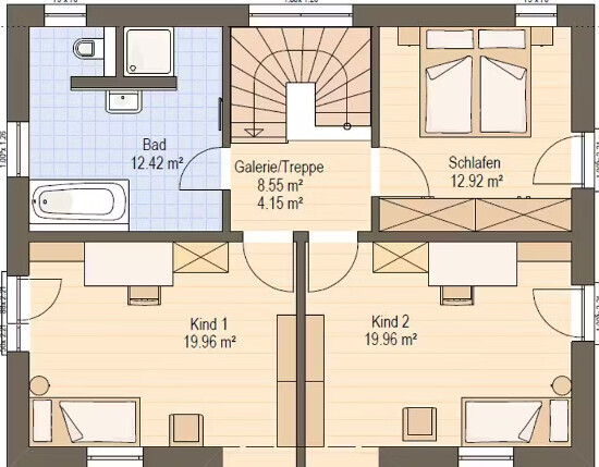

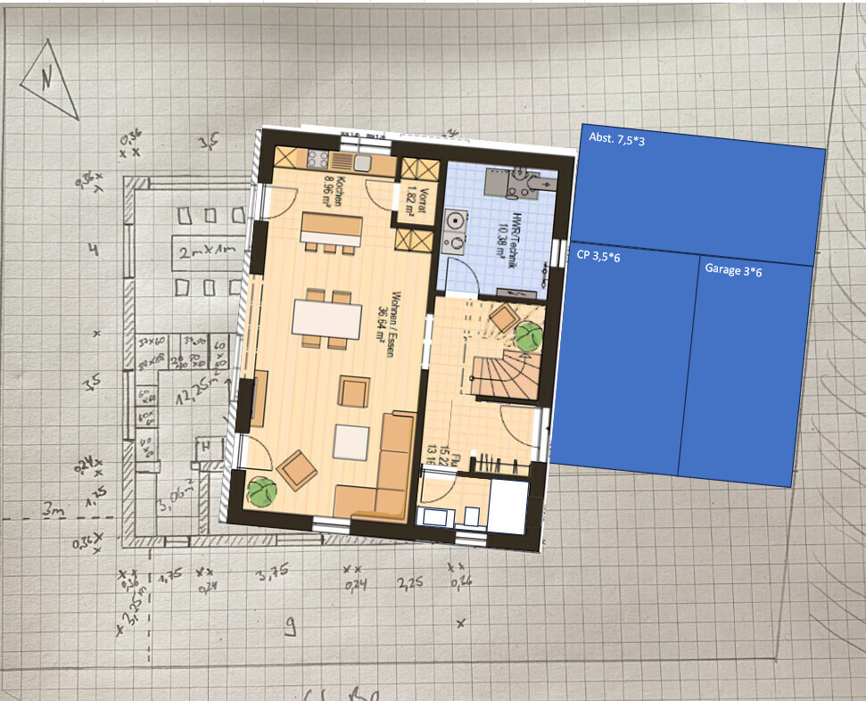

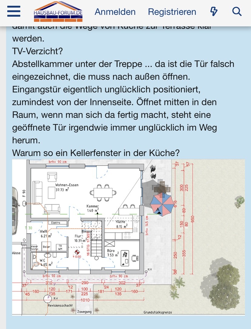

hanghaus20239 Jul 2025 09:59Unfortunately, Bayernatlas is no longer helpful here. The free version doesn’t even show property boundaries anymore. It used to be such a useful tool. Now it costs 40 euros per month. 😡
I’ve slightly modified a design I found online. The original includes a bay window, which I consider unnecessary.

Also, all of the rough floor plans of the following gable-roof houses suit you. If the knee wall height is raised accordingly, you get roughly 140 square meters (about 1507 square feet):
- Almost all smaller Viebrockhaus Maxime and V- houses,
- From Scanhaus Marlow, almost all variants of the SH 122, slightly enlarged,
- The SH 116 about one meter (3 feet) wider,
- The SH 142 D.
(With the SH 145 knee wall, you have the same problematic situation as in your design, where two narrow areas result.)
- Weberhaus with its Sunshine series,
- Town & Country with the Landhaus 142 and smaller ones (note, then with higher knee wall),
Heinz von Heiden has declined in quality in their series, so I won’t mention them.
- And many others.
Basically, any standard floor plan will suit you if you adjust the house dimensions accordingly. You can also easily stay around ±140 square meters (about 1507 square feet).
The problem is when you squeeze a pantry into the farthest corner so that the kitchen can no longer be properly furnished and therefore doesn’t work – or add a secondary entrance there. But that has all already been mentioned.

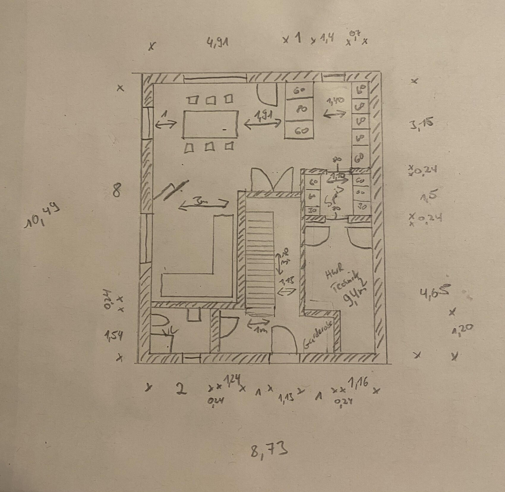

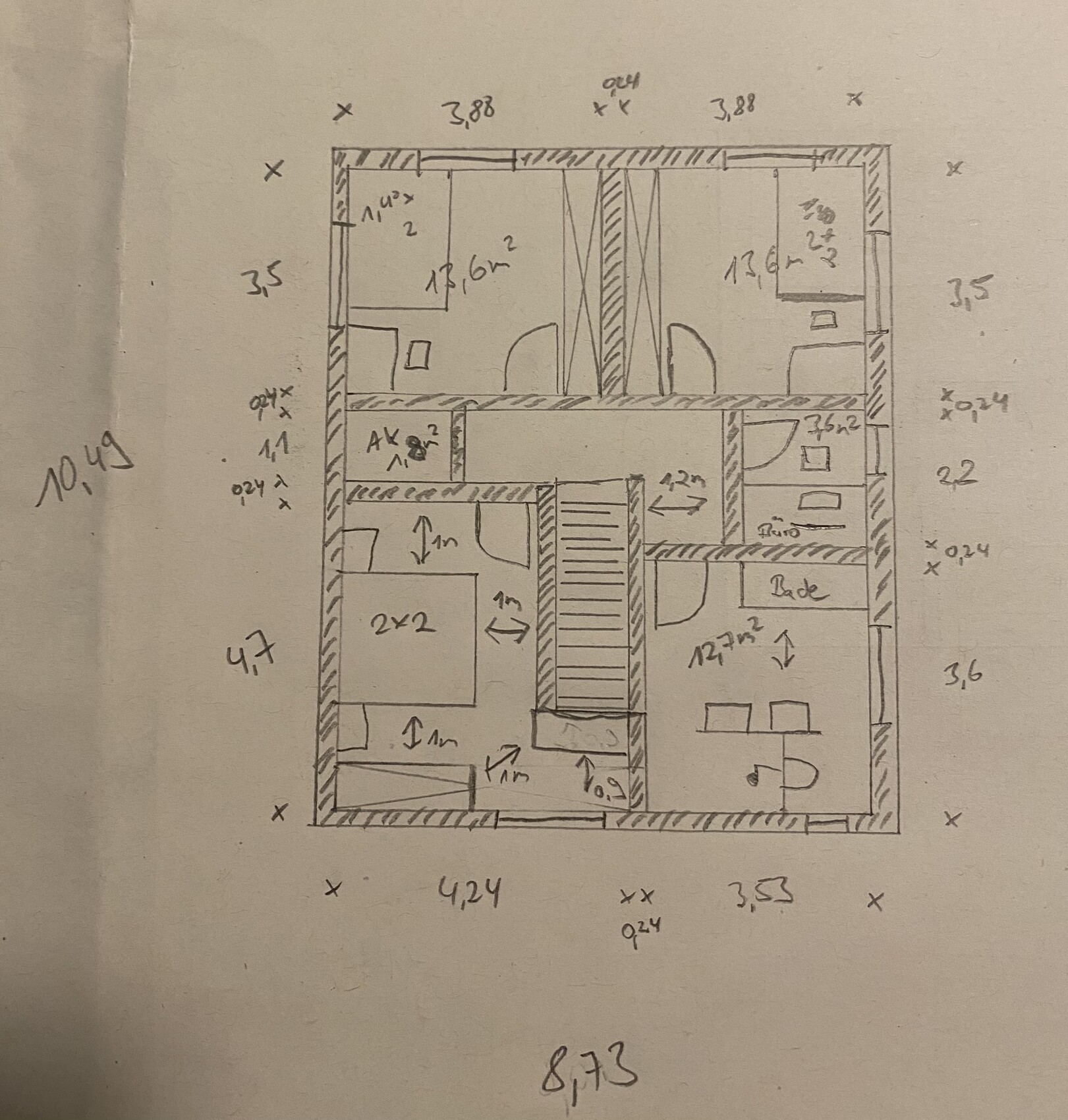

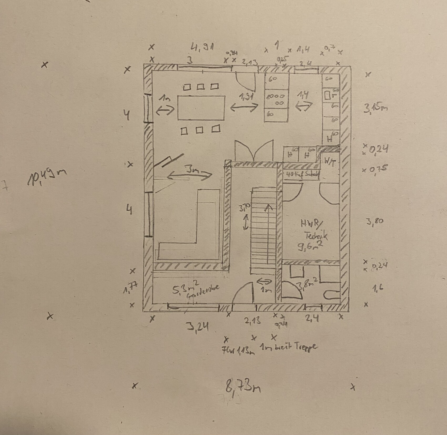

Milka01059 Jul 2025 22:57I spent my evening drawing.
Don’t judge me. But I tried to improve the current floor plan. I will draw the others tomorrow and then see which one I like better.
So, about the floor plan I drew:
What did I do? I swapped the kitchen and living room.
The staircase stays the same, attached. The upper floor layout also remains unchanged. Therefore, I’m only showing the ground floor. The staircase could be placed on the other side here, which would make the upper floor like in image 3. This floor plan basically only swaps the kitchen and living room. There is a large wardrobe, a shower with WC, and a nice kitchen with space for the dining table. The living room is a bit narrow and the hallway is quite tight. Otherwise, the utility room is larger and includes a niche for the washing machine.
Now for floor plan 2. Staircase moved to the left. Living room and kitchen have the same layout. WC is behind the living room on the left side. This creates a pantry upstairs, accessible from both kitchen and utility room. A small wardrobe is also included.
The hallway is still narrow and the living room remains a bit narrow.
On the plus side, the upper floor is fully optimized and now includes a small kitchenette (AK) and an office. The kids’ room is almost square, there is one bedroom where direct access to the bathroom could be possible – though I didn’t implement this. The bathroom feels more spacious. I really like the upper floor.
I’m looking forward to your opinions. Tomorrow I’ll draw the other floor plans as well, to get a better overall impression.

Regarding the latest designs, some unordered thoughts:
- The pantry feels like a burden in all versions (because of conflicts between storage and circulation space). Given the house size, I would seriously consider rethinking the staircase, for example, incorporating storage space under the stairs.
- The last two ground floor plans, as shown with the sofa’s position, do not really allow for a good TV placement (TV in front of a window? Alternatively, turn the sofa if there isn’t a floor-to-ceiling window. But then there might be glare on the TV. A 3 m (10 ft) distance is possible but might feel a bit tight).
- Personally, I find the passage next to the stairs too narrow. In the hallway, two people, one possibly carrying groceries, should be able to pass each other comfortably. Otherwise, there could be a "construction site traffic light" situation. You can live with that if you are aware of it beforehand.
- Ground floor redraw 1: unless the exterior design or a north-facing wall really requires it, I would avoid a large window in the wardrobe (the larger the window, the more it needs shading).

Milka0105 schrieb:
As I mentioned, the contractor must do the verification. But at 7.5 m (25 feet), everything should fit. Floor plans in typical production houses are similar in size anyway.
These are often a big pitfall because they tend to be too small.
Depending on the heating technology, space can become very tight. A lot needs to fit inside the room, especially if photovoltaics are to be added.
Maybe this is an idea to review everything again:
The house should be a combination of two different aspects:
1. What does the plot dictate? What are the site conditions? (This affects things like whether there is a basement or not, window placement for views and daylight, main entrance location, as well as external dimensions depending on the plot.)
These questions set many parameters, and I would not underestimate them.
2. What are the family’s needs regarding the interior? What do they want? What is important to them? What is less important?
Based on the plot’s limitations and family needs, you can try to create the best possible combination, always asking, "How well will it work in everyday life?"
- I sense between the lines that the long staircase is desired. If I had to keep it: I don’t like the lack of natural light axes near the entrance area (despite the tight space, compromises must be made). These could be improved by adding: a side window next to the front door, a door to the open living area with glazed elements, internal windows between the living area/hall and the hall/utility room, and a suitable window in the utility room. (But be sure to consider wall and storage spaces carefully! I doubt there’s enough room, but I would at least check.)
- Personally, with these house dimensions, I would place a half-turn staircase along an exterior wall with the pantry underneath. Then add a nice window in the staircase area to bring light into the house (currently, the new ground floor plans show no window on the right side). This change would significantly improve the layout. (Personally, an open or long staircase is not important to me; see above regarding needs.)
