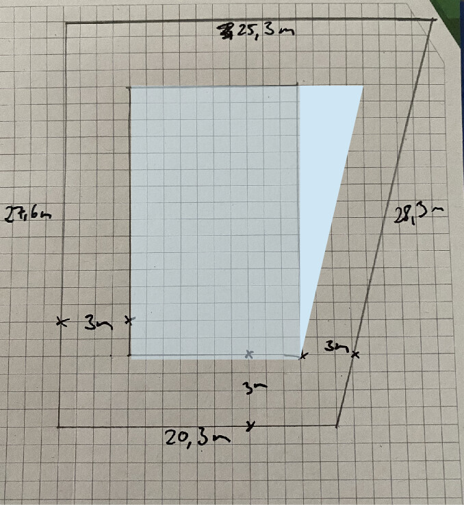

Milka0105 schrieb:
I’m not sure what you mean by that. That’s probably why I wasn’t able to answer. It seems you’re ignoring part of the building envelope:
Milka0105 schrieb:
What is approved can at least be built eventually. This pushes the house towards the southeast property line.

Milka01058 Jul 2025 18:4511ant schrieb:
You seem to be overlooking part of the building window: Yes, I hadn’t realized that. But it doesn’t really help me with the floor plan issue. Apparently, everything fits. Whether it’s 9.5 x 9.5 or 10.5 x 8.6 meters (31 x 31 or 34 x 28 feet), but apparently my idea doesn’t match the size.

Milka0105 schrieb:
In the evening, the sun sets behind the hill and the forest. Where exactly? Where is the hill, and where is the forest?
This kind of information should be included in the original post. We keep going around in circles in this discussion because facts are only provided after asking three times and five pages later.
Milka0105 schrieb:
A lakeside terrace is not an option for us. Is that now a reason for you not to have a terrace at all? I mean, you can’t plan one properly if you only have a narrow strip of land left there.
Besides, a terrace has nothing to do with sunlight. A terrace means an outdoor seating area. The first one belongs to the house.
If someone wants to sunbathe, they can go out onto the lawn.
