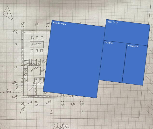

I have some doubts about the plot’s location. Without a building permit / planning permission, it’s hard to say much. But in my opinion, this should be the goal.
Architektur-Grundriss mit überlappenden blauen Rechtecken, Haus 10,6×8m beschriftet
After all, you do want to have some garden space with your new home.

hanghaus2023 schrieb:
I doubt the location on the plot. Without a development plan / zoning plan, it’s hard to say much. But in my opinion, it should be aimed for like this.
You still want to have some garden space at the new home, after all.

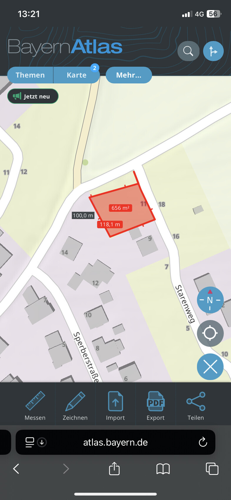

Thanks for the input. The garden at the back is about 10–12m (33–39 feet) deep. But I still like the positioning you suggested. I will check if it’s allowed since everyone else has built facing the street.

That is specified in the development plan. Please tell us its name. No links are allowed here.
Milka0105 schrieb:
The garden extends about 10-12m (33-39 feet) at the back.
Where exactly? I don’t see that in your plan. Show us the cadastral map. That also shows what is happening in the surroundings.

Where exactly? I don’t see it in your plan. Please show the map from the land registry. That also reveals what’s going on in the surrounding area.
There is nothing about that in the development plan. The roof can be oriented either perpendicular or parallel to the street. All roof types are allowed. So I can rotate the house however I want, but whether it can be shifted sideways is unclear to me.
