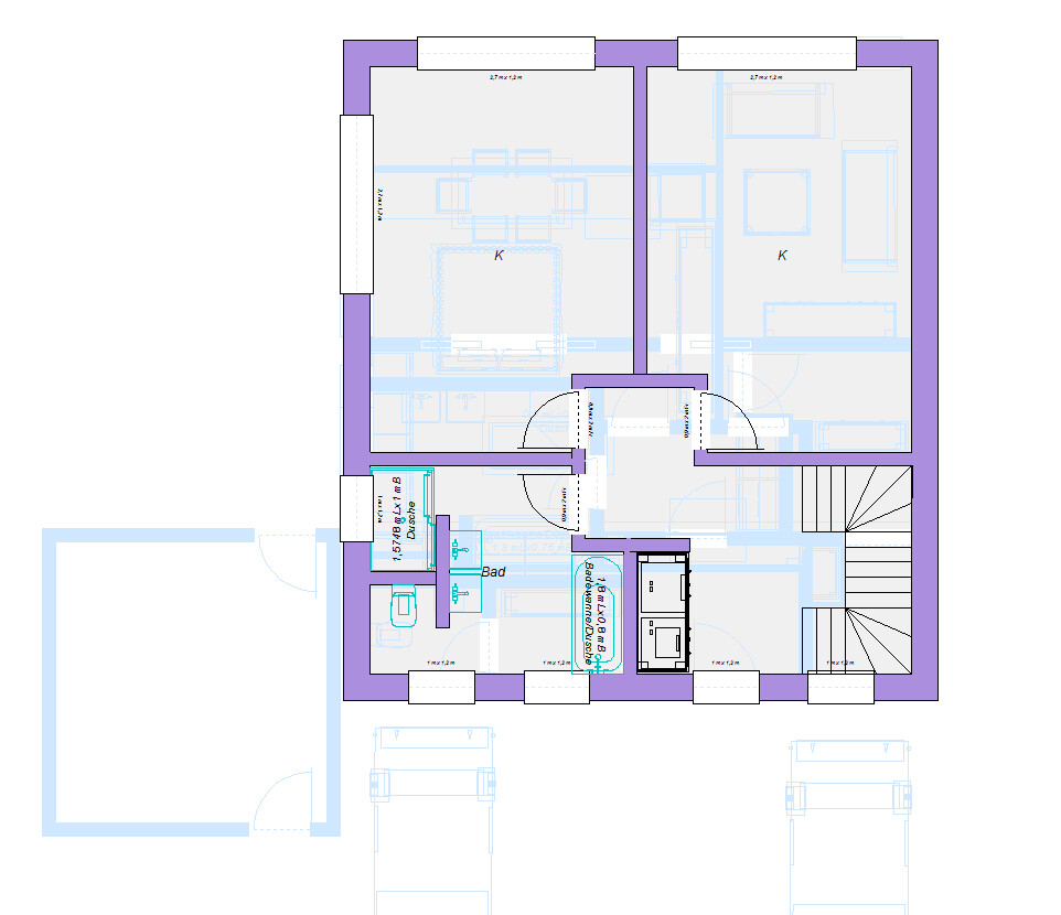

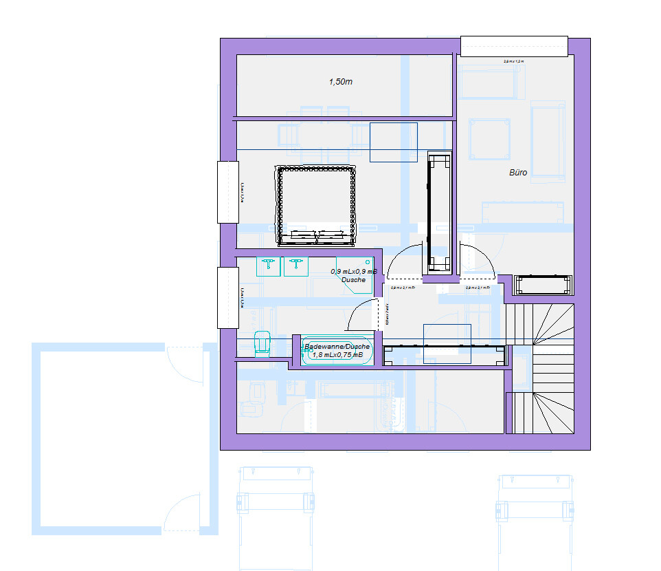

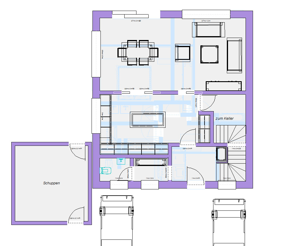

we are planning to build a semi-detached house with 2.5 stories plus a basement. We have received a first draft from the general contractor and would like to discuss it with you.

Ground floor = living/dining + kitchen + WC + storage
Upper floor = 2 large children's rooms + family bathroom
Attic = bedroom + office + WC/bathroom

- Living room: are the windows chosen too large?
- Children’s rooms: how do you find the layout, especially child 2’s room?
- Family bathroom: is the passage to the toilet and shower too narrow?
- Office: 2 m (6 ft 7 in) depth is reached quickly after the entrance; the dormer exists but I’m unsure how the room will feel. What do you think?

K a t j a schrieb:
30 characters 30 characters 30 characters 30 characters 30 charactersWow, thank you very much for your effort. I really like the floor plan and the room layout. Is there any way to fit a carport in here? 🙂
Maybe push the house as far back as possible and replace the shed with the carport. I will discuss this with the planner.
Thanks again.
corby_81 schrieb:
Is there any way to fit a carport here? 🙂
As I already mentioned, no. If the local authority does not allow building carports up to the street, then it’s not possible. For me, living spaces always take priority over "car spaces."K a t j a schrieb:
As I said before, no. If the local authority doesn’t allow carports to be built up to the street, then they simply cannot be.
For me, living spaces always take priority over "car spaces." We will consider that. Out of curiosity, are you an architect or do you have a talent for this?
