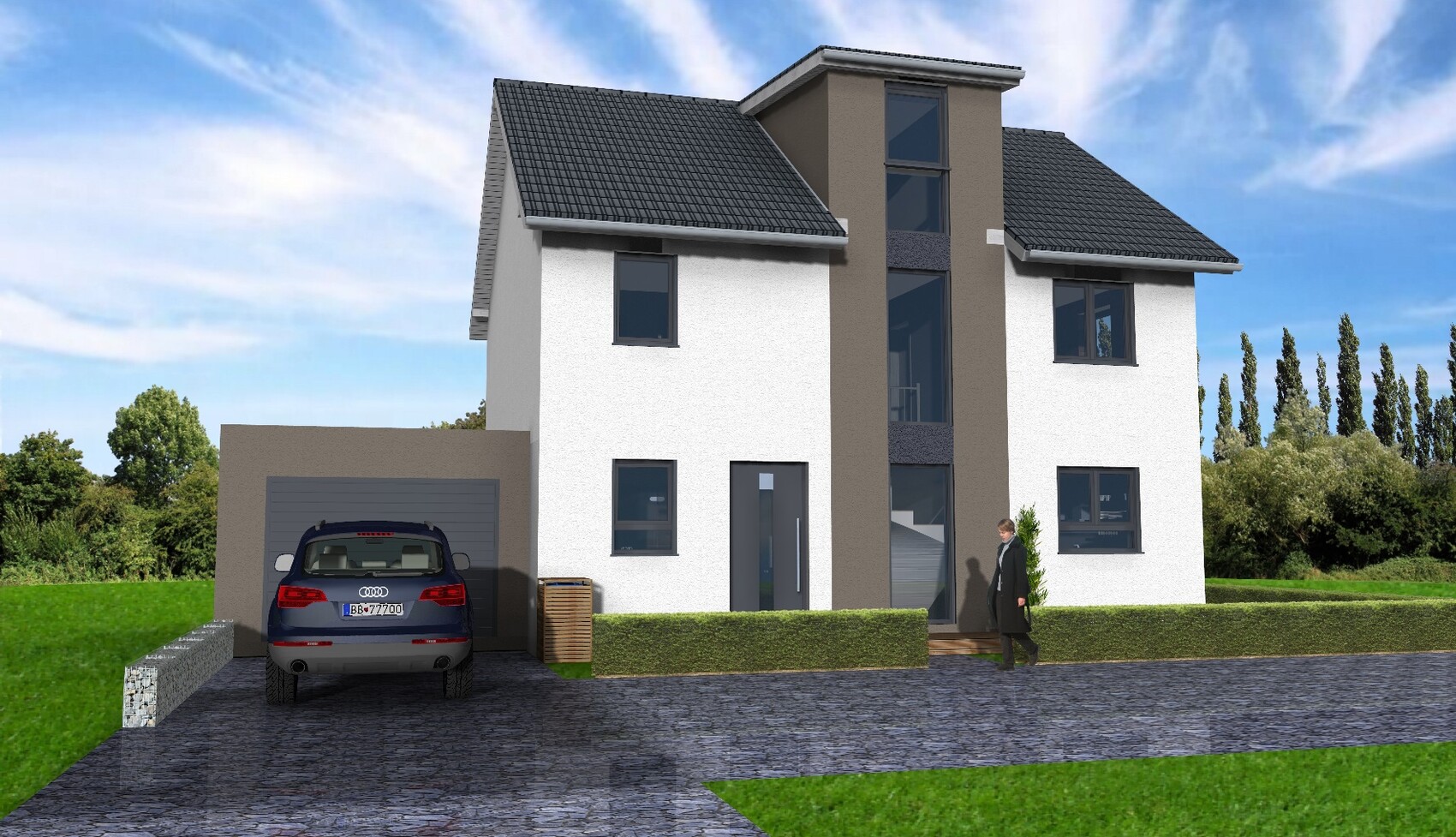

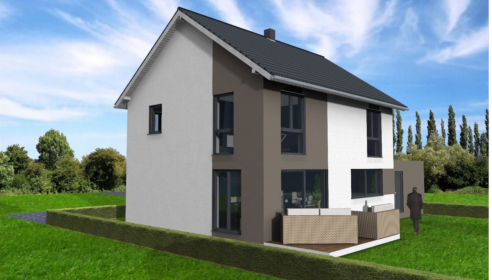

Am I the only one who doesn’t like how the house looks from the outside right now?
It looks like a huge block... It could be an old office building or something like that...
Didn't you want to reconsider the windows or the roof shape to make it look a bit more residential?
From the outside, it's actually not really to my taste either, but these are more subjective impressions compared to, for example, a floor plan.

Attached are two more exterior images; the other pictures don’t look as nice from the outside. However, I really like the house in the correct rendering. On the rendering, the front dormer is still a bit too tall.

Bauexperte28 Jul 2015 18:14hausflat schrieb:
Attached are two more pictures from the outside, The cross gable extends into the attic; if this is not explicitly permitted in the development plan (building permit / planning permission), you will not receive approval!
Regards, Bauexperte
