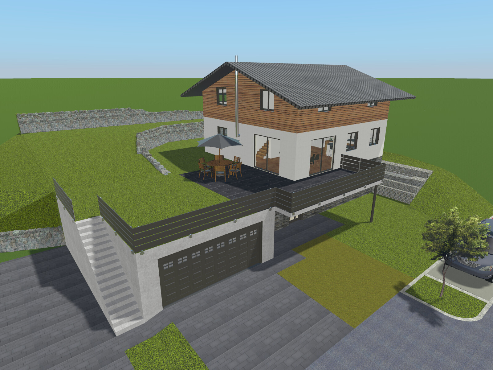

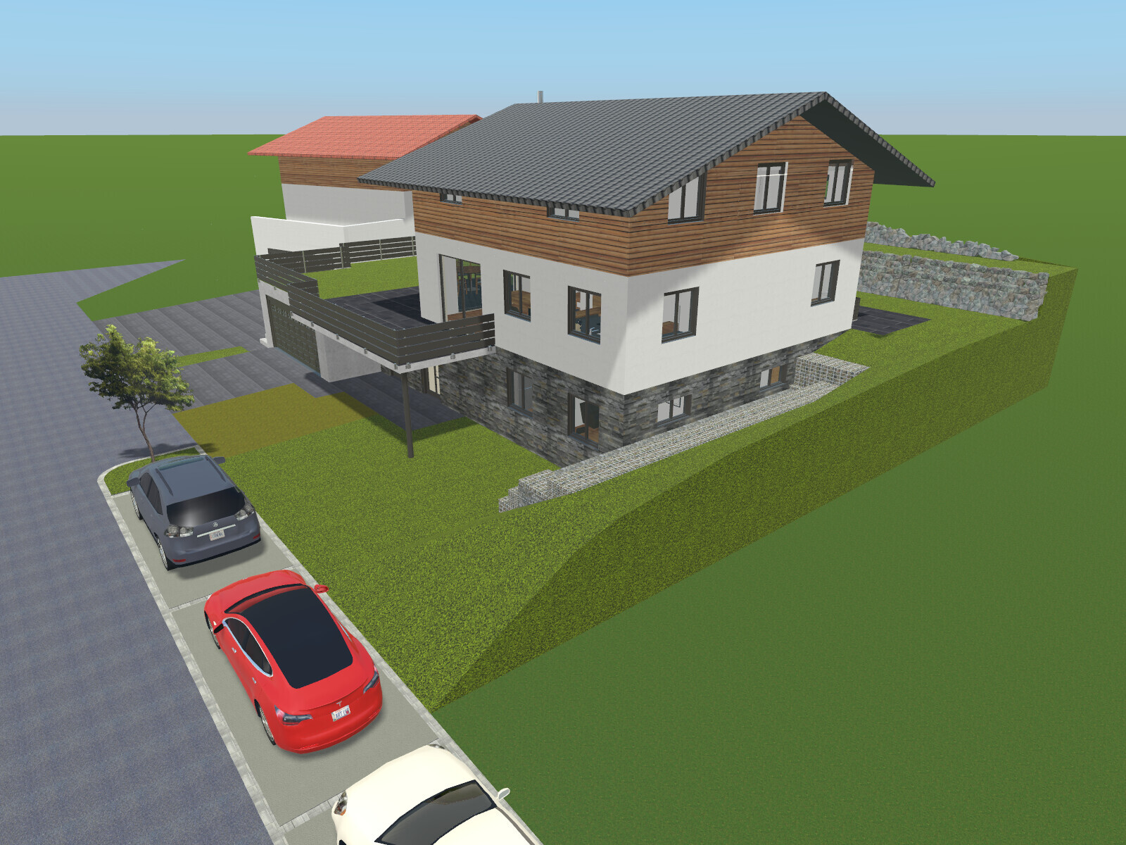

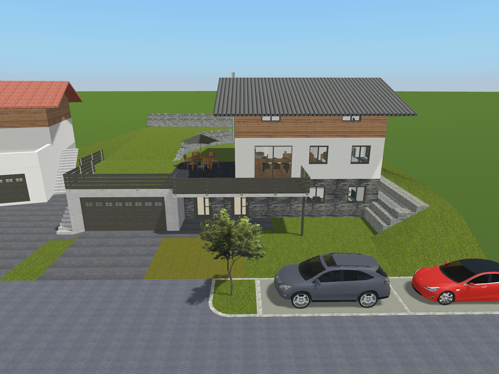

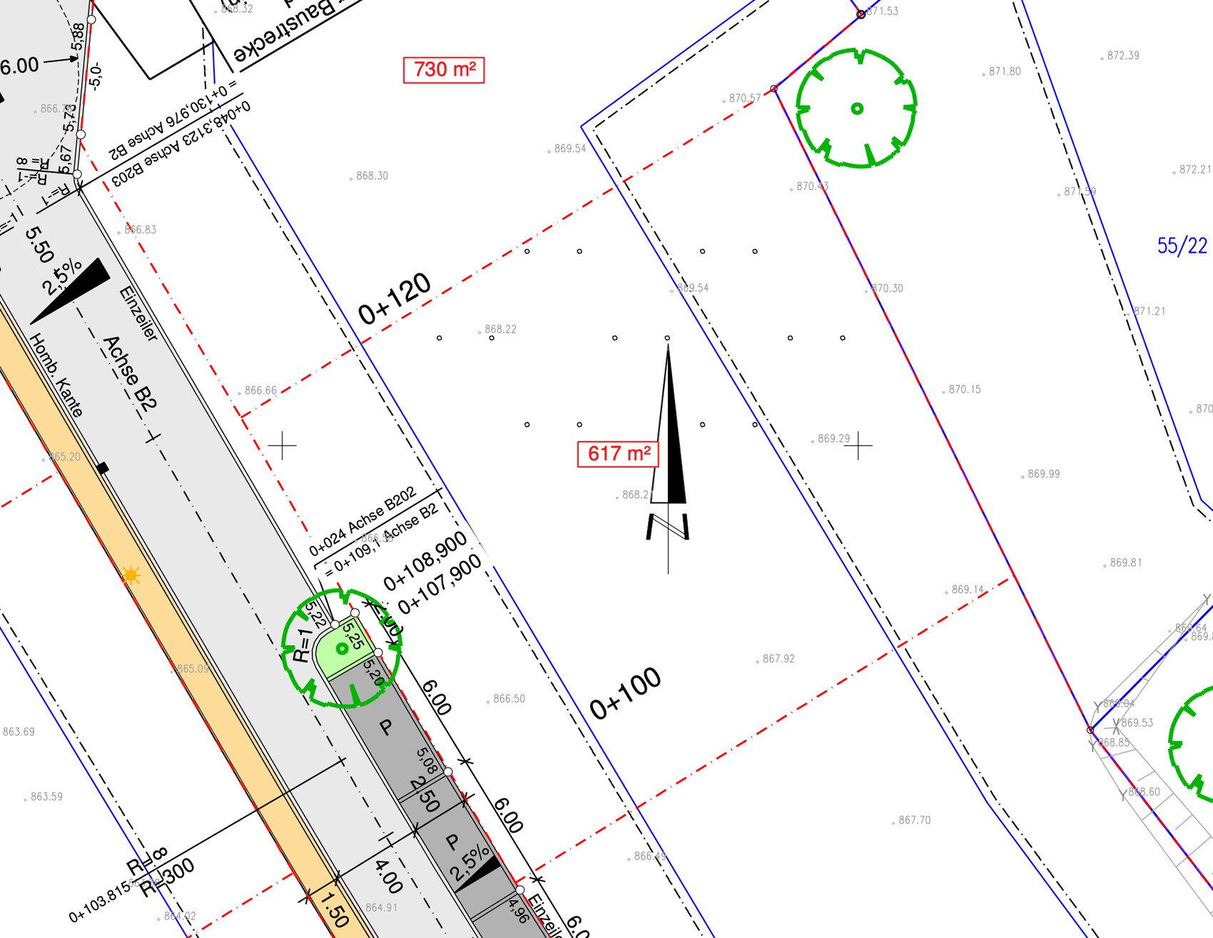

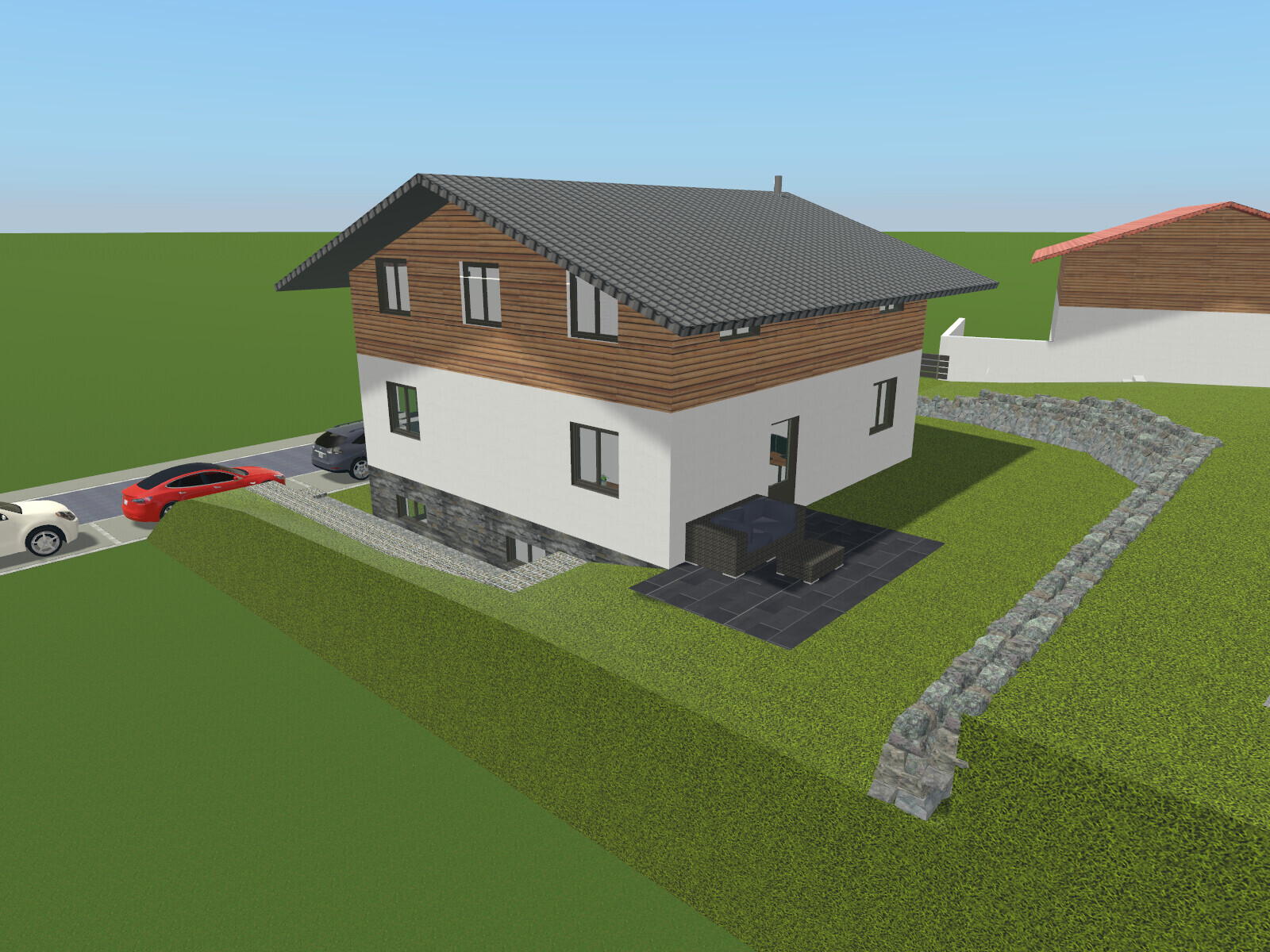

We are currently planning a single-family house on a sloped site above the street. Due to the slope, the basement level is exposed towards the street side, where a secondary apartment (granny flat) will be located. The main entrance to the house will also be at street level and then lead via a long staircase to the ground floor. I’m curious to hear what you think about this concept. Thanks!
Plot size: 627sqm (square meters)
Slope: Yes, the plot is elevated above street level. Measured from street level, about 5.5m (18 feet) at the rear left and 4.2m (14 feet) at the rear right.
Site coverage ratio: 0.4
Floor area ratio: None specified
Building envelope, building line, and boundary: See images
Edge development: According to Article 6 BayBO (Bavarian Building Code)
Parking spaces: 2 per dwelling unit
Number of floors: 3 floors
Roof type: Gable roof
Architectural style: Tiles in red or anthracite
Orientation: Main ridge direction parallel to the street ± 10°
Maximum dimensions / limits: Roof pitch 18-26° / eaves overhangs 0.4 - 1.2m (1.3 - 4 feet) in both directions

We visited another house in the same development that is also on a slope above the street and has a secondary apartment below. We took some ideas from that. It was important to us to avoid having to climb around the outside of the house to reach the entrance and to have the main entrance at ground floor level. We wanted to enter the house directly at street level, covered.

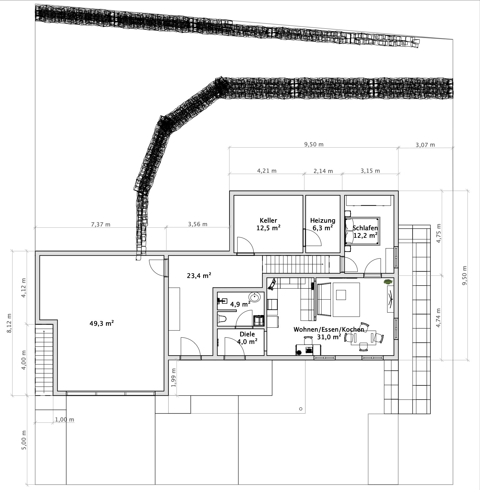

- With this design, we place the house exactly in the southern corner of the plot to enable the secondary apartment
- We believe this is acceptable because there is a morning terrace facing east and a larger area/terrace facing the evening sun
- Because of the secondary apartment, our basement storage rooms are quite limited

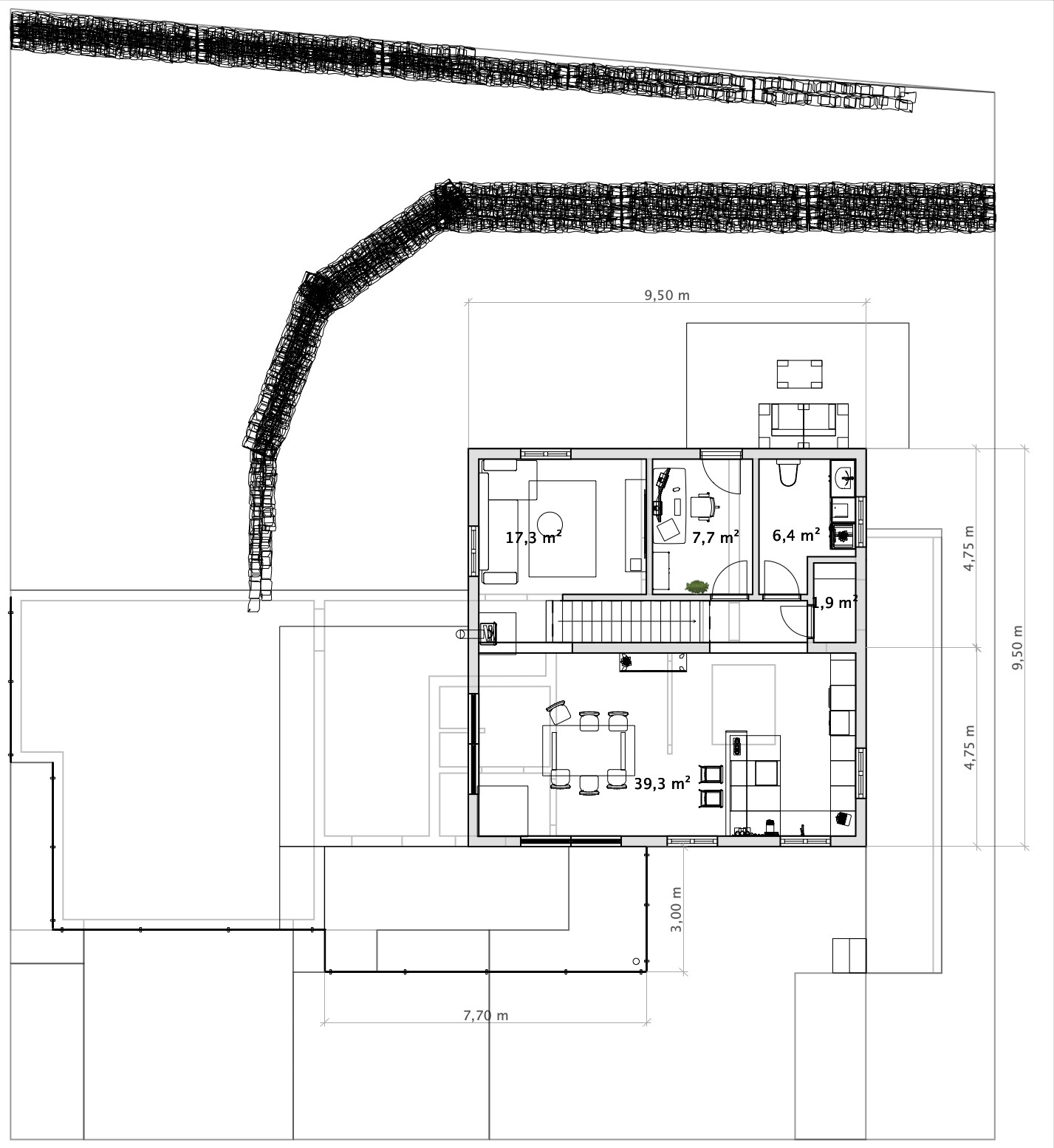

Myrna_Loy19 Jun 2021 18:19Am I correct in understanding that there is barely 1 meter (3 feet) of space between the staircase and the fireplace?
hanghaus2000 schrieb:

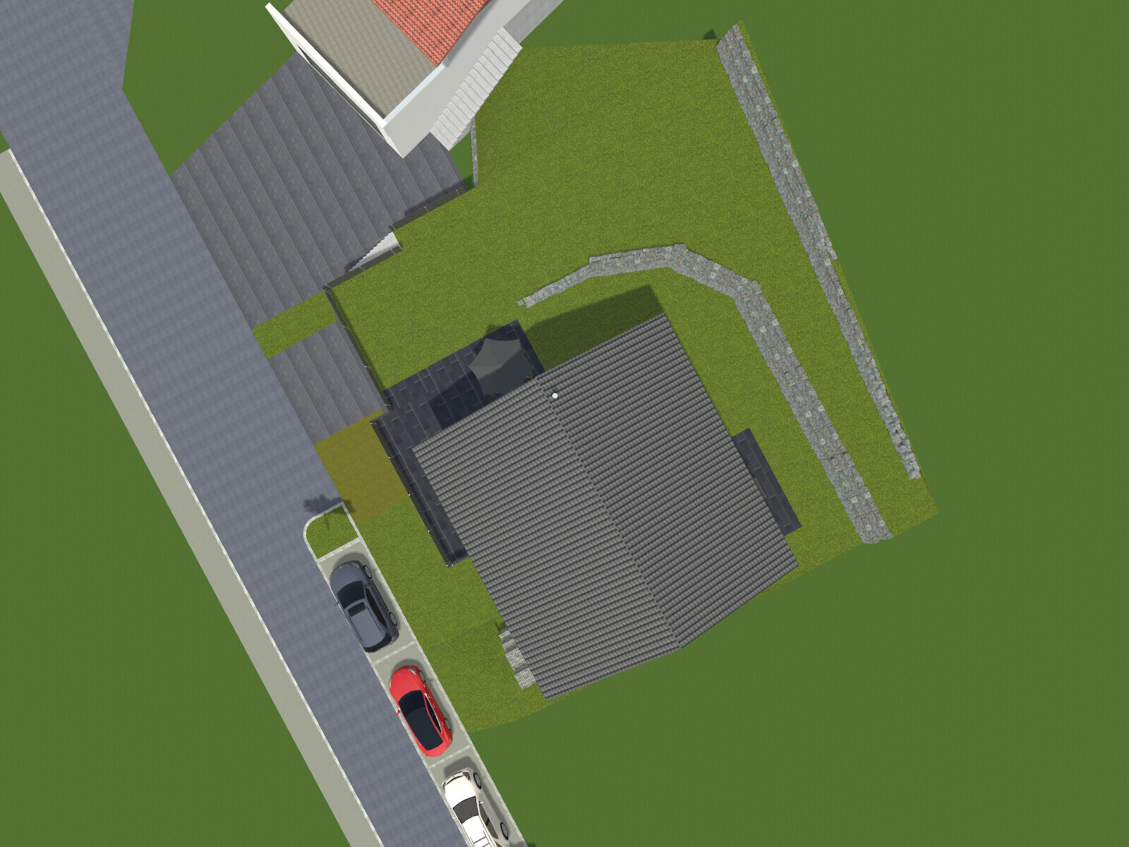

@ypg The north arrow is on the site plan. The street is where the cars are parked. 😉I can see the north arrow! But where is the plot? The house? The access road? There are more colorful images than actual clear overviews shown, aren't there?!
Edit: I see the original poster was here 50 minutes ago and hasn’t made any statement… so I guess this is all settled now since no clarification has been provided 😡
hanghaus200020 Jun 2021 06:40ypg schrieb:
I see the north arrow!
Edit: I notice that the OP was here 50 minutes ago and hasn’t made any statement… so I guess everything is settled here since no clarification has been provided 😡 I understand that not everyone wants to respond in the middle of the night. If at any point you do, I’m happy to help clarify.
