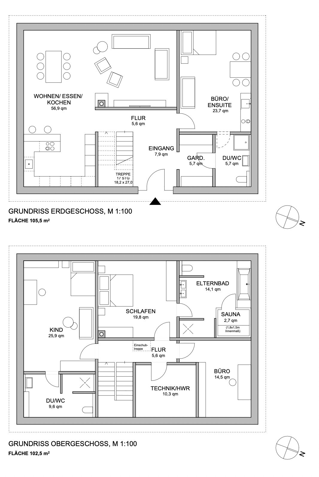

Dear all,
We have been planning for a long time, but I still doubt whether we have the optimal floor plan.
The exterior dimensions are 13.40 x 9.7 meters (44 x 32 feet). We are two adults and one daughter. She should have a children’s bedroom with her own bathroom. The parents want a "wellness bathroom with a sauna." No basement. Therefore, the technical room / laundry must be located on the ground floor or upper floor.
What stands out to you? Do you have any tips? I am interested to know if you notice the same things I do. I appreciate any suggestions on how we can improve.
Thank you very much,
Susanne
Grundriss: Erdgeschoss mit Wohnen/Kochen, Flur; Obergeschoss mit Schlafen, Bad.
haydee

Please add measurements to the floor plan.
Why are there three rooms with bathroom access?
Why is the building services located on the upper floor?
Storage rooms are missing.

The ground floor entrance is optional. The bathroom is initially just a guest toilet / bathroom. Later on, in old age, the bedroom could be relocated to the ground floor.
hanghaus2000
28 May 2021 07:36
The scale 1:100 is useless without a reference point; please provide the dimensions of the house. Nobody really needs windows. Is the ground floor bathroom accessible only through the office?

Could you tell me the dimensions of the house?
They are listed above…
But it’s really quite dark…
The utility room is far too small for practically EVERYTHING…
