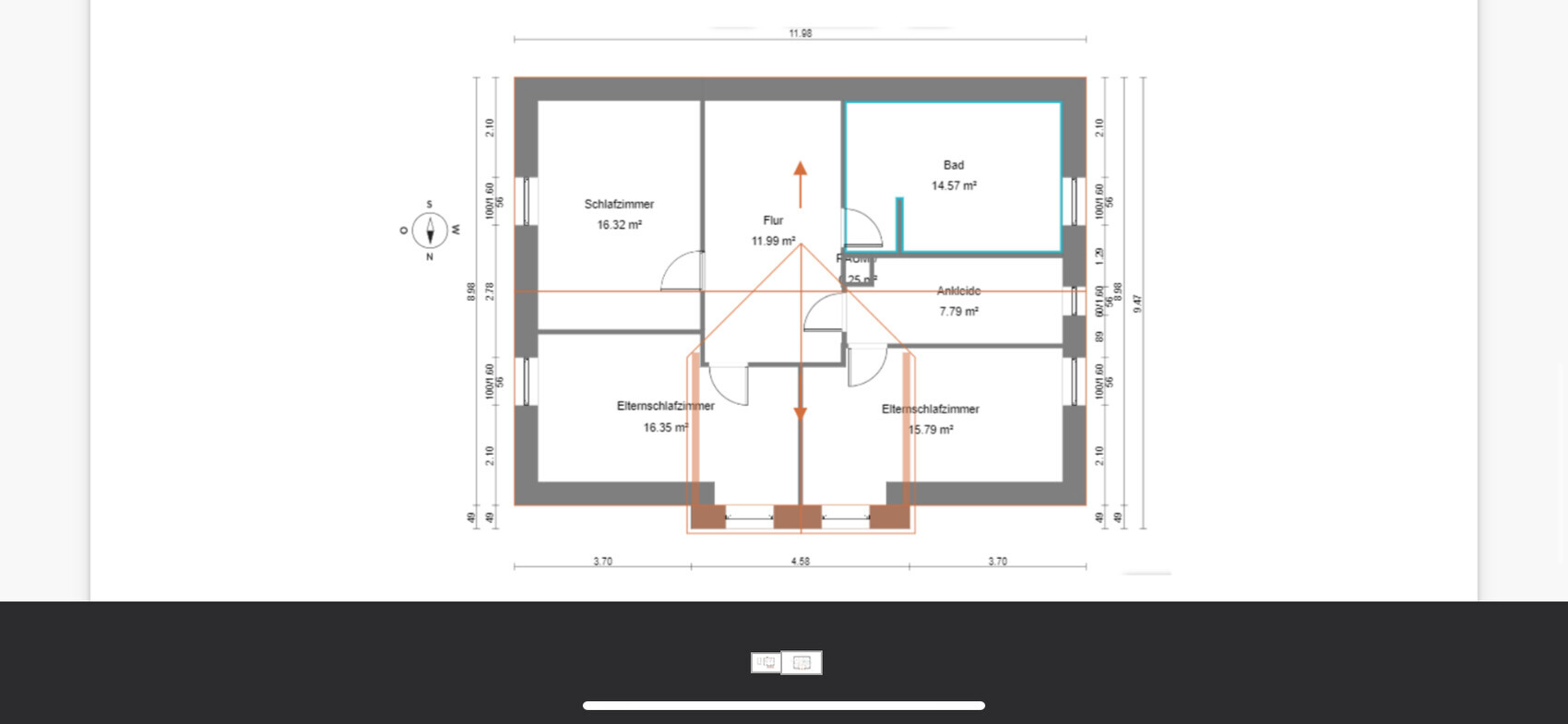

There is a relatively busy road on the south side of the plot, so the living rooms are preferably oriented to the north. Parents’ bedroom preferably on the west side because the neighbor often watches TV in their garden on the east side. We are concerned that this might disturb sleep. The study/guest room should have the option to be a proper bedroom in case a third child arrives and the children then live upstairs.

What do you particularly like? Why? Size of the bedrooms on the upper floor, dormer gable
What don’t you like? Why? Size of the study room, hallway, stairs (does this work as planned?)

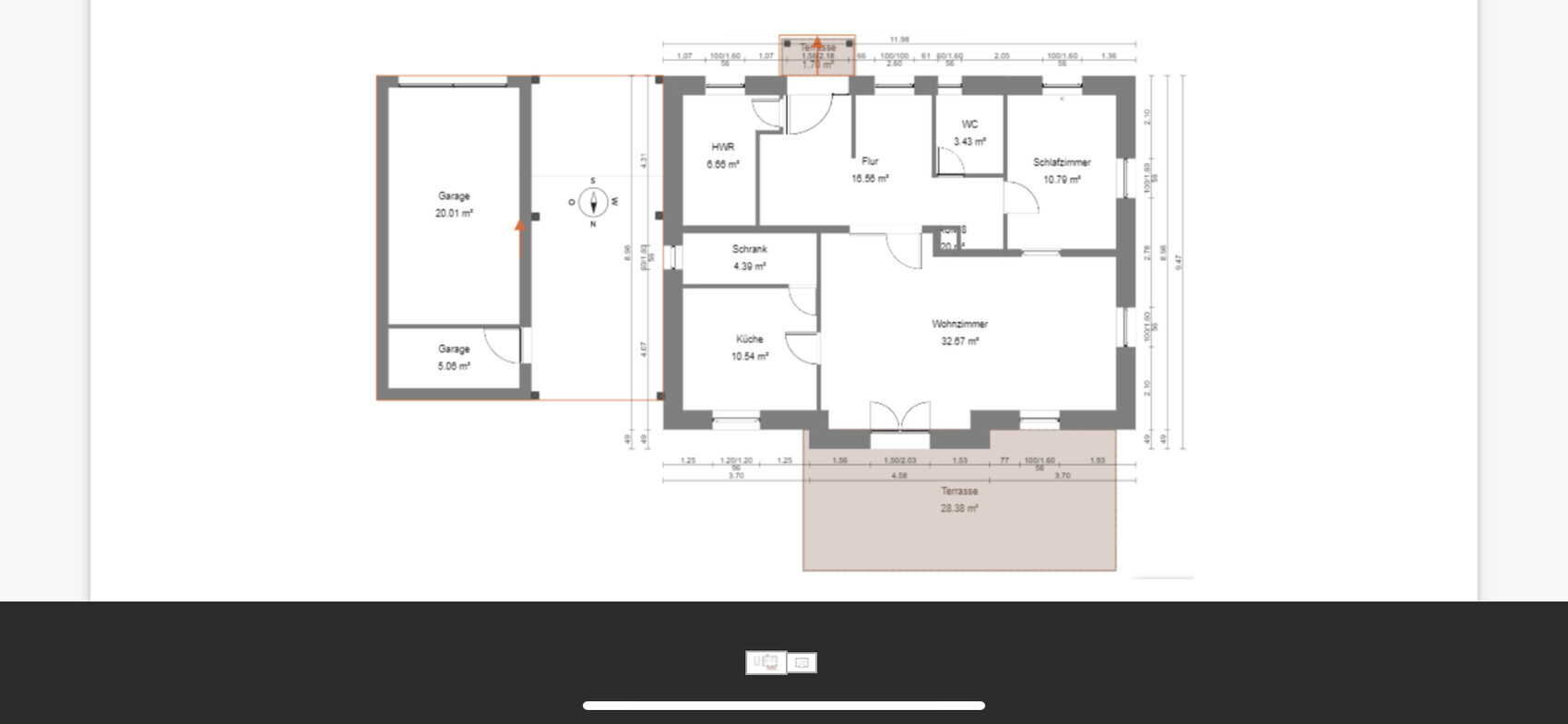

Does the floor plan work as it is? We are in contact with an architect but would like to get your opinion because we have already gained many useful insights here.

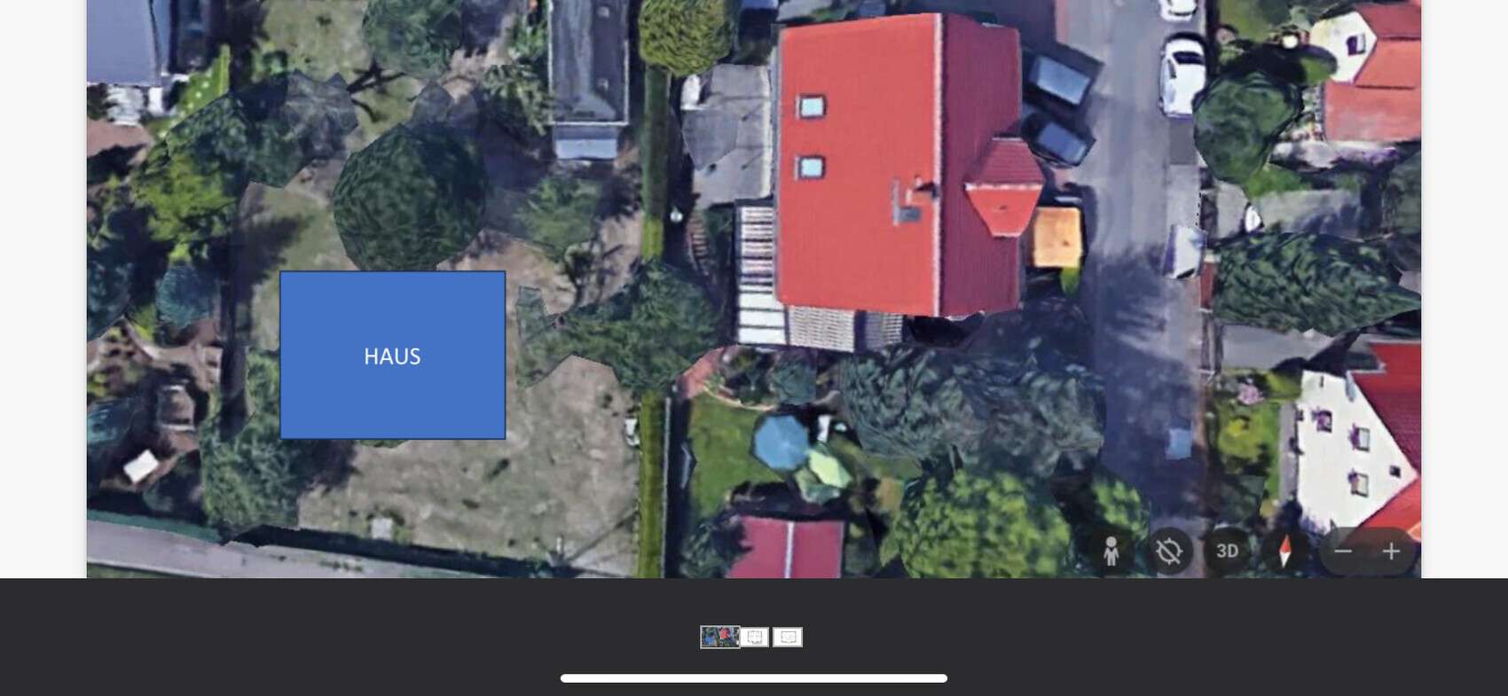

How sensible is the orientation on the plot? We want as much noise protection as possible in the garden from the road. A north-facing terrace is fine for us, especially because of the hot summers.
Is the light in the children’s rooms sufficient (especially the southeast room, which has only one window)?
How can the windows/layout on the south side be improved? The appearance there is less important to us than the north-facing elevation.
Could the attic be converted into a reserve bedroom with a knee wall height of 1.20 m (3 ft 11 in) and a gable roof slope of 40 degrees? Or would it be too hot?
The house was once narrower by 1 m to 0.5 m, but then the space on the ground floor became a bit tight.

P.S. The staircase could not be included properly in the software. It is planned to be located next to the half-height wall in the hallway (top right on the plan?) and be a half-turn staircase. I am a bit unsure about the dimensions but we planned about 2.20 x 2.20 m (7 ft 3 in x 7 ft 3 in).

hanghaus20239 Apr 2024 12:34Is there a site plan available?
Where is north on the aerial photograph?
Brombeerhecke9 Apr 2024 13:19The image is oriented with north at the top and south at the bottom (street side). Unfortunately, I do not have another image at the moment.

Master bedroom preferably on the west side because the neighbor often watches TV in the garden to the east. At night?
Well, I would probably consider the children's sleep more and willingly choose the east side.
I think the utility room is too small and could be twice as large. Technical equipment takes up a lot of space. Also, laundry is done there, right? There is no additional storage except for the attic…
The aerial image section is far too small. At least it is clear that you did not consider the issue of "scale" before inserting the placeholder for the new building. By the way, the insertion requirement of §34 also includes an approximate factual plot ratio (although this is often generously overlooked). You should not underestimate an architect here just because they are better at drawing in the stairs; they will save you a lot of money.
hanghaus20239 Apr 2024 18:39No plan of the plot? You bought it, right? A plan should be included with the purchase contract.
