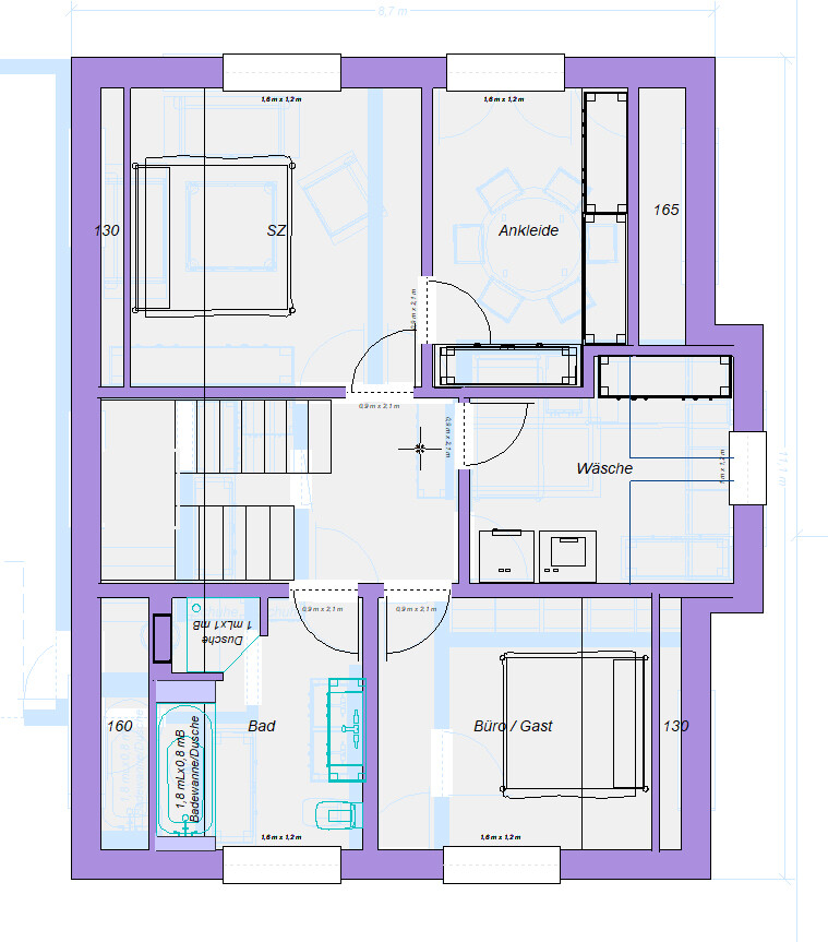

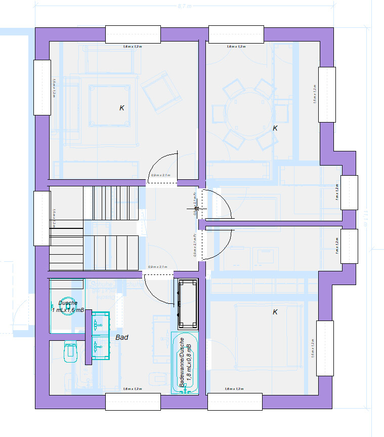

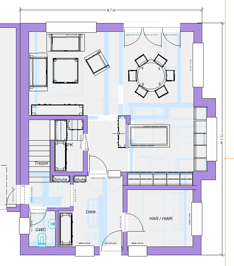

If the original poster (OP) is really willing to spend 600K on the house, I’m a bit surprised by the rather modest design. I’m not exactly sure if we’re still around $300 per square meter, but with that budget, I would expect something close to 200 square meters (about 2150 square feet). I don’t see that here.
I’ll just give an example with an attic conversion and a knee wall height of 1 meter (3.3 feet) and a total height of around 10.60 meters (34.8 feet). Roughly estimated, that’s just over 200 square meters (about 2150 square feet).
I would also add a patio door from the utility room to the garden. I quickly forgot to include that.
I can’t really judge whether the support next to the kitchen island is absolutely necessary. Obviously, it would look better without it.
The children's rooms are around 18 to 19 square meters (about 195 to 205 square feet). If that’s too large for the kids, smaller bedrooms could be planned, and the guest room could be moved upstairs:
At least the OP can consider whether this might be too much house for them. 🙂
K a t j a schrieb:
I’ll just provide an example with an attic conversion You’re basically considering a two-story house plus an attic conversion—okay. That’s also interesting, given that with a 470 m² (5,057 sq ft) plot you’d still want some garden space.
I would have chosen a slightly steeper roof and set the knee wall height at about 160 cm (63 inches). That way, you get suitable room layouts across three levels. In the attic conversion, you’d then have only bedrooms and storage, and on the upper floor a guest room plus three children’s rooms.
