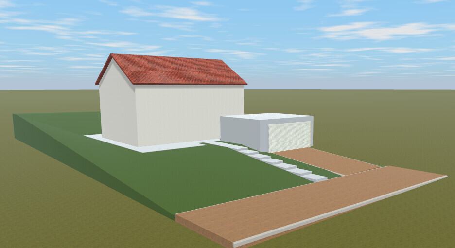

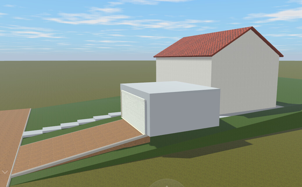

hanghaus2023 schrieb:
Here is a visualization. You can see that no major problems should arise.
If the garage is built higher, the driveway will be steeper and you might need to install L-shaped retaining walls along the boundary. Thanks, that already looks pretty good! However, it would still be better to set the garage a bit lower to make things easier. L-shaped retaining walls are a good solution!

hanghaus202324 May 2025 10:09There are certainly other options. However, for your preference to place the house in the center and have direct access from the garage to the house, in my opinion, the garage located in the southeast is the best solution.
