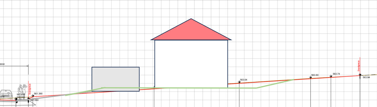

I’ll show you what the 3 steps mean:
Much less earthwork,
Balanced cut and fill,
Much flatter slopes.

Here is a visualization. It shows that no major problems will occur.
A white detached house with a red tiled roof, garage, green area, and stone step pathway
If the garage is built higher, the driveway will become steeper, and you may need to install L-shaped retaining walls along the boundary.

John2122 schrieb:
What do you think about placing the garage behind the house?
Nothing.
John2122 schrieb:
That way, you could gain some height using a driveway, and the level access from the garage to the house would be located behind the house. Additionally, the house can be set higher.
Try drawing that into my latest section. Don’t forget to leave about 5 m (16 feet) between the house and the garage. You probably want to use both garages, after all.
Then you’ll see how deep you can cut into the driveway and garage area.
Alternatively, you can make the house, as I suggested, only 11-12 m (36-39 feet) wide.
I have put quite some thought into why I design the house now as only 12 x 9 m (39 x 30 feet).
If the house is intended to be centered on the lot, then in my opinion 1.45 m (4.75 feet) above the southeast corner at the street is optimal.
You can then cut further back and fill in the front until it suits you. Always keep in mind that no slopes are steeper than 1:2 (vertical to horizontal) and that the earthworks balance out.
