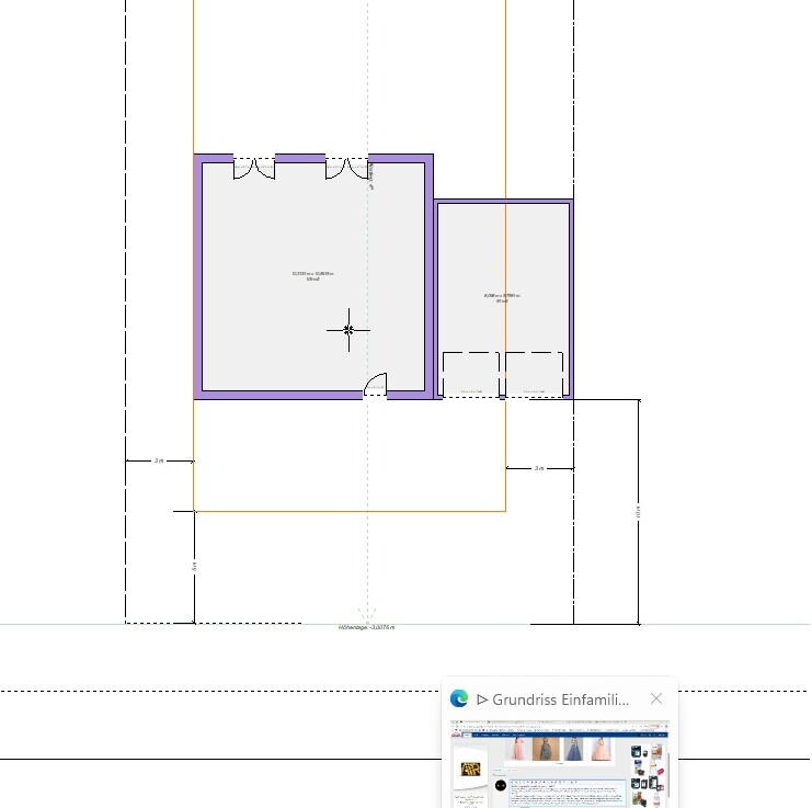

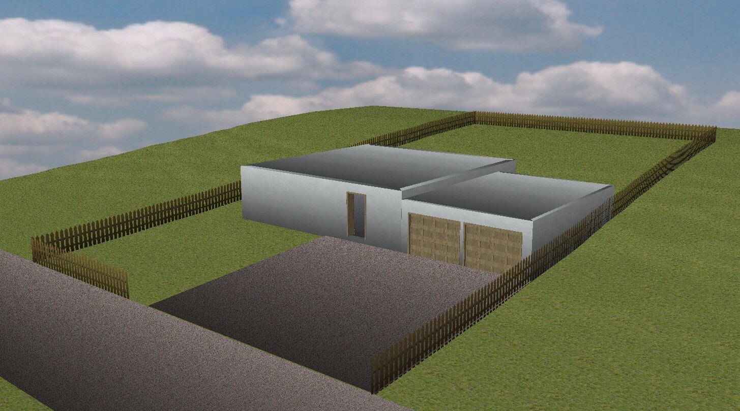

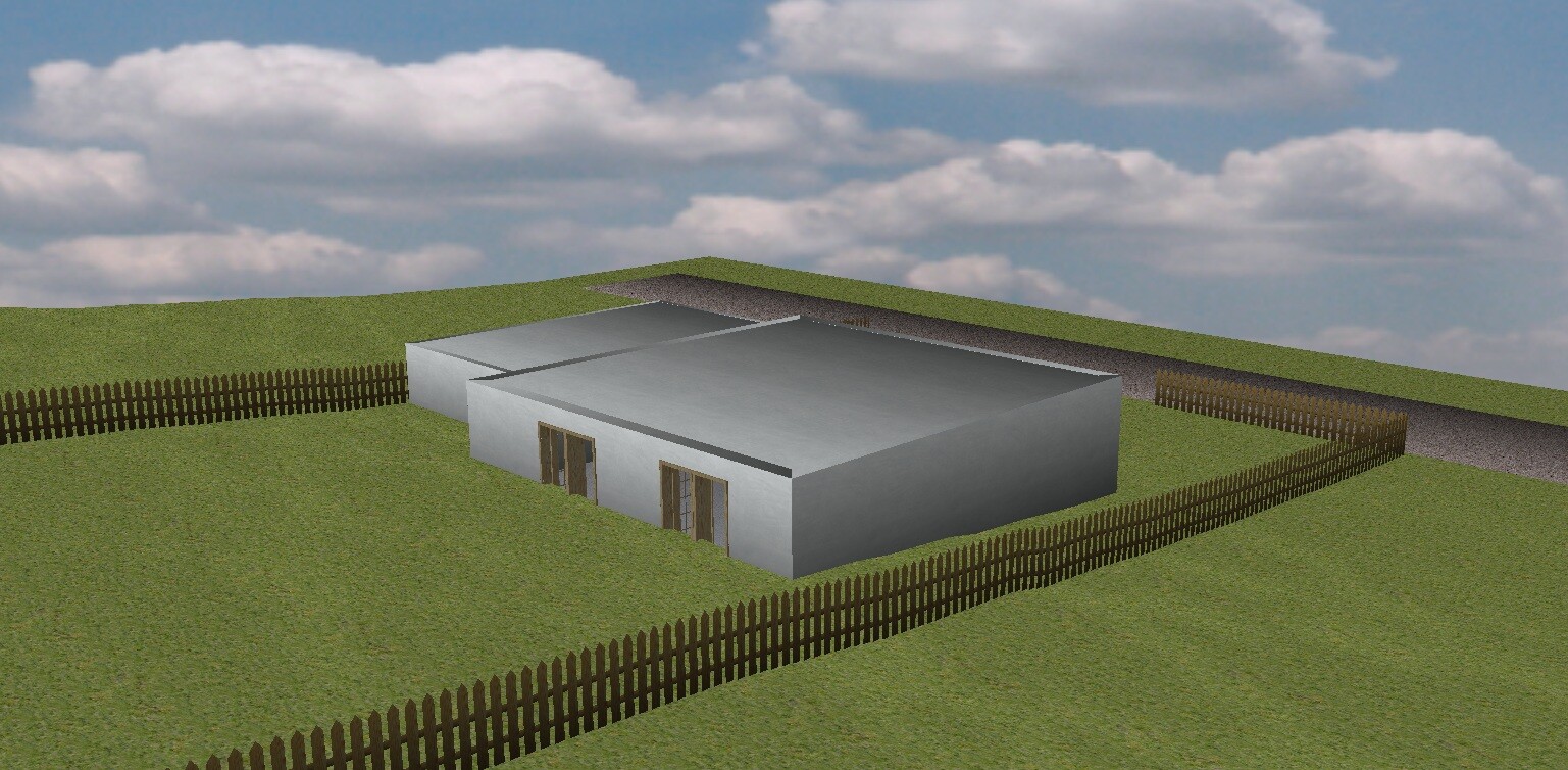

Gray flat-roof building with two wooden doors, freestanding in a green grassy yard with a fence.
Modern flat house with entrance on the left, double garage on the right, fenced plot on a green slope.
Floor plan from above: left room with door at the bottom, right extension room; purple walls.
K a t j a22 May 2025 19:46
The design from #5 picture 4 is not bad, but I think it is also extremely expensive. How many cubic meters of soil is that? Have you calculated it before?

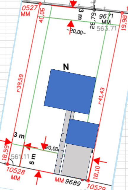

House 9 x 11 m (30 x 36 ft), garage 6 x 7 m (20 x 23 ft), north is at the top.
Site plan: blue main building, outbuilding, driveway, dimension lines.

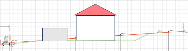

Slope profile: red house with roof, small grey outbuilding, green and red terrain lines.
Driveway has a maximum slope of 10%.
K a t j a22 May 2025 20:08
hanghaus2023 schrieb:
House 9×11m (30×36 ft), garage 6×7m (20×23 ft), north is at the top.
This is quite similar to #5 from the original poster. He now wants the garage directly attached to the house. But how should the excavation look? I assume it would be across the entire width of the plot. That’s quite a large raised bed filled with soil. In addition, rather than a fence, a retaining wall would practically be needed for most of the depth. Rainwater infiltration or drainage would have to be managed across the whole area. Considering the requirements for the house, I estimate the cost at around 800,000 or even more.
hanghaus2023
22 May 2025 20:29
The house and garage can also be set a bit higher, creating a mass balance. However, this would result in a driveway slope of around 15%.
The issue is the garage at ground level.
I have 3 steps leading to the garage, which I can just manage. Something like that would greatly ease the situation.
