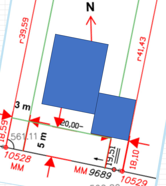

Is it intentional to build as close as possible to the street?
hanghaus2023
22 May 2025 15:31
If the priority is direct access to the house, then it is better to have the house and garage side by side.
Site plan with two blue buildings on a plot, north arrow and measurements.

I know many skilled and reliable craftsmen. This allows us to save a significant amount. The garage is planned but will only be built once the budget is replenished. The second floor will also be postponed and gradually finished later. (The subfloor will be installed, with the interior work to follow at a later stage. This also helps reduce costs).
It’s not cheaper overall, but it means not everything has to be completed from the start! It wasn’t any different in the past...
We would like to position the house centrally on the plot. The garden to the south for the winter months, and the garden to the north for the increasingly warm summer months.

It is important for us to have barrier-free access from the garage into the house. However, this is a bit challenging due to the sloping terrain, as it’s difficult to create the garden level on the same plane without positioning the entire house too far into the slope.
wiltshire
22 May 2025 15:38
I quite like the idea of positioning the house centrally between the two garden areas. Keep in mind that you will need a long driveway to the house. This not only adds cost but could also mean a loss of usable garden space.
John2122 schrieb:
It is important for us to have a barrier-free access from the garage to the house.
Do you mean completely level access, or would a small external ramp also be an option?
