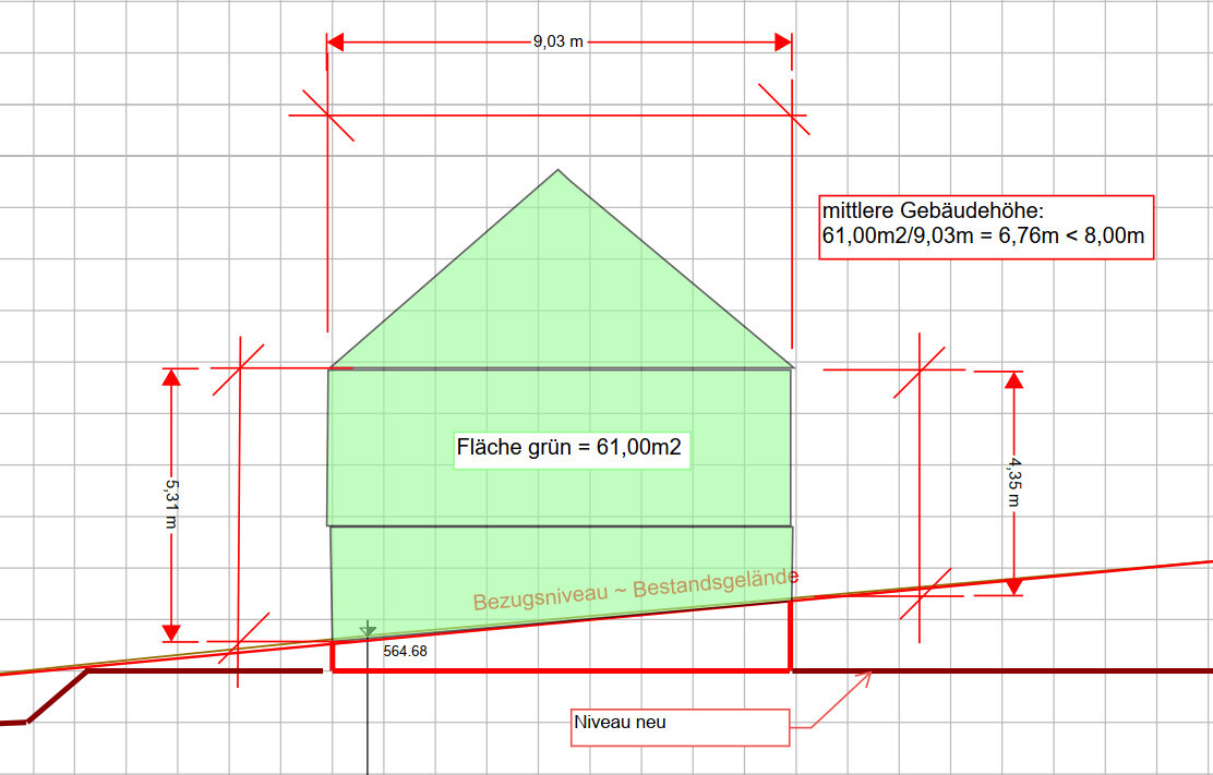

J
John2122
22 May 2025 14:43
From the original site level = reference height, we are allowed to have/build a maximum average building height of 8m (26 feet).
The reference point for the permitted height is the intersection of the new building with the original ground level. Here is a sketch; I hope it is clear enough...
Schematische Zeichnung eines grünen Gebäudes mit Maßen, Fläche 61 m² und Bezug zum Gelände.
"The average building height in Austria is calculated by dividing the area of a building facade by the greatest width of that facade. This results in the average height of that particular building facade."
The budget/cost is estimated at around 650k.
Abroad = Austria.
22 May 2025 15:03
John2122 schrieb:
Plot size: 20x40m (66x131 feet)
Your site plan now shows a 6-meter (20-foot) difference in the setback area. Isn't the building envelope only 14 meters (46 feet) wide instead of the 20 meters (66 feet) shown?
J
John2122
22 May 2025 15:08
Yes, that’s correct. Of the 20m (66 feet) width, only 14m (46 feet) can be effectively built on. A 3m (10 feet) setback from the property boundary must be maintained.
Our plot measures 20x40m (66x131 feet). However, after deducting the setback areas, we are allowed to build on 14x34m (46x112 feet).
