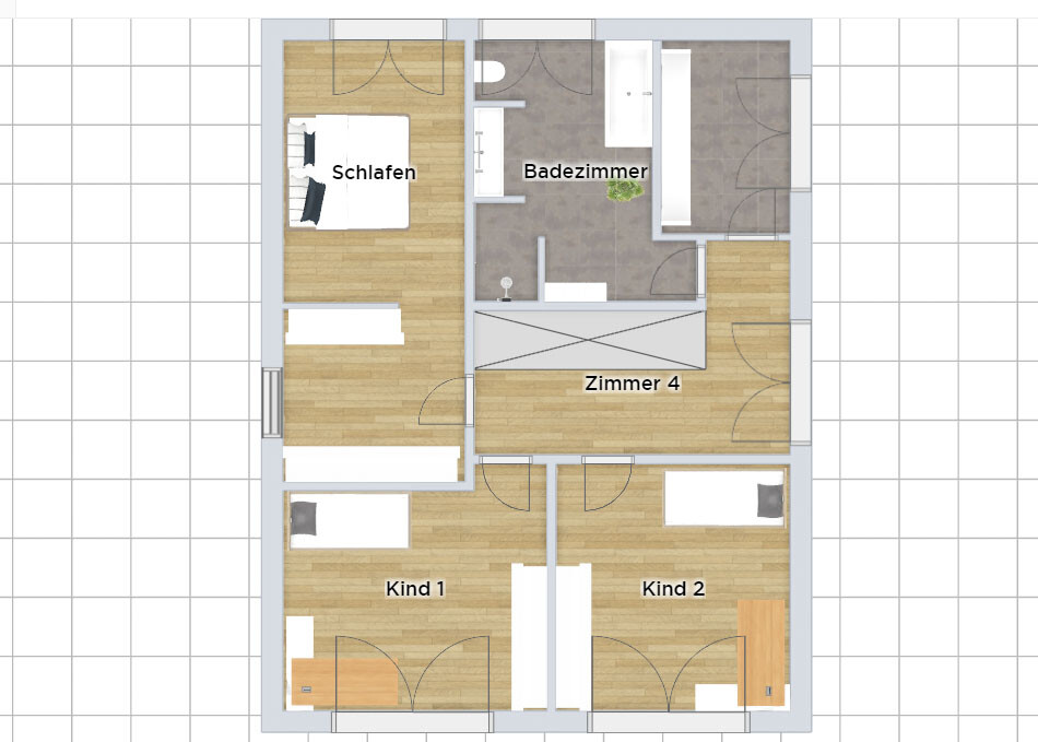

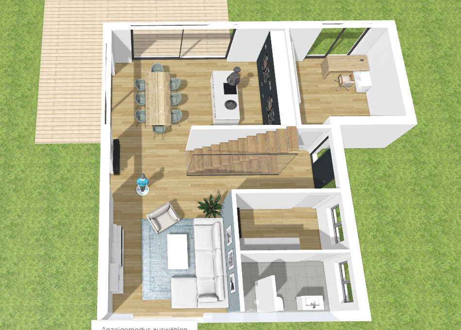

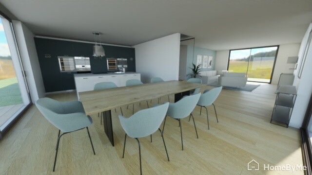

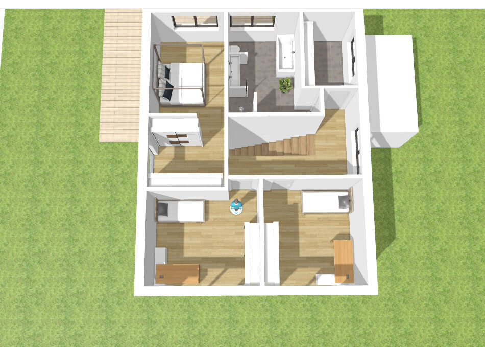

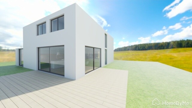

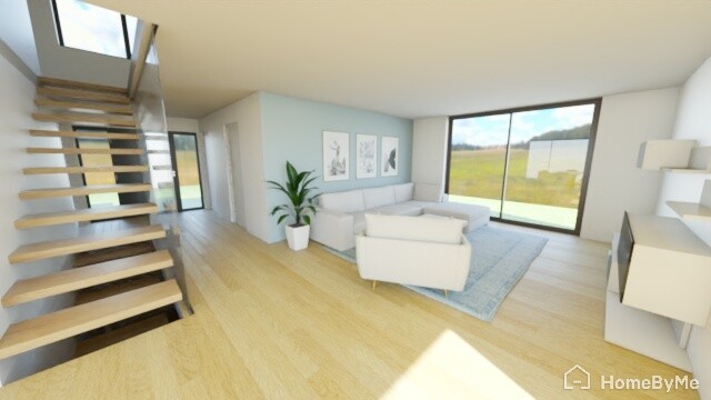

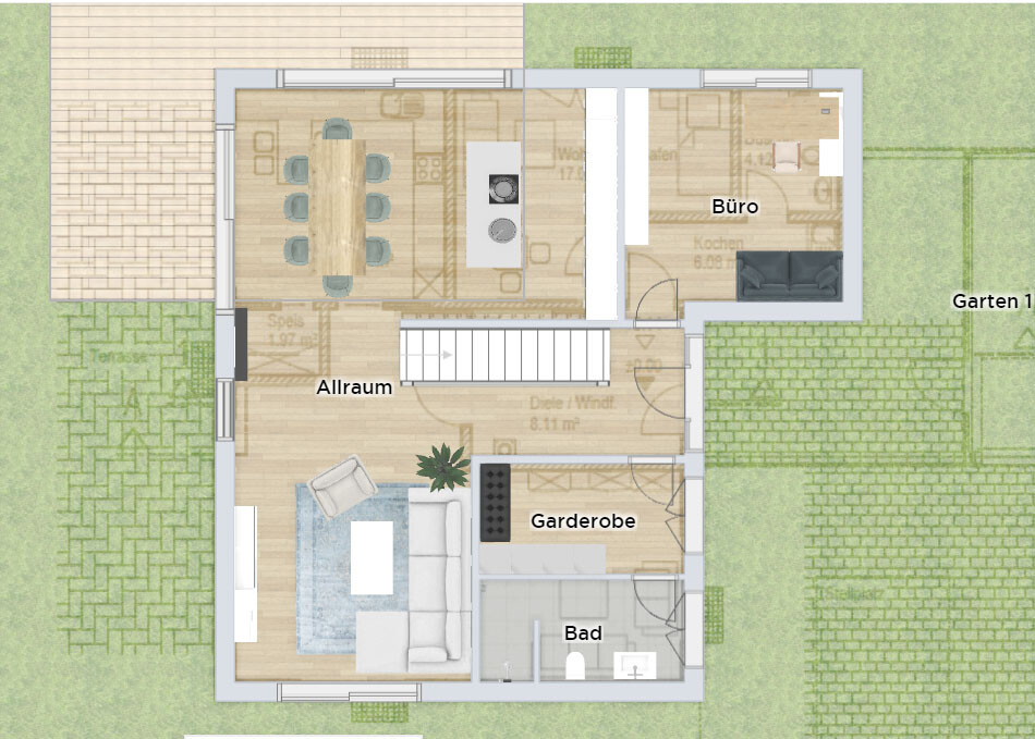

I tried out Homebyme again over the rainy weekend. @ypg, everything works perfectly for me! Here’s an idea if you want to use the ground floor just for yourself later on and don’t need a separate apartment. The kitchen faces the garden, as does the office. There’s space for a large dining table and you get plenty of light from the south. Includes a glass staircase. Unfortunately, the program can’t create a roof, or I just can’t figure it out. So, it looks like a flat-roofed house 😉
I like the sense of space in the design. The 3D renderings really make a great impression. However, the original poster wants a traditional kitchen with a separate seating area… The entrance should be separated from the living area, and the staircase probably won’t be located near the sofa.
Certainly, the design is influenced by what I personally like. 😉 Of course, the staircase could also be closed off with a wall and a door installed leading to the living room.
I have the living and dining areas in one room, with the kitchen a little further away around the corner. This was due to the view of the garden, which is much more important to me from the living and dining areas than from the kitchen. We’re not really the type to spend a long time cooking. Instead, I often sit on the sofa, rarely to watch TV but rather to chat or read. In principle, I would prefer a (slightly) separate living room and a combined kitchen and dining area. If I were to build on a plot with a nice large garden on two sides instead of just one, that’s how I would design it. One can always dream 😀
