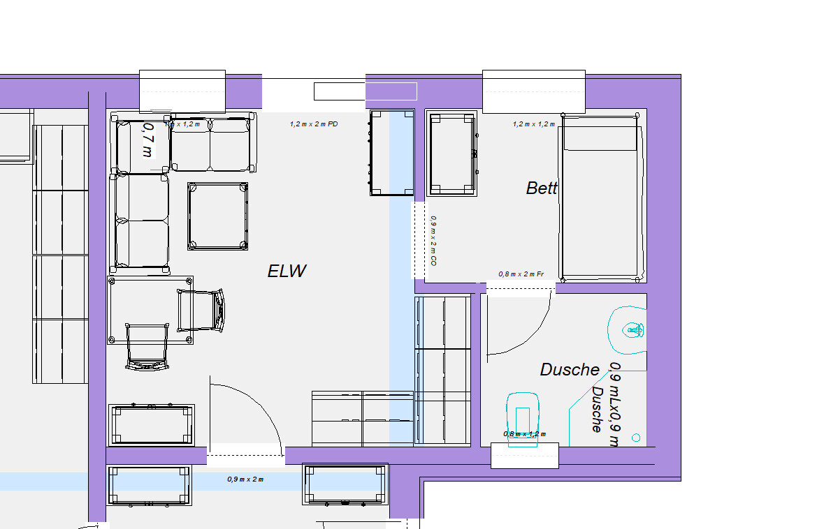

The ground floor is planned to include a second residential unit, but this will not be built initially (possibly later for our parents).

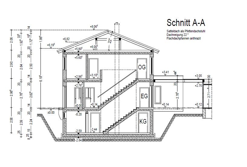

xanthippa18 Aug 2022 15:31Würfel* schrieb:

Myrna_Loy18 Aug 2022 15:37I don’t think the floor plan is that bad either. Regarding the stairs, we’re probably talking about adjusting maybe one step. 18.5 cm (7.3 inches) isn’t exactly a ladder. Please keep things in perspective.
And about the separate apartment: if my parents needed help, I wouldn’t worry about the guest bathroom for a few years. Or the cloakroom. As a family, you can live a bit closer together for a few years.

I don’t think the floor plan is that bad. Regarding the stairs, we’re probably just talking about adjusting one step. 18.5 cm (7¼ inches) is not exactly a ladder. Please keep things realistic.
And about the basement apartment: if my parents needed help, I would gladly give up the guest bathroom for a few years. And the cloakroom as well. Families can live a little closer together for some years. With 15 steps and 3 m (9 ft 10 in), you don’t get 18.5 cm (7¼ inches). That’s just basic math. What am I missing here?

The basement apartment is just one part of the floor plan. That includes our office and guest bathroom. And you’re paying a lot for every centimeter.

Myrna_Loy18 Aug 2022 15:56I would arrange the layout of the granny flat differently. I would place the kitchen as a single long row along the wall facing the kitchen area and organize the dining, living, and cooking areas within the room, creating a small additional bedroom. Otherwise, it feels very much like a nursing home room. There is, of course, no storage space, so it would truly only serve as emergency accommodation for special situations, as the space is not really suitable for care or a longer stay of a mobile person.
