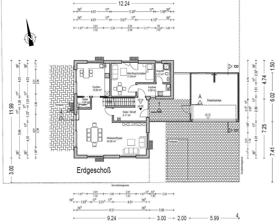

xanthippa12 Aug 2022 00:10Hello dear forum members,
We are about to start the detailed planning phase for our new house.
When we planned the house last year, we were unable to focus much on the floor plan due to our two small children.
Now that the detailed planning is approaching, we are wondering if and what improvements we could still make to the floor plan.
Therefore, we would like to share our house floor plan for discussion and ask for tips and advice.
The building permit / planning permission has been applied for. Fortunately, we still received confirmation for KFW funding. However, this means we should not change the dimensions of the exterior walls anymore, as otherwise there is a risk of losing the funding.
The ground floor is planned to include a second residential unit, but this will not be built initially (possibly later for our parents).
Since the storage room does not have a window, we want to omit it to create a more spacious feel at the stairway leading to the upper floor. Instead, tall cabinets with pull-out drawers will be placed on the wall between the kitchen and dining area. We might also separate the kitchen with double sliding glass doors.
The kitchen is planned in the upper left area because that is where the main access to the terrace is intended (west/north around the corner of the house).

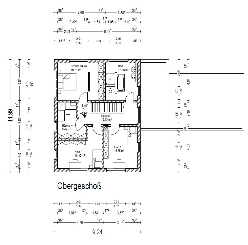

How long is the staircase? It seems a bit short to me, but that might be deceptive. Please provide the exact measurements of the steps (since they are hard to read), the floor-to-floor height, and the size of the stairwell opening you have planned. Then the staircase can be evaluated more accurately.

Sorry to put it so bluntly, but the layout completely lacks a connection to the garden. Even though that’s the north side, you have no direct access from the living areas. If the children want to play in the sandbox, everyone has to go through the office or the guest corridor. Or you have to walk all the way around the house first – how inconvenient. This will lead to constant running around the house.
At the moment, the staircase orientation, entrance area, etc., are still designed to accommodate a second separate living unit. Is this still relevant, or is it just being forced now because of the subsidy? How much is the subsidy, and is it really worth it if it’s not needed and causes the floor plan to suffer?

How long is the staircase? It seems a bit short to me, but that might be misleading. Please provide the exact dimensions of the steps (because they are hard to read), the floor-to-floor height, and the size of the stairwell opening planned. Then the staircase can be evaluated accurately.Hello hanse987, there are 15 steps at 26 cm (10 inches) each (the plan shows 16 steps, not sure how that was measured). The staircase is 3.9 m (12.8 ft) long (measured on the ground floor plan from the small circle to the end of the arrow). The staircase is exactly 1 m (3.3 ft) wide. The floor-to-floor height from ground floor to first floor in the shell construction is 2.75 m (9 ft).
What is the best way to measure the stairwell opening? Should I measure it on the first floor floor plan?
