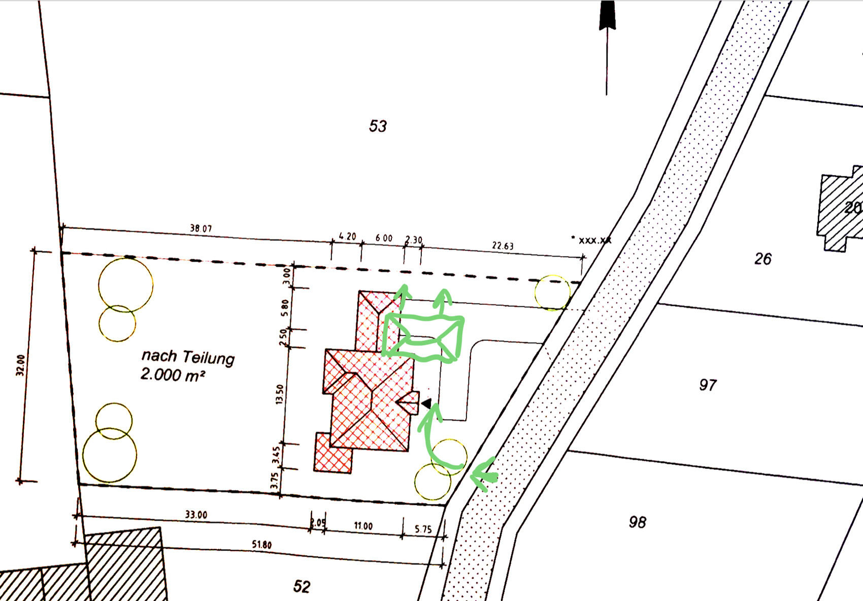

If necessary, have the driveway altered approximately like this
Site plan: Plot 53 with red building, marked in green, road on the right, yellow trees.

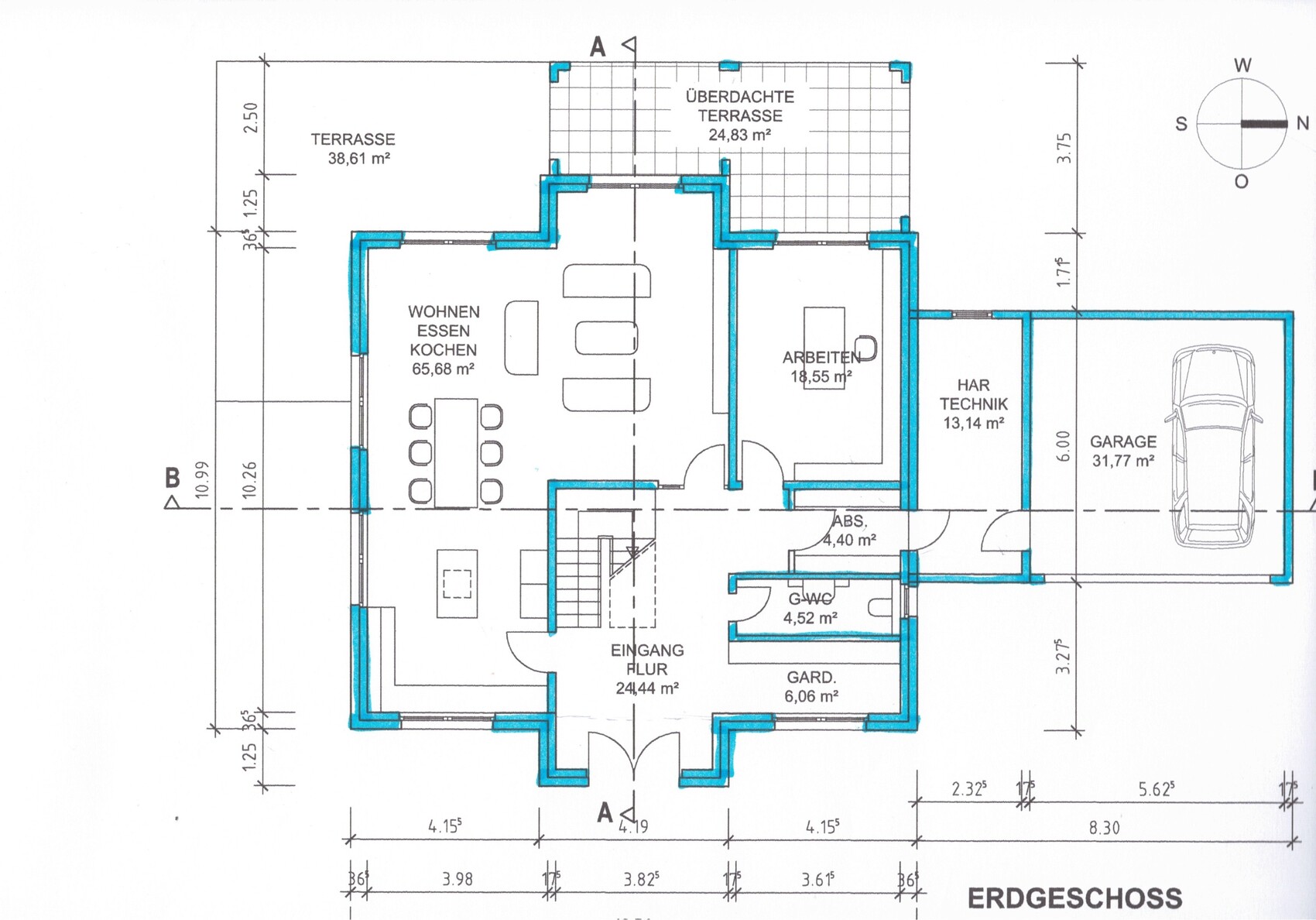

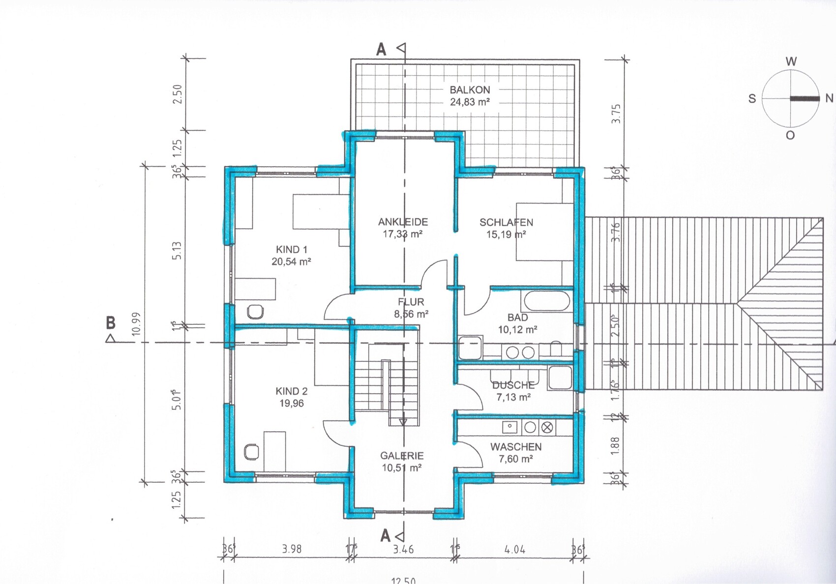

Thank you again for your feedback. The architect has revised the plans. This is the new design. We had previously communicated the following requests to the architect:
  • Kitchen facing the street
  • Symmetrical windows on the street side
  • Access to the home office through the hallway instead of the living area
  • Storage room serving as a passage from the garage into the house
  • Two children's bedrooms facing south or west
  • Covered terrace with a small outdoor kitchen
Ground floor plan with terrace, garage and living area.
The wall between the gallery and hallway will be replaced by a simple stair railing in the next draft.
Upper floor plan of a house with balcony, bedroom and children's rooms.

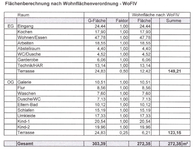

Table showing area calculation according to WoFIV with ground and upper floor rooms plus totals.
I personally like the design quite a lot. However, I am still uncertain about the following points:
  • The architect still believes the utility room should be located outside the thermal envelope. He considers it unnecessary cost and mentioned he discussed this again with an energy consultant.
  • The architect recommends including an entrance vestibule. However, I think modern houses don’t really need a vestibule.
  • Upstairs, I am unsure whether the children's bathroom and laundry room provide enough space. Maybe a single larger bathroom instead of separate parents’ and children’s bathrooms?
  • On the ground floor, this design has a ceiling height of 256 cm (100.8 inches). For aesthetic reasons, I would prefer a bit more—around 270 cm (106.3 inches). The architect says 256 cm (100.8 inches) is sufficient, otherwise the staircase would become somewhat steeper. Perhaps only a 3D visualization can help decide this?
  • The garage might be made slightly larger to allow space for a small workbench.
12 May 2023 19:08
metin88 schrieb:
The architect recommends including a windbreak area.
Strange. You're right.
metin88 schrieb:
The architect also believes that the technical room should not be inside the thermal envelope.
Hmm… okay… how old is the architect?
metin88 schrieb:
The architect says 256 cm (8 ft 5 in) is sufficient, otherwise the staircase would become somewhat steeper.
Or you would need to extend it by 1 or 2 steps.
The master suite on the upper floor is completely poorly planned. The bedroom acts as a passageway between the dressing room and the bathroom: it can hardly be more disruptive for someone sleeping.
First of all, if I were you, I would draw your intended furniture to scale so that any tight spots in the open-plan area become clear. I feel the grid for a quick overview is missing.
Also, I don’t find the narrow areas in the northeast very appealing. To change those and keep the symmetry, I would split the windows on the east side and then swap the WC and the wardrobe. The WC can handle the narrow space, but the wardrobe, where you need room to move by the cabinets, is unsuitable.
Your planned outdoor kitchen has no connection at all to the kitchen inside. That’s completely counterproductive. It’s even the furthest room away—you’d have to carry ingredients across the open area and past the lounge zone. Are you sure you want it like that?
