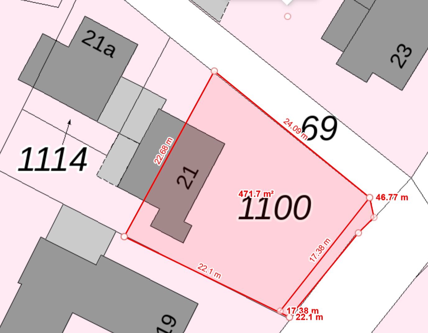

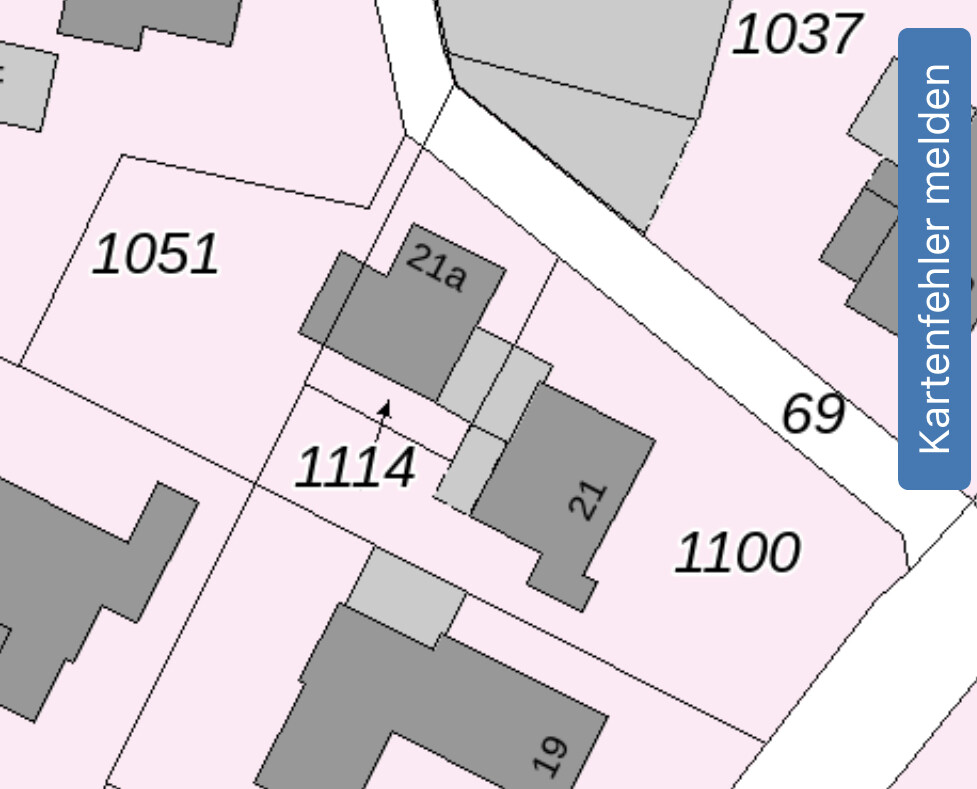

Until now, I have only been a silent reader. Our project is becoming more real, and I would appreciate including your ideas and suggestions in the planning phase.
Unfortunately, both my grandparents have passed away, and their house is now vacant. Directly adjacent is my parents’ house. In total, the plot measures 722m² (7,774 sq ft) and is owned one-third each by my father and my two aunts. We can buy the aunts’ third and a portion of my father’s land, so we end up with about 470-500m² (5,060-5,382 sq ft).
My father is taking part of his inheritance and straightening out the boundaries. I’ve attached a screenshot from Tim-Online to illustrate how it looks.
No. 21a is my parents’ house, No. 21 will be demolished. Number 69 is a small private road, owned 50% by my father and 50% by a neighbor. We are currently talking to him about a possible building encumbrance (building easement).
I will try to answer all questions below and continue from there 🙂
Plot size: 470-500m² (5,060-5,382 sq ft)
Slope: slight incline. Surveying is still pending. Over the length of 24m (79 feet), it drops less than 1m (3 feet). So the private road slopes down toward the street.
Site coverage ratio: unknown, §34
Floor area ratio: unknown, §34
Building envelope, building line and boundary: unknown, §34; we must keep about 6m (20 feet) distance from the road on the south/east side

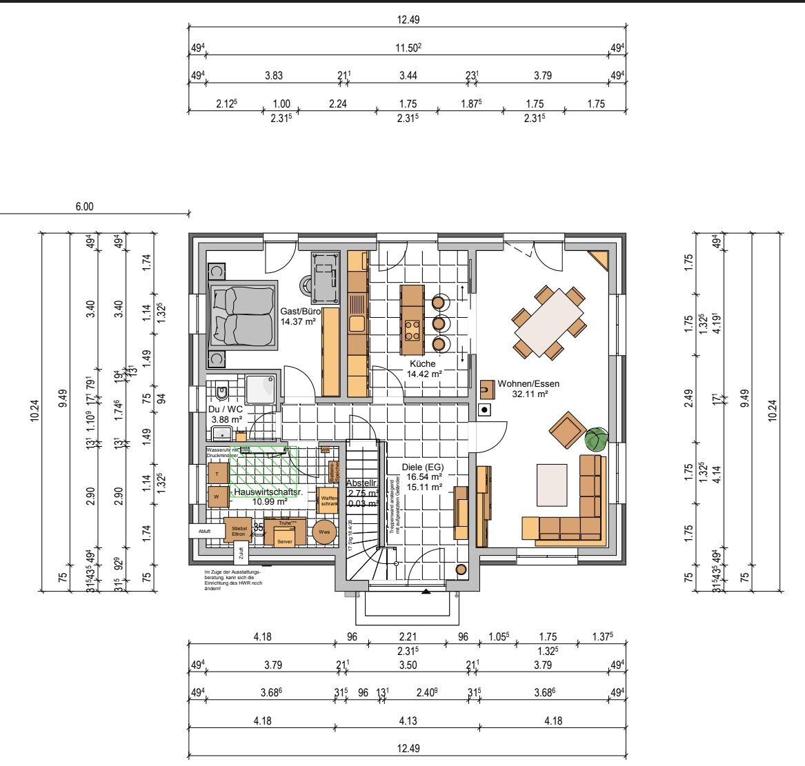

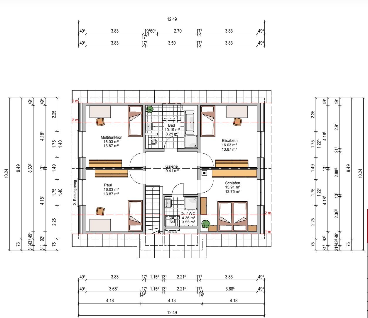

Who designed the plan:
Do-it-yourself, drawn by a house salesperson

What is the most important/basic question about the floor plan summed up in 130 characters?
The most important question to me right now is: How would you place the house on the plot? There is a fixed 6m (20 feet) setback on the street side at the bottom. According to the building authority, we could try 5m (16 feet), but I don’t want to risk a delay.

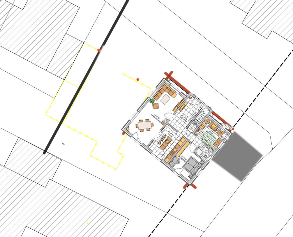

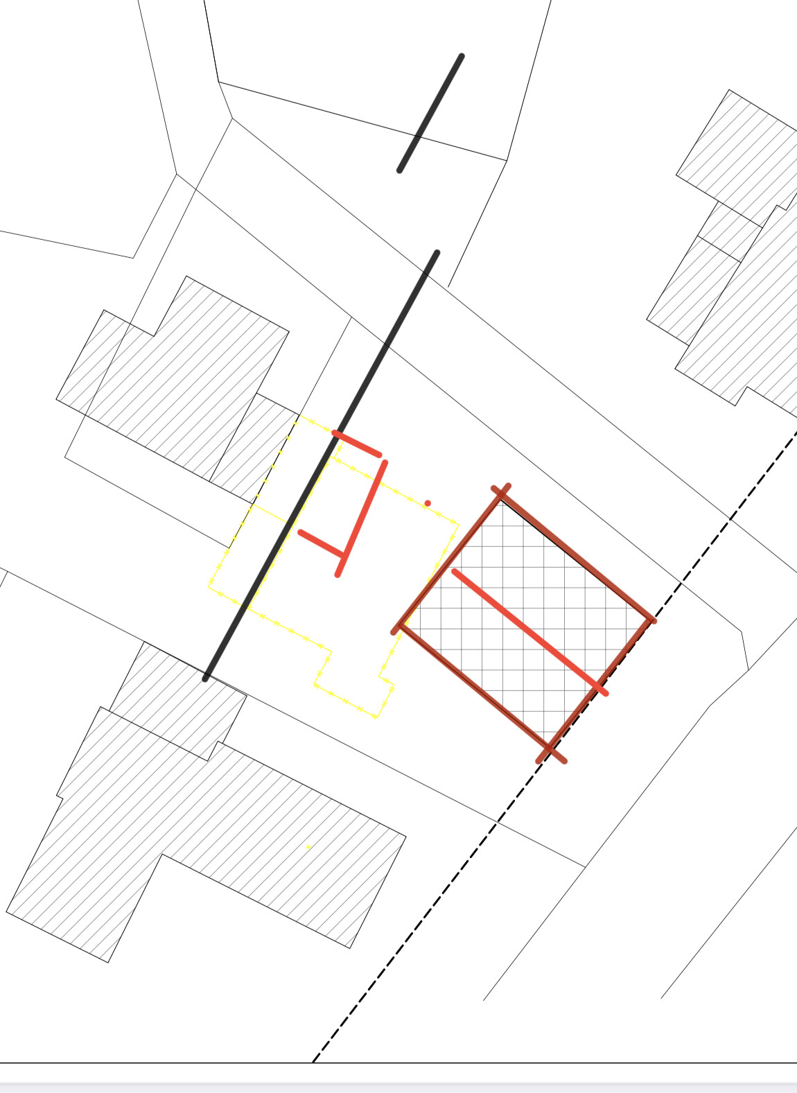

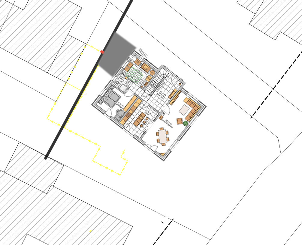

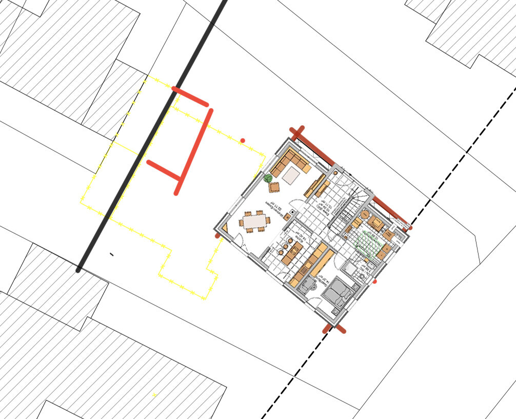

By placing the garage/carport here, you disrupt your west-facing garden and end up with a fragmented outdoor space.
I would rather position a double garage/carport on the east side, adjacent to the utility room. This way, you get a nice, continuous garden.
Alternatively, place the house in the northwest corner and the garden towards the southeast, with a trapezoidal garage/carport. The floor plan would be mirrored.
It’s a matter of preference whether you want the house to face the street or your parents’ property. I would probably choose option 3. I think this gives you the most sunlight and the largest garden space if you only build a single garage.
BimBamBaba1 Jul 2022 11:22Würfel* schrieb:
By placing the garage/carport there, you end up dividing your west-facing garden, resulting in a fragmented outdoor space.
[ATTACH alt="1656407814388.png"]72965[/ATTACH]
I would rather position a double garage/carport on the east side, attached to the utility room, so you get a nice, continuous garden area.
[ATTACH alt="grundriss-efh-ca-190m-und-platzierung-auf-Grundstück-582601-1.png"]72966[/ATTACH]
Alternatively, put the house in the northwest corner with the garden facing southeast, and use a trapezoidal garage/carport. The floor plan would be mirrored.
It’s a matter of preference whether the front should face the street or toward the parents... I’d probably choose option 3. I think you get the most sunlight and the biggest garden area that way, especially if you only build a single garage.
[ATTACH alt="grundriss-efh-ca-190m-und-platzierung-auf-Grundstück-582601-2.png"]72967[/ATTACH] Thanks for the advice. Unfortunately, we can’t place the garage on the east side because we have to keep the 6m (20 feet) distance from the street to maintain a uniform appearance. Option 3 does indeed create the best and largest garden area.
A south/east-facing garden will get morning and daytime sun, and then shade in the evening, right? Although there is also space in the west for an “evening sun terrace.”
BimBamBaba1 Jul 2022 11:24K a t j a schrieb:
I also think a discussion about the floor plan is premature. First, clarify the division and determine the buildable area. A preliminary building inquiry might be useful.I have consulted with the authorities, and we don't need to worry about the floor area ratio. The neighbors have all built relatively generously since the area is mixed-use, combining residential and commercial. So we are on the safe side.BimBamBaba schrieb:
Option 3 really creates the largest and best garden space.
A south/east-facing garden would get morning and daytime sun, and then shade in the evening, right? If you build a double garage there and change the floor plan, for example where the guest room is in Cube 3’s option now, to the kitchen, you would have a wonderful courtyard area that promises cozy evenings.
BimBamBaba schrieb:
South/East garden then means sun in the morning and during the day, and shade in the evening, right?
Although there is still space in the west for an "evening sun terrace." In the south garden, you also get western sun if there’s no building in the way (which should be the case for you), and you can always add an evening sun terrace as well. Once you live there and the house is built, you can see exactly where the sun shines the longest and where it makes sense to create that extra seating area. On hot days, a terrace on the east side in the afternoon is very pleasant because no umbrella or sunshade provides as "cool" a shade as the house itself.
