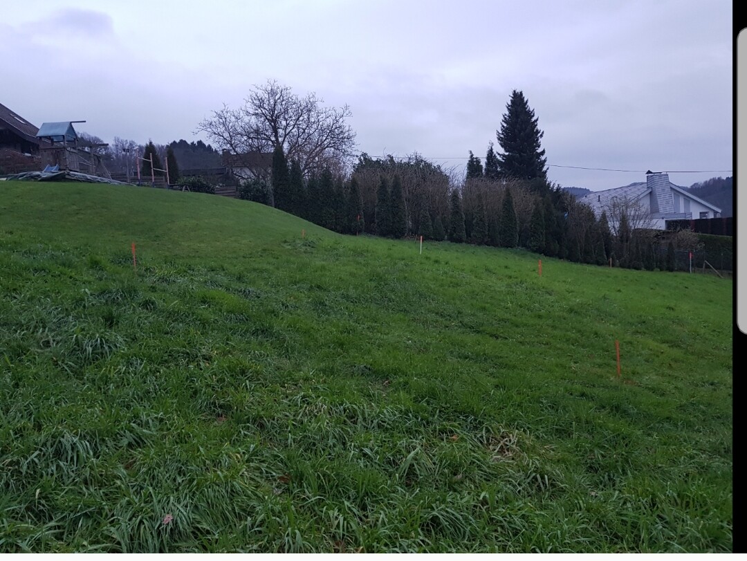

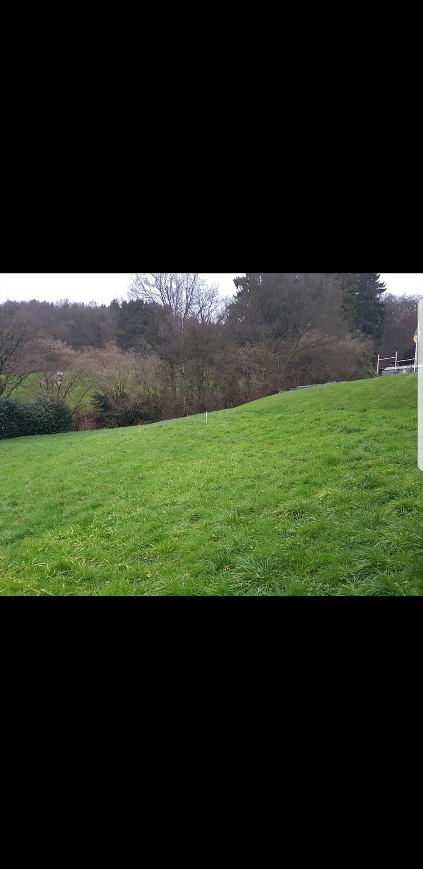

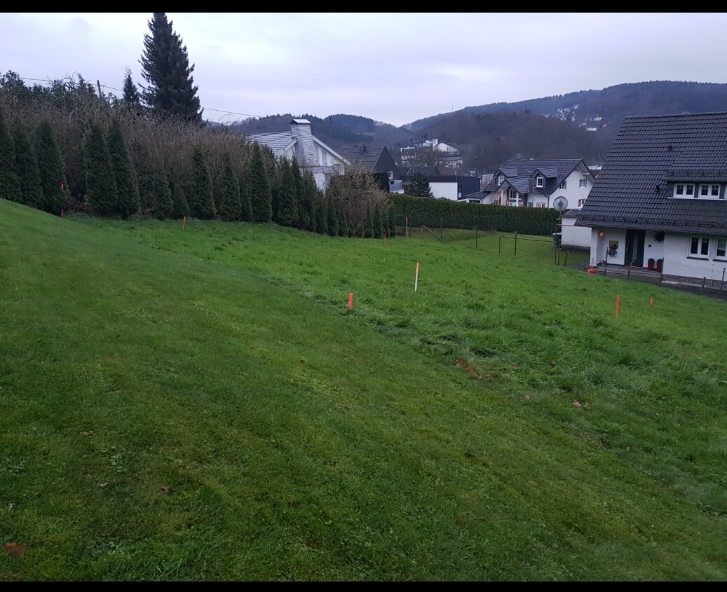

Marco058116 Apr 2018 12:44Yes, dear all, because of the slope, it is possible to step directly from the balcony onto the lawn. So, I would be right in the "garden." We don’t want to build a staircase there at all. I need to check if I have some photos that show the property or the slope better... but I won’t be home until tomorrow.

Marco0581 schrieb:
I need to check if I have some photos that show the plot or the slope more clearly... That would be very helpful. While a split-level design can work wonderfully when the ground height front to back differs by half a story, it fits much less well when the difference is a whole story.
Marco0581 schrieb:
That's true And unfortunately, it’s obvious at first glance.
Marco058117 Apr 2018 15:44I hope the slope of the site is somewhat visible in the photos... I can only manage everything on my mobile right now.
