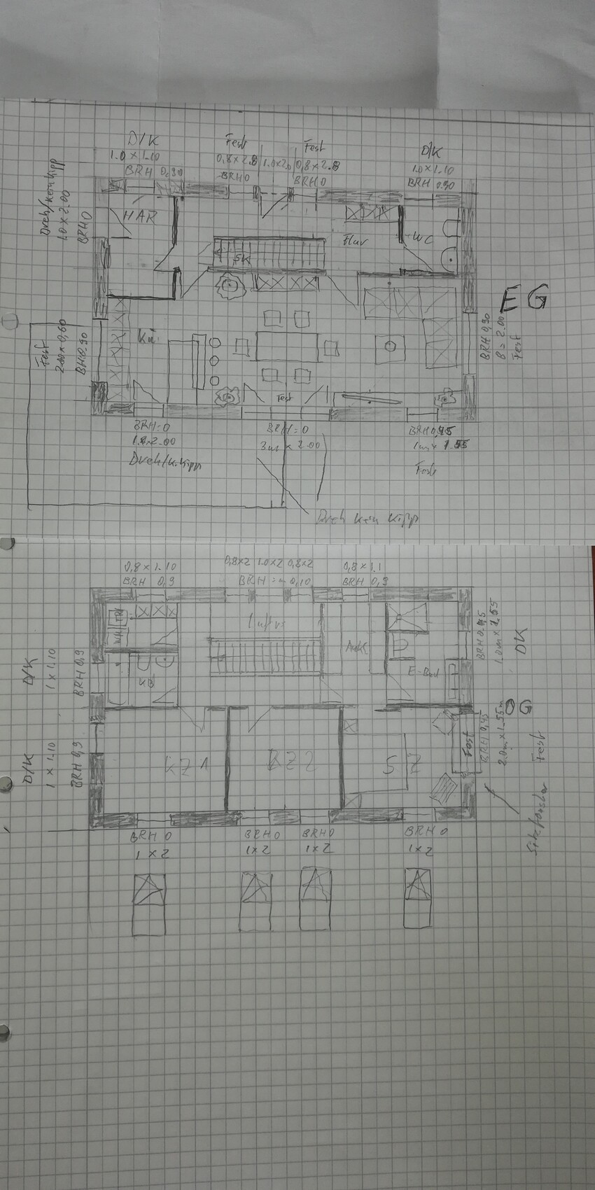

Here is another modification.

[ATTACH alt="Grundrisse 21.jpg"]58994[/ATTACH]
Does this house already exist in this form, or is it a design?

Windows yet to be specified.
Hand-drawn two-story floor plan of a house on graph paper, two levels.
Would you bother doing this if the floor plan already exists?
Now you can enter it into your software.

18 Mar 2021 12:16
The window in the utility room can still be moved 1 m (3 feet) further south.
