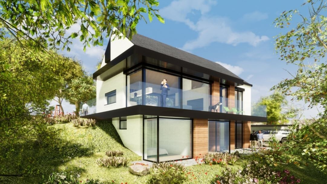

hanghaus200021 May 2021 19:30hanghaus2000 schrieb:
My hillside house. If I can get a suitable plot. This is the open-plan living area upstairs.
[ATTACH alt="Beispiel1.JPG"]61633[/ATTACH]Yes, there are also nice open-plan living areas on the upper floor... it always depends on how it is designed and the conditions.hanghaus2000 schrieb:

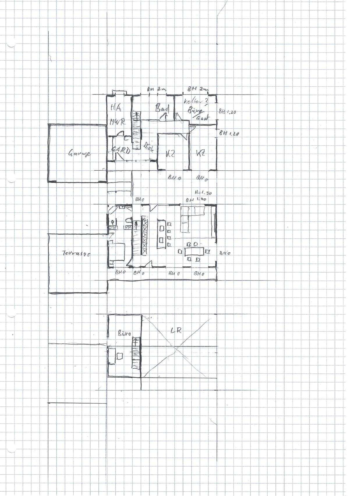

this is how I would have positioned itSo you mean placing the carport directly by the street? Yes, that way you can make good use of the available width. The dormer is bothersome and takes up valuable space in the house. Then it doesn’t have to be such a deep bulky structure.H

hanghaus200022 May 2021 09:40ypg schrieb:
So you mean a carport directly next to the street? Yes, that way you can make good use of the available width. The DoGa is annoying and takes up valuable space for the house. Then it also doesn't have to be such a deep bulky structure. It’s also about the height at the property boundary. The average height is only allowed to be 3 m (10 feet). That only works if you create the garage driveway with a very steep slope toward the garage. I wouldn’t want that.
