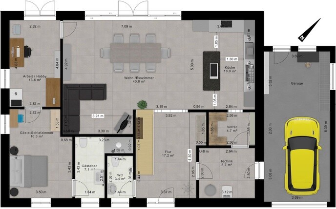

My wife and I are currently favoring the attached design for our house project. It is our own concept, inspired by forum discussions, catalogs, and model homes, but also discussed with architects and now unrecognizable compared to the first drafts.
A first detailed drawing is in progress (which may include structural and building services adjustments), so general criticism is welcome, but especially suggestions on potential problem areas or ways to achieve essential improvements through small changes: After all, we don’t want to build an expensive house only to regret it later, but rather invest in meaningful improvements (e.g., bay windows). At the bottom, I have listed some specific concerns.

Ground floor details:
- Living room with window fronts each with a door leading to terraces in the southwest (for sunlight) and northwest (toward the garden).
- Kitchen open to the living area; appliances located in a central niche—therefore, to minimize noise, the oven/microwave are there instead of the refrigerator.
- Room behind kitchen (separated by a slightly hidden door) serves as storage and a place for some kitchen appliances and an additional worktop.
- From the hallway, a doorless passage to the living room, doors to guest room, guest toilet, and utility room, also from there access to the garage.
- Large guest room with barrier-free bathroom and external access, potentially a one-room separate apartment.
- Garage for one car, e-scooter/bicycles and as a workshop/storage room, for example for garden tools.

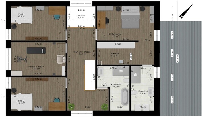

Upper floor details:
- Children’s rooms on the sunnier gable side.
- Children’s bathroom with bathtub, master bathroom with washing machine/dryer (but space in utility room to allow for changes).
- Long dormers above bathrooms/stairwell and fitness/hobby room; no other roof windows.
- Access to attic via fitness/hobby room.

- The (currently half-landing) staircase may need to be spiral to allow doors to fit under its end. Is preserving the half-landing for climbing safety worth a bay window?
- Prefabricated houses often have bay windows, although they might be energetically disadvantageous. Are they mainly for aesthetics, or have we missed practical opportunities by not including any?
- Is the staircase too close to the entrance, e.g., regarding dirt distribution?
- We would like remote/central control for roller shutters on all burglary-relevant windows. Would narrow windows be acceptable in the utility room, guest bathroom, and ground floor toilet, to prevent break-ins? Does anyone have experience with this?
- With a 25° pitch and 1.20m (3 ft 11 in) knee wall, is an overhanging roof suitable as a cover for the entrance and/or terrace without causing too much shading? What other canopy options would make sense, especially since the terrace is on the exposure-prone side?
- To prevent bicycles from scratching the car in the garage, should it be widened? This would reduce the remaining strip on the southwest side, where the tightest boundary distance (at the west corner, “top left”) is currently about 5m (16 ft 5 in).
- Is a TV placed directly next to the window front a problem due to the northwest orientation?
- Should the pantry behind the kitchen have a second sink?
- Would it be better to fill the garden-facing dormer entirely with windows rather than leaving corners open as planned?
- Which windows should be included in the bathroom dormer considering there are houses on the opposite side of the street?

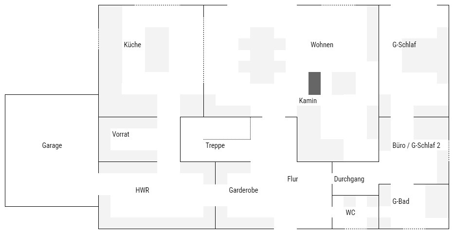

kbt09 schrieb:
If the staircase should have a landing, what does your dimension of 420 cm (165 inches) then mean? 419 cm (165 inches) is already the length of a straight, comfortably climbable staircase.
The straight staircase would then end right at the exterior wall—I’d prefer a landing to change direction shortly beforehand. But probably a spiral or helical staircase would be better suited in this design anyway, especially to allow headroom under the HVAC room door.

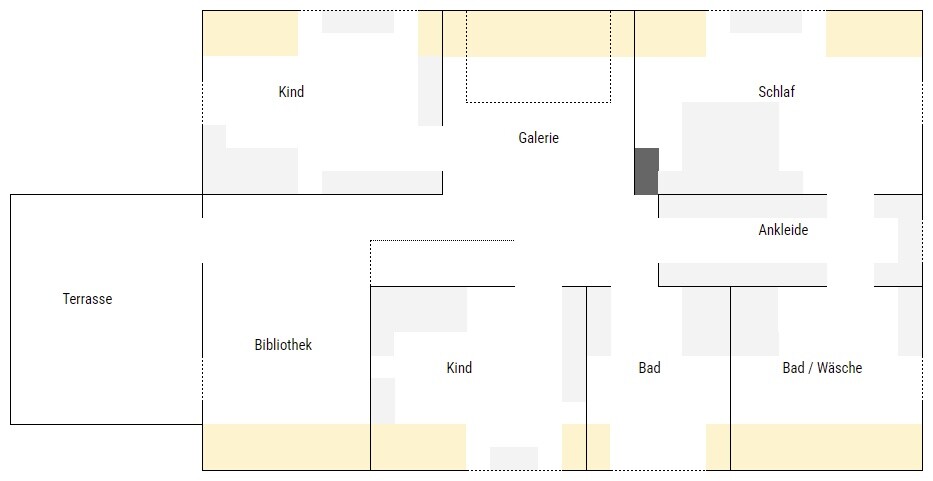

I notice you hardly accept any criticism. Only the suggestion to swap kitchen and living room… but even that advice wasn’t meant to be applied to your drawn floor plan, rather to be considered from the start in a new design.
Well, I see at least four kinds of criticism here:
- Points about functionally disadvantageous situations in the house’s use, like discomfort on the sofa or darkness in the morning. These two specific points made sense to me and can also be solved without a complete redesign.
- Comments about general inefficiency, which is probably true, but I can reassure myself by thinking “who knows what that square meter will be good for later.” (With the limitation mentioned above, since more space can also mean downsides.)
- Comments about supposedly wrong priorities, which cannot really be objective even if 90% of architects agree. For example, the hobby room can also serve as a playroom, so I don’t see a harmful undersizing of the children’s rooms. Also, the children get their sunlight mostly in the garden, which has room for a small soccer field, as the house is positioned like a barrier.
- Fundamental rejection of the whole approach as something to discard, etc.—here I wonder whether it’s just a matter of taste or stylistic dogma (“If you spend €800k, don’t build a gym upstairs but something more eye-catching”), or whether drawbacks from the first two categories are really present. (See your vague comment that the house “does not work.”) Much remains unsaid here, as it is apparently “not worth it” or I’m not to be encouraged to keep tweaking the existing design.

First of all, I want to congratulate you for not sulking in the corner feeling offended. Unfortunately, that is often the reaction when laypeople are told their masterpiece is inadequate. But there is a reason why architecture requires several years of study and also has licensing restrictions with aptitude tests.
This has nothing to do with us considering houses over 200 square meters (2,150 square feet) too large. (We have already had bigger houses here.) However, the higher the budget, the more absurd it becomes to attempt to cobble something together yourself that is likely to fail technically, aesthetically, and in daily use.
Apart from the "floating" wall above the garage, an uninformed general contractor will probably piece this together for you regardless. They will build any junk for you without batting an eye or offering any recommendations. As long as you pay, that’s what matters. The question is, is this what you want? If I want a new hairstyle, I go to a hairdresser. I could do it myself, but it would look accordingly. With a house, there is no second chance. Once it is built, that’s it.
Haus 42 schrieb:
The straight staircase would end directly in front of the exterior wall – so I would prefer a landing to allow for a change of direction shortly before. However, a spiral staircase might be better in this design anyway, considering the head clearance under the utility room door. My comment about the staircase was not meant to persuade you to choose a straight staircase, but rather to encourage you to consider the dimensions of the planned stairs.
Acknowledging the redesign of the living/kitchen area and the staircase issue will probably lead you to reconsider the current design more like this:
Haus 42 schrieb:
Fundamental rejection of the approach as something to discard, etc. Otherwise, it will just become a patchwork solution.
On the ground floor, it might also make sense to combine the guest bathroom and guest toilet since neither is used continuously. You could possibly create a good division so that the toilet is somewhat separated, maybe with a sliding door to the rest of the bathroom… possibly even with two entrances.
Additionally, rotating the house—if allowed by the roof ridge orientation—could be beneficial for photovoltaic system efficiency; this should be checked. It would also allow for a southeast-facing terrace in spring and a west to northwest-facing terrace more suitable for summer.
