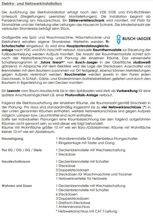

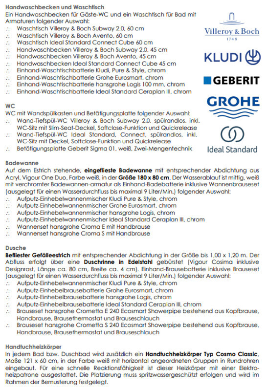

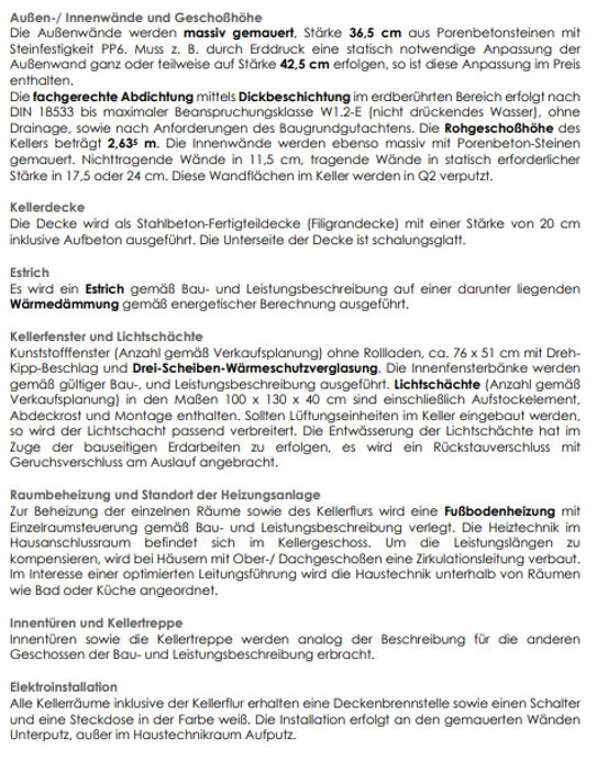

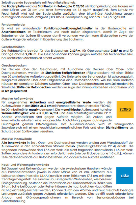

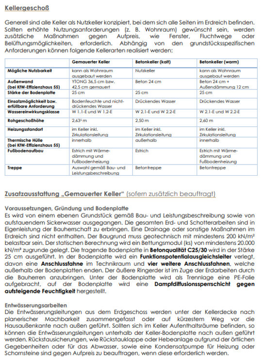

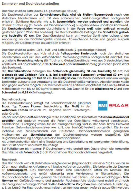

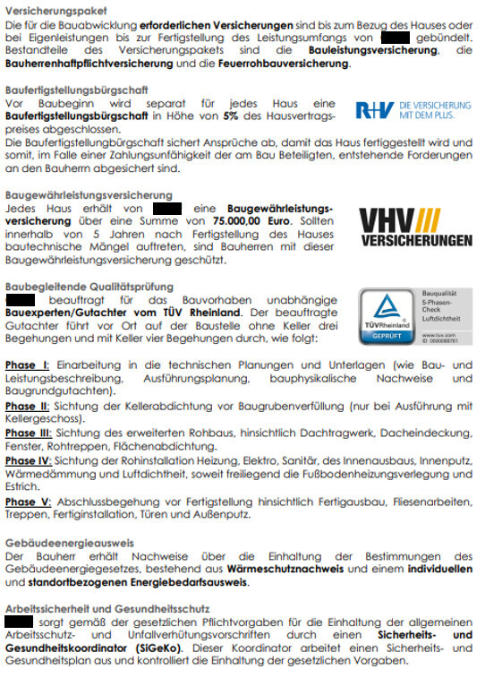

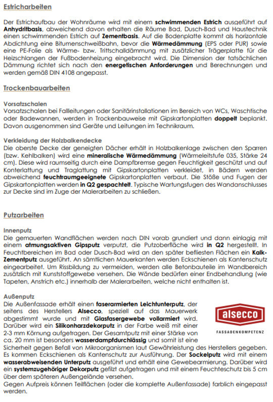

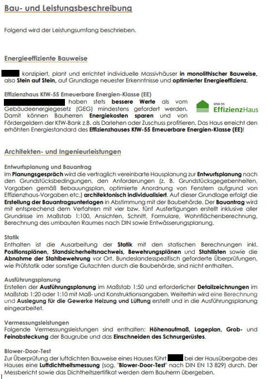

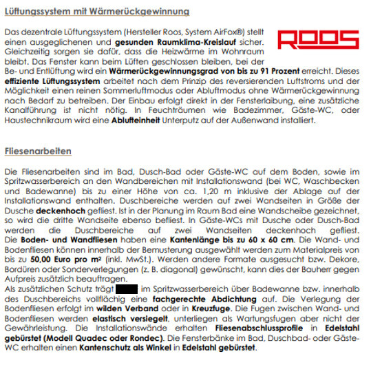

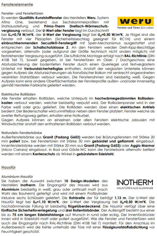

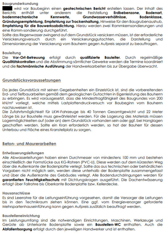

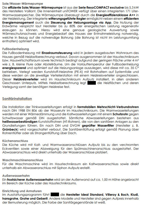

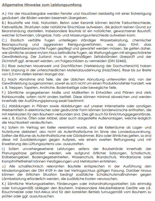

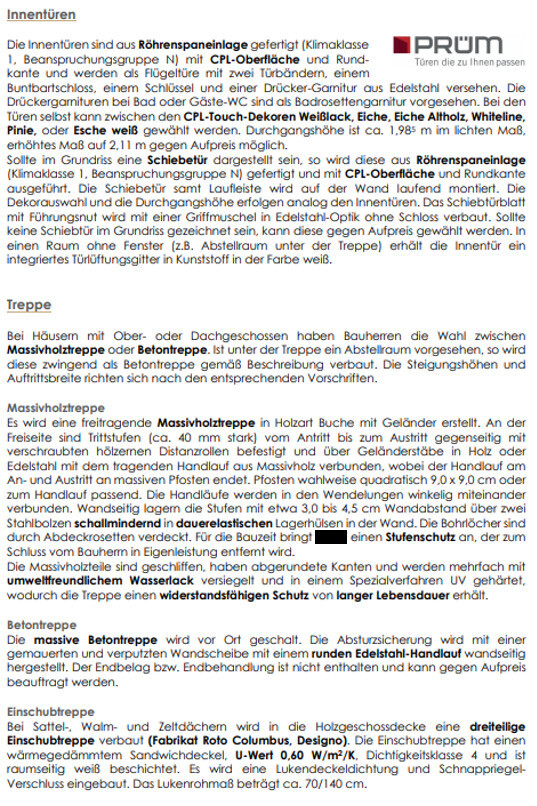

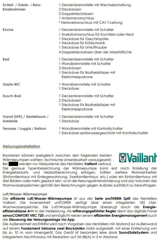

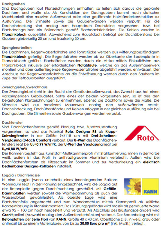

Tortuga12313 Oct 2021 16:15I’ll try the construction service description again in the next few days. There are 17 images after all, and I’m not sure if they will appear in the correct order for you.
Tortuga123 schrieb:
I'll try the construction service description again in the next few days. It just ends up being 17 pictures then.Or just provide a source—just not in link form. As I said, a reputable general contractor doesn’t make you search desperately for it on their website.https://www.instagram.com/11antgmxde/
Tortuga12313 Oct 2021 16:3711ant schrieb:
Or a source—just not revealed as a link. As I said, a recommended general contractor won’t make you desperately search for it on their website.No, there isn’t one. However, I wouldn’t make such broad statements... All the documents were sent to me by email right after the very first, five-minute phone call.
By the way, yesterday I contacted “real” homeowners via Instagram, and apart from minor issues (which surely occur with 99.9999% of all construction companies), they are satisfied with the services so far.
But as I said, we haven’t even decided whether we’ll go with that company yet. There are still other companies in the running.
