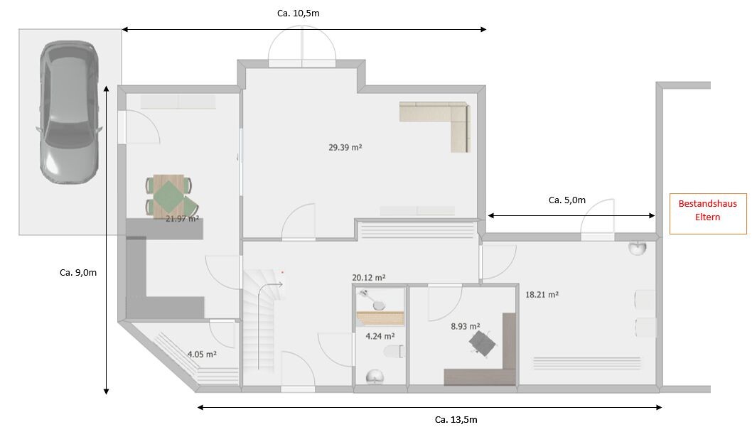

ᐅ Floor plan of a single-family home (1.5 stories, approximately 1,720 sq ft) adjacent to the existing family house of the parents
Created on: 23 Jul 2020 18:04

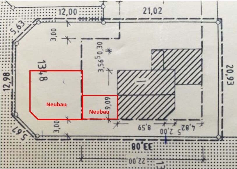

My husband and I would like to build a second house on my parents' property. The plot is 760 m² (8,180 ft²) in total and still has enough space to include a small garden. We obtained a preliminary approval from the building authority for a one-and-a-half-story single-family house with a pitched roof (that only took about six months…). To avoid using up the entire garden, we plan to attach part of the new house on the ground floor (currently the utility room) directly to my parents’ house. However, we are unsure if this is possible from a fire protection standpoint and whether we need to maintain certain distances. Ideally, we would like to keep the entire plot under my parents’ ownership and not subdivide it (it is a leasehold plot from the church with over 60 years remaining; the church will only give a statement if we submit a plan or idea of what we intend to do – which makes sense).

Building line, building window and boundary → The preliminary building approval specifies a minimum distance of 3 m (10 ft) to public traffic areas, all other zoning plan requirements must be met, and any necessary exceptions regarding the buildable area will be granted during the building permit process.

Other specifications → The angled corner of the lot is “problematic”; to maximize the use of the lot (3 m to the boundary), we would also angle the house. The existing parents’ house must also be considered (connect directly? Minimum distance? Fire protection?)

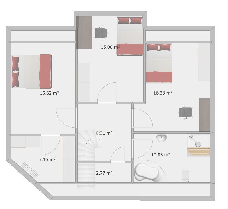

Space requirements ground floor, upper floor → Ground floor: kitchen + dining area, separate living room, utility room, office that can later be used as a bedroom, bathroom with shower (ground floor should be designed to function as an independent apartment in old age) Upper floor: 2 children’s rooms, master bedroom (preferably with a small dressing area/room), bathroom

Additional wishes / special features / daily routine, including reasons why or why not → There are many details (e.g. pantry next to the kitchen, access from kitchen to garden, utility room as a “mudroom,” office should not be next to living room because of noise, staircase not too close to the front door to allow easy entrance, etc.)
Planning by → Do-it-yourself (Roomsketcher)
What do you like particularly? Why? → Using the angled corner of the house as a pantry (otherwise, it is difficult to find a good use for “that corner”), niche for the wardrobe, large utility room (we want to hang laundry in there too; is it too big?)
What do you not like? Why? → Kitchen maybe too tight? Too much hallway on the ground floor?
Price estimate according to architect/planner → Not available yet
Personal budget for the house including equipment → 300,000 €
Favored heating system → Underfloor heating
Why is the design like it is now? → See above
What is the key fundamental question about the floor plan in 130 characters?
Is the floor plan practical for everyday use, or are there major flaws that would be annoying? Are the rooms “large” enough or perhaps too large? Does it make more sense to build completely free-standing or is the idea to attach the utility room on the ground floor to the parents’ house good?

23 Jul 2020 19:14
Alverde schrieb:
Unfortunately, we do not know if this is fire protection compliant and whether we need to maintain any other clearances.
The existing building's left side must not have any windows. Nowhere.

The left side of the existing building is not allowed to have any windows. Anywhere.
Not even on the upper floor? Replacing the regular windows with fire-rated windows is not an option either?

You can’t really make a bedroom out of 9m² (97 sq ft), or it would only fit the bed. I find the living room quite “huge,” it looks so empty, the dining area is a separate space (in front of the kitchen), and then the tiny office is squeezed into the corner.
To be honest, I don’t think the budget will cover the “unique shape” with the slanted corner and bay window.

The overall budget will not be quite sufficient.
I would clarify fire protection regulations; I’m afraid Ypg is right.
Label the rooms with measurements and always draw the existing or desired furniture to scale.
11ant24 Jul 2020 18:06
Please show much more of the property (and its location within the neighborhood). How old is the parents' house, and have you considered an extension or adding an additional floor?
In principle, attaching a second dwelling directly is not necessarily ruled out from a fire protection standpoint, but having "plenty of lawn area available" does not automatically mean that the floor space ratio allows for a second house, even without a building permit / planning permission. I am still missing a lot of information (year the parents' house was built, duration of leasehold ...).
