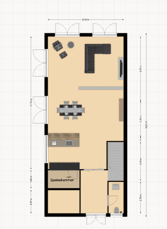

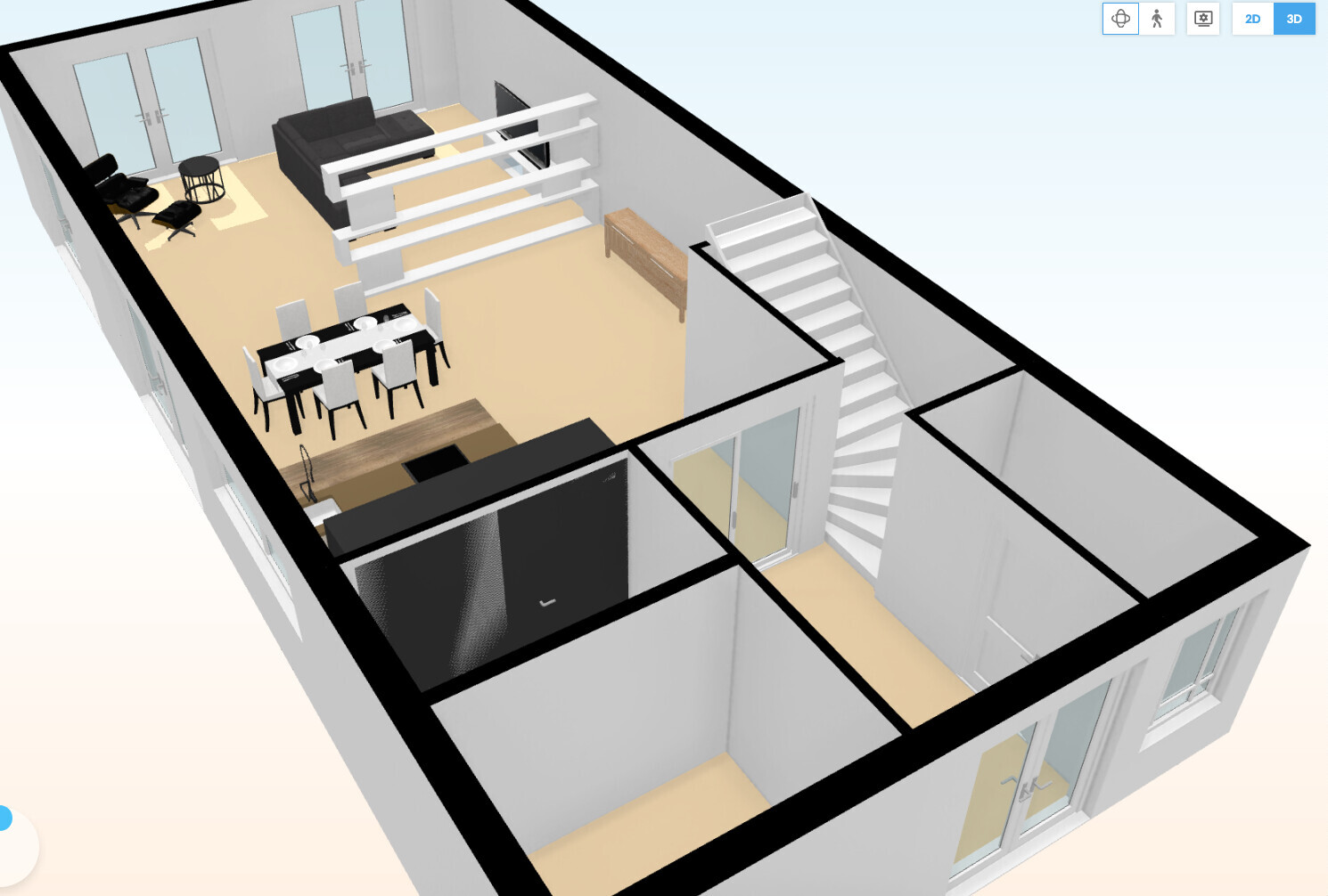

we are currently in the middle of planning the floor plan. Unfortunately, I don’t have the architect’s drawing yet, but I wanted to get your opinions already. I’m afraid the house might be too dark because of the north-facing side, so I actually want to include as many windows as possible.
Thanks in advance!

Other wishes / special features / daily routine, including reasons why certain things are desired or not: I would like everything open on the ground floor. Since we have the north side, I’m worried it will be too dark, so I try to plan windows everywhere or doors with side panels. The utility/technical room must be behind the kitchen. First floor: knee wall at 50cm (20 inches). 2 children’s bedrooms & 1 bedroom with walk-in closet. If more children come, the parents will move to the attic. I also want a laundry/utility room upstairs.

Can I plan the windows better so it stays nice and bright? And I don’t like the bathroom 100%, would appreciate tips.

I think your windows on the ground floor are sufficient. The standard is 1/10 of the room size. The windows facing east plus an additional 4–6 m² (43–65 sq ft) or 8 m² (86 sq ft) to the north, so that the center of the room is well lit, should be enough.
Having to turn on a light at your workspace in the middle of the room from around 3 p.m. or so, I experience that myself with a 4 m² (43 sq ft) south-facing window by the kitchen island.
You don’t need that. But maybe try to plan a bit more with the plot in mind, rather than rigidly sticking to old ideas. This especially applies to the living room!!! The neighbors have almost the same layout downstairs as I do. I don’t want to post the plan online now, but the living room and dining area are the same. The kitchen is right by the west-facing window. They are building with a half basement, so no problem there. The upper floor is also the same, only my bedroom is shared by two kids. The attic is also the same, just fully finished. They have four kids… plus a garage and a 3 by 3 m (10 by 10 ft) tool room attached to the house.

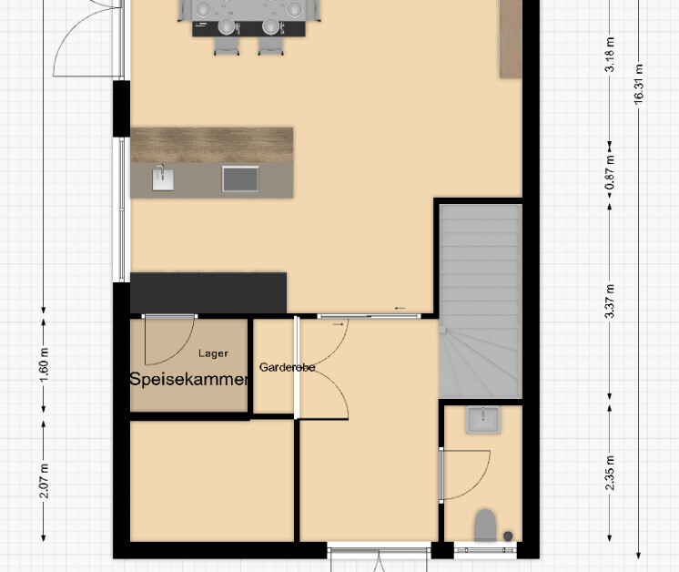

I would consider something like this: a pantry with a hidden door behind the kitchen. This way you create zones, can separate rooms, and still maintain a good flow. But isn't that exactly what you criticize (was that you?), that you can see straight through to the couch?!
I have to say again, @Marc1990, without referring to any specific quote: it seems like you treat finishing the basement as a magic solution or a way to avoid careful planning, because you still have the basement to fix any shortcomings later. I see the basement more as a curse. You’ll have about 20 square meters (215 square feet) upstairs, which should ideally be used for what it’s meant for: seasonal clothing, suitcases, sports equipment, guest blankets, leftover paint, hobby storage, and tools. You need storage space—whether you have no children, two, or three.

I would consider something like this: a pantry with a concealed door behind the kitchen. This way, you create zoning, can define rooms, and still maintain a good flow. That’s similar to my drawing... but I still have the lighting problem here.
