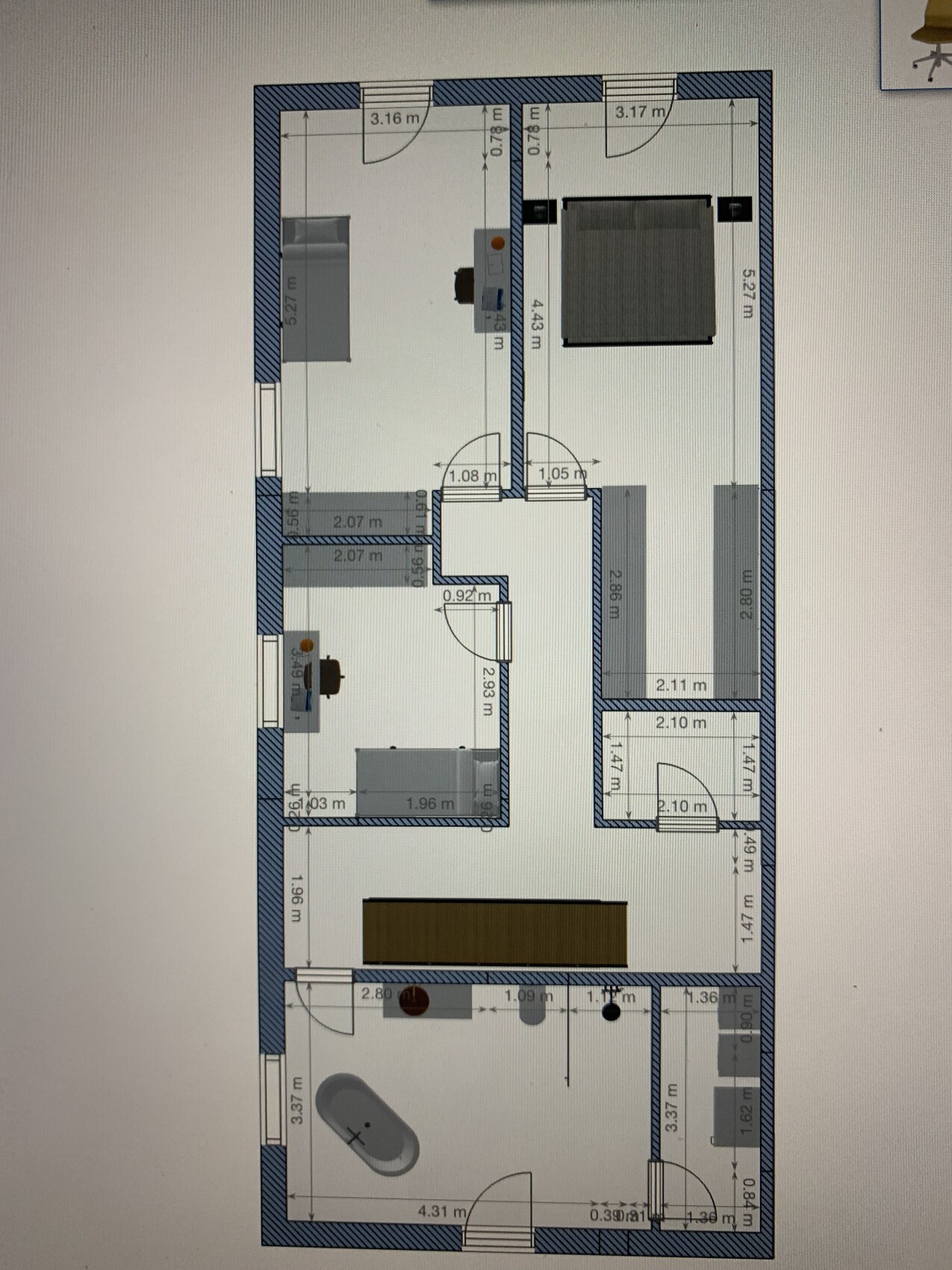

Yes, it does feel a bit like a maze… however, an open hallway with a window reduces the feeling of confinement. I would rather give up some square meters in one room to ease the general sense of discomfort when going upstairs.

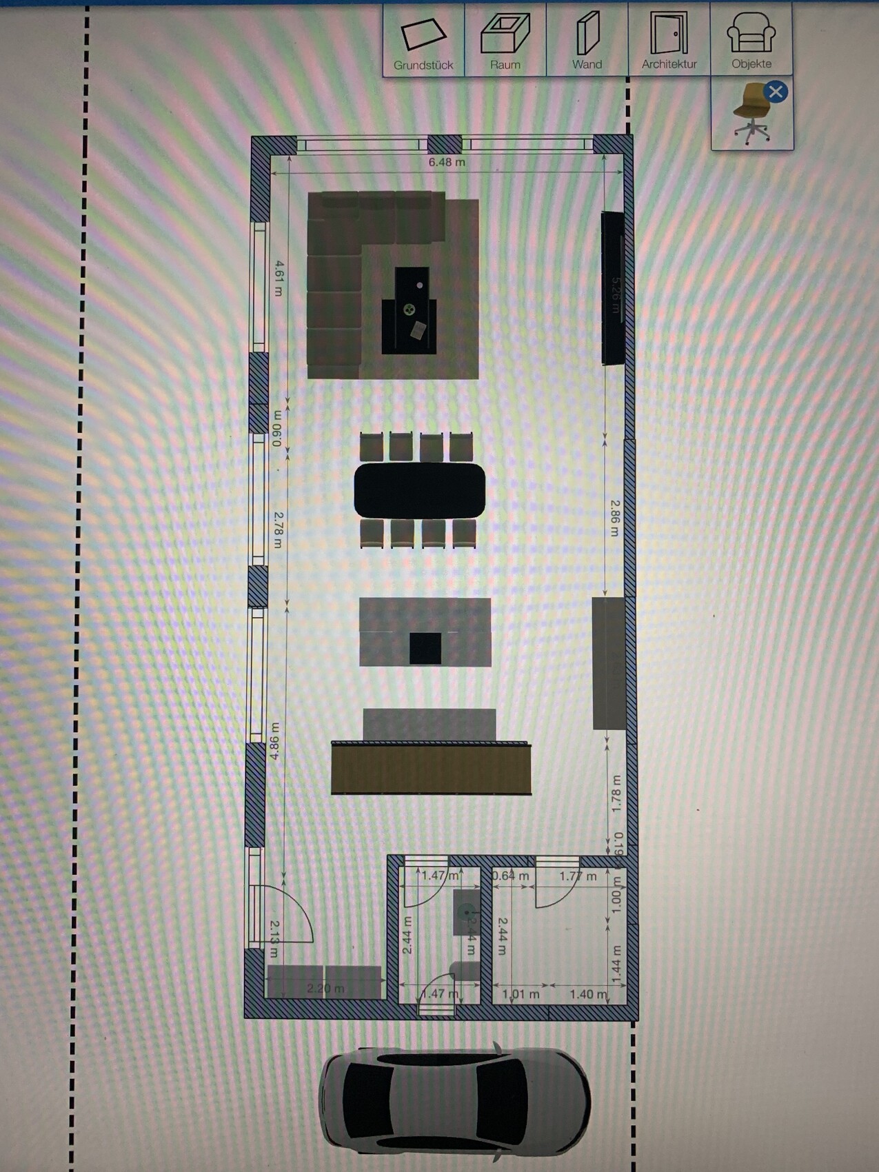

Otherwise, it also feels a lot like a showroom: downstairs it’s like Pinterest for the guests, and upstairs it’s a shoe box that’s hard to bear. Yes, that’s true; there still needs to be a solution for upstairs. I’ve added pictures downstairs… maybe this works better?

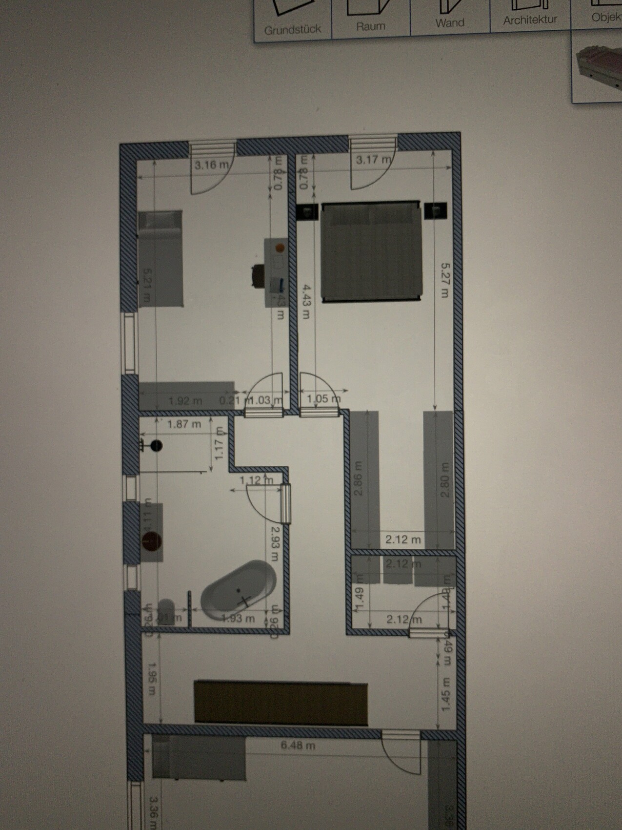

Here is a more family-friendly version... planned from top to bottom:
[ATTACH alt="grundriss-Doppelhaushälfte-7x16m-auf-390qm-in-einer-siedlung-533009-1.png"]66022[/ATTACH][ATTACH alt="grundriss-Doppelhaushälfte-7x16m-auf-390qm-in-einer-siedlung-533009-2.png"]66023[/ATTACH] Hmm, yes, it definitely looks better at the top now. How are the plans? See attachments.
I wouldn’t like the upper floor. Bedrooms are too narrow, and the double casement windows are not operable... If you like it? (The door to the utility room cannot be placed under a sloped ceiling, nor can the window in the gable.)
On the ground floor, I would make sure that you can’t see the car from the open-plan living area. Is the car parked at the front? Is an entrance canopy feasible?
I wouldn’t like the upper floor. Bedrooms are too narrow, and the double casement windows can’t be operated...
If you like it? (The door to the utility room can’t be placed under a sloping ceiling, and neither can windows in the gable)
On the ground floor, I would make sure that you don’t see the car from the open-plan area. Is the car parked at the front? Is an entrance canopy feasible? The windows are supposed to represent skylights; unfortunately, the app doesn’t have skylight options.
You could also add an external door to the utility room. But overall, it’s no dream plan. I actually liked the upper floor as it was before… especially because the stairs to the attic probably won’t work either, since they’re under the slope.
That’s why I will probably stick to my original plan and accept the narrow layout, because the upper floor is important too… even though I find the ground floor really perfect.

I stick to my assessment that a shorter house with a finished attic—planned integrally as part of the design!—offers more living and quality of life than maximizing the building footprint just because you can and think that more is better. What other information is needed?! The ceiling height is planned at 2.50 m (8 ft 2 in). We do not want to make the house shorter because I already barely have enough space for my needs and preferences. A shorter but wider house would of course be ideal. I just don’t have that option. I like the upper and attic floors as they are and would keep them without feeling bad about it. On the ground floor, I like the fully open layout; sure, the narrow corridor feeling bothers me too, but she also doesn’t like separating the living room from the kitchen/dining area. If I had the south side, I wouldn’t even think about it.
My MAIN PROBLEM is not the layout itself but rather that it will be too dark, and that’s why I want to make some changes to be able to plan more windows. But I want a door with a medium glass panel and a glass side panel on the west side so that I get some light there, too. I JUST HOPE that if it stays like this, it won’t be too dark. Somehow all the changes or attempts I started don’t really work.
