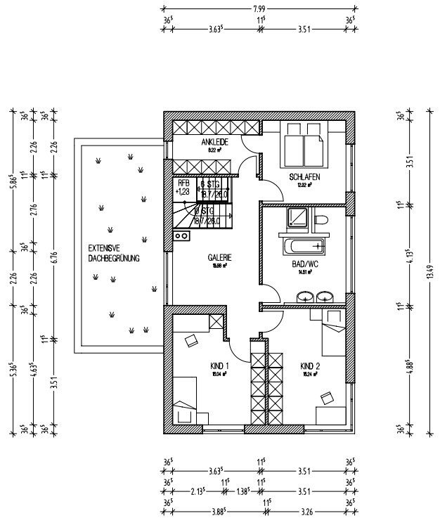

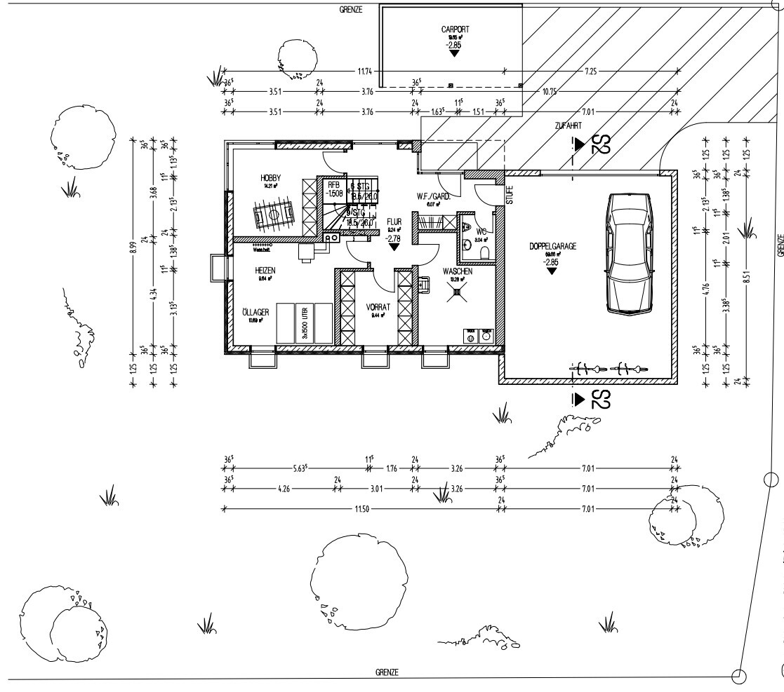

I wanted to share my current floor plan here.
Currently still being modified:
- Kitchen area (pantry will be removed)
- Corner windows will be removed
- Carport will be removed
The plot is slightly sloped, see the elevations.

What requirements do I have to meet with an oil heating system? I’m planning a wood-burning stove in the living room. Do I also need solar, photovoltaics, or both?You need a renewable energy component for heating or hot water supply. You could possibly integrate your stove into the hot water system, which should be allowed. Otherwise, solar thermal is the classic option, but it is not cost-effective and takes up space that could be used for photovoltaics. Photovoltaics only count if you use the electricity directly for hot water heating with an electric heating rod (immersion heater). That is also uneconomical. Your energy consultant should be able to provide more detailed advice.
al3x_ schrieb:
- Gas? Not availableFor completeness, that is also possible with a tank. If you have a lot of earthworks planned anyway, it might be something to consider.
al3x_ schrieb:
The architect simply marked the 3x1500L tanks. Nowadays, there are modular tanks that can be combined as needed, without a bund. How many I actually install will be seen later. They are relatively inexpensive, and the price naturally decreases significantly with the quantity.At the required volume, the cost is not very high. Whether you fill 1000L per year for 600€ or 500€ doesn’t make much difference … it will take a long time to pay off the tanks and the space they occupy for the 100€ difference.

When I sit on the sofa, I watch TV or something else, but not the terrace. Nothing particularly exciting happens out there You can tell you are planning as a single person. Sitting on the sofa, doing your own thing, and at the same time keeping an eye on the kids outdoors offers added value.
5. When planning for a family, consider that many women intending to marry wouldn’t necessarily want to move into a finished house owned by someone else.I agree with that. The shared urge to settle down. Usually one person ends up moving in with the other. But what can you do? Land is available, money is there, motivation for the project exists … maybe there are women attracted by a place like this. A topic for social research.
