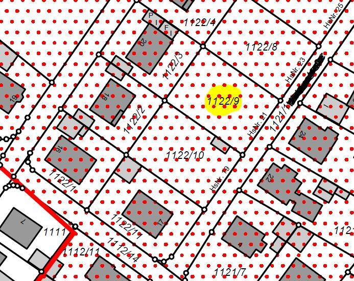

Plot size: 700 sqm (7,535 sq ft)
No slope
Site occupancy ratio (building coverage ratio): 0.3

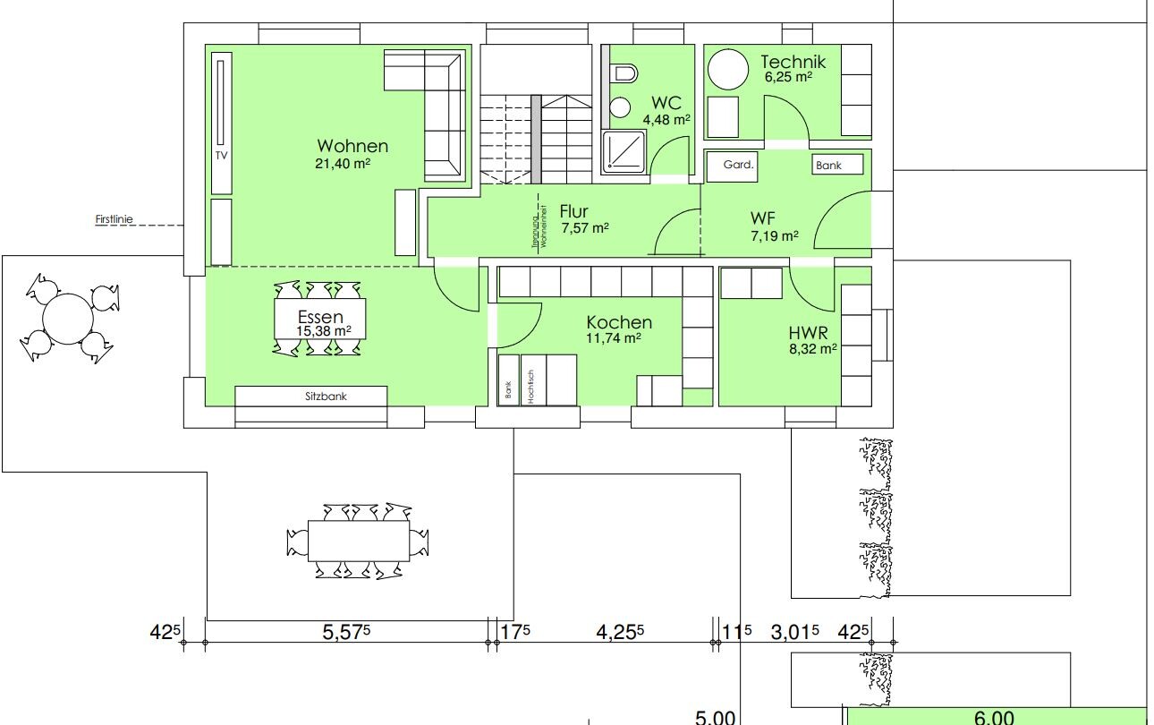

Additional wishes / special features / daily routine, also reasons why some things are desired or not: Each children’s bedroom has an attic ladder leading upward, so the rooms can be expanded upstairs when the kids are teenagers and want more space. We have seen this realized in 2-3 houses and think it’s pretty cool.
Who designed the plan: Independent architect
What do you especially like? Why? The southwest garden protected from the street. The living room, which is open yet still brings some calm due to the niche and the door that only leads into the dining area. The kitchen has a terrace door that can be unlocked from outside, so groceries can be carried straight into the kitchen. The walk-in closet, which adds visual calmness to the bedroom. Storage space under the stairs. The separation of the technical room and the utility room, allowing the utility room to be kept tidier.
What do you not like? Why? I worry that the bathroom on the ground floor and the office might be somewhat too small. The children’s rooms seem fairly generous with 17 sqm (183 sq ft); 16 sqm (172 sq ft) might have sufficed.
Price estimate according to architect/planner: The architect is handling only phases 1-4 for us. We have not yet decided whether to hire a general contractor or use individual contracts and arrange construction supervision ourselves.
Personal budget limit for the house, including fixtures and fittings: 500k
Preferred heating system: Ground-source heat pump with horizontal trench collector
If you had to give up something, which details/upgrades
- can you do without: We have already dropped the basement and fireplace; we will probably also give up on the “T” layout in the bathroom to avoid making it too dark and cramped.
- cannot do without:
Why is the design the way it is now? For example:
Standard design from the planner? The plan was created individually based on a questionnaire we completed for the architect.
Which requests were implemented by the architect?
- Carport and shed cover the neighbor’s unsightly prefabricated garage.
- House and carport form a kind of L shape lying down that creates a protected southwest garden.
- Two children’s rooms with at least 15 sqm (161 sq ft) + office
- Kitchen separated from the living/dining area by sliding door
- Long-term option to convert the upper floor into a separate living unit (for flexibility and eligibility for KfW funding for two dwelling units)
What do you think makes the plan particularly good or bad?
Overall, we quite like the plan. We now want to look at details (for example, the walk-in closet slightly larger by about 1 sqm (11 sq ft) so that a low cabinet could fit against the second wall). The windows are not planned yet and were initially placed arbitrarily by the architect.
We are especially looking forward to your open feedback to optimize the plan further before it gets serious and hopefully avoid some mistakes. 😉

Who is supposed to live on the ground floor? The bathroom is not suitable for elderly people either. At 35 years old—even if the avatar shows some early greying—I wouldn’t give any thought to downsizing for senior living in an existing property. The trend, based on the idea from the New Bremen Town Musicians, “we can find something better than a stairlift anywhere,” of becoming homebuilders again close to retirement age has already reached those born in the 1960s and later.
Mitch404 schrieb:
I’m happy to avoid the 8sqm (86 sqft) hallway and use the space differently.
Any ideas how? 🙂 It was already mentioned: simply redesign without the “one-third bowling alley.”
As mentioned before: a different floor plan shape (which does not mean becoming larger).
With a closed layout including a corridor, you need to ensure that the corridor does not become excessively long. It might be worth trying to position the entrance on the long side of the house.
Hey everyone,
Thanks a lot for your clear answers and ideas!
I definitely want to try moving the main entrance to the south corner, for example.
Just because we like many aspects of the current floor plan doesn’t mean I’m not open to completely different approaches. I’m not ruling anything out at this early stage. ^^
Work is really busy for me right now, so apologies for the late reply and it will take me a few days before I can provide another update here.
I really appreciate being able to exchange ideas here, so thanks again and talk to you soon! 🙂
@Mitch404
If you like a rectangular house, take a look at the floor plan of the Town & Country Aura 125 townhouse. The house is only 6.50 meters (21 feet) wide. It also has a side entrance and a (nice) sightline through the entire house. If you don’t want that, you can add a door at the transition to the dining area, and the hallway won’t be as long.
Maybe a useful template for you.
Mitch404 schrieb:
Just because we like many aspects of the current floor plan doesn’t mean I’m not open to radically different approaches.Then I’ll update my suggestions: b) to "angle" the southwest eaves side, and a) to at least give the option of dividing the building later a low priority.https://www.instagram.com/11antgmxde/
