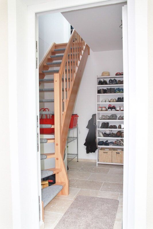

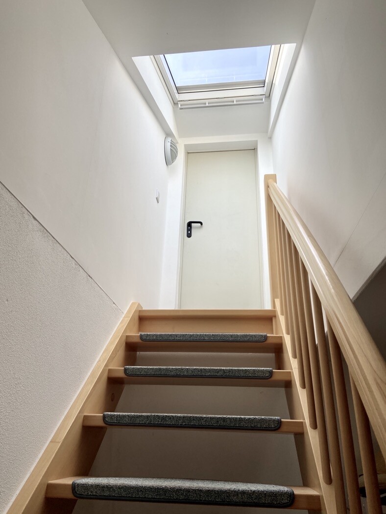

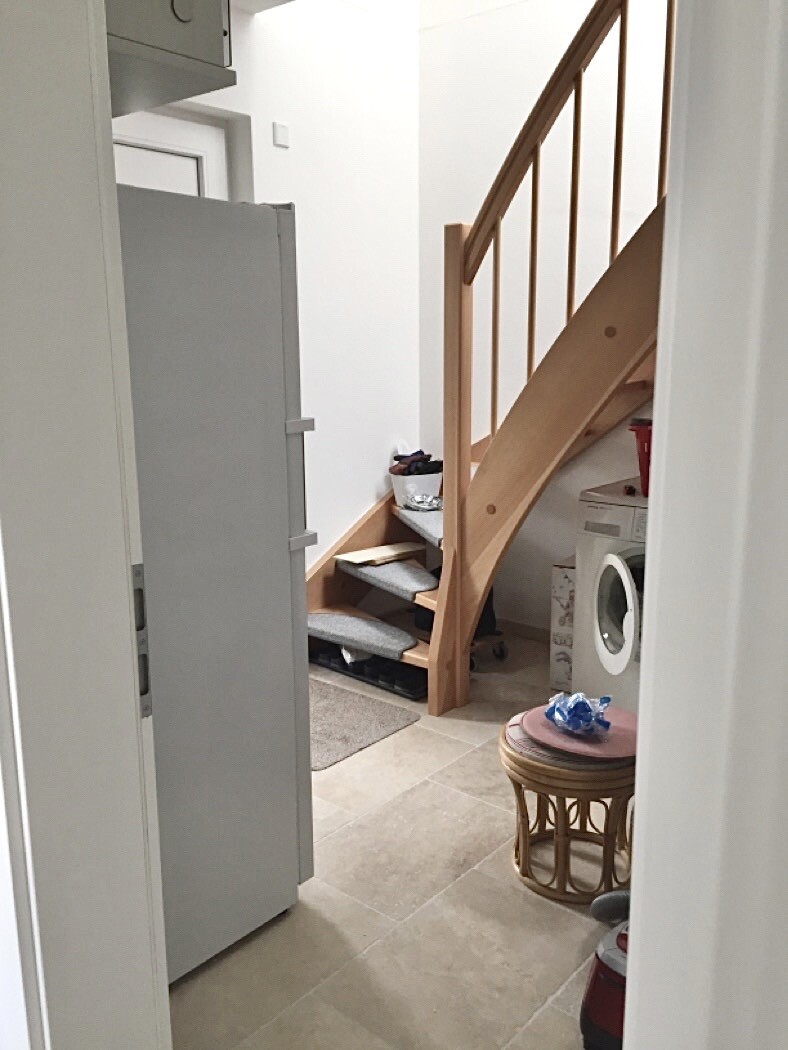

Jurassic13528 Feb 2023 19:49We have a fixed staircase to the (currently) unfinished attic, and I definitely don’t want to do without it. I don’t want to have to carry suitcases, Christmas decorations, furniture, etc. up a ladder. And if we decide to finish the attic later, everything is already prepared for that.
