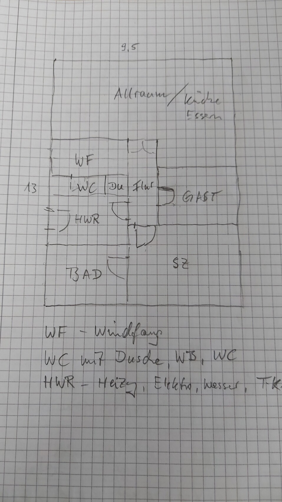

I am sharing the floor plan as we have developed it. Perhaps there are some suggestions?
The dimensions are interior room sizes, with a wall thickness of 10 cm (4 inches) assumed. Depending on the actual wall thickness, adjustments will be necessary.
Plot size: 1200 sqm (12,917 sq ft)

Other constraints: the plot is only about 16 m (52 feet) wide, so the house must not be wider than about 10 m (33 feet) in this direction

Designed by:
- Do-It-Yourself, created based on various templates
What do you like most? Why?: large window front on the south side with direct access to the garden
What do you not like? Why?
- Corner in the hallway between utility room and bedroom, but the hallway should remain large to avoid bumping into each other and to have enough space for motorbike gear,
- I would prefer the fireplace positioned more in the corner between kitchen and living area, but that conflicts with neighbor distance regulations and emissions protection
Price estimate according to architect/planner: initial offers are around €190,000 for about 110 sqm (1,184 sq ft), but changes are still needed
Personal price limit for the house, including fittings: should not exceed €200,000 plus additional construction costs; equipment is already taken care of

Is there anything that doesn’t work at all? Any room for improvement? What would you do differently? Where could it be optimized?

It is not complicated or expensive, just different.
Three years ago, we came up with seven floor plans and discussed them in a family meeting. Plan number 4 was chosen and refined logically with an architect. It was revised about 10 more times and adjusted to fit the furniture before it was approved for construction half a year later. Now it is our home.

motorradsilke16 Dec 2020 12:23Thank you. I really like the idea of the gallery. I’ll see if I can "borrow" it.
I’m not so fond of the rest of your floor plan, though; I don’t want to have to go through the bedroom to get to the bathroom, and your vestibule would be too narrow for a hallway.
But I’ll see if I can make something out of it—you can always swap the rooms around.
@Nida35a thank you very much for sharing. Your interior design isn’t quite to my taste, and it doesn’t have to be, but it still looks cozy despite the open layout, which can often be contradictory. The gallery would also appeal to my bonus child. Unfortunately, I don’t have space for something like that...
I fully agree with you on having a central spot for entertainment, but are you aware that your seating distance from the TV is a bit too far? 😉
