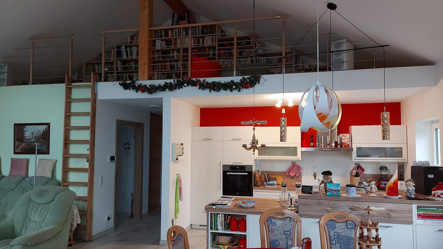

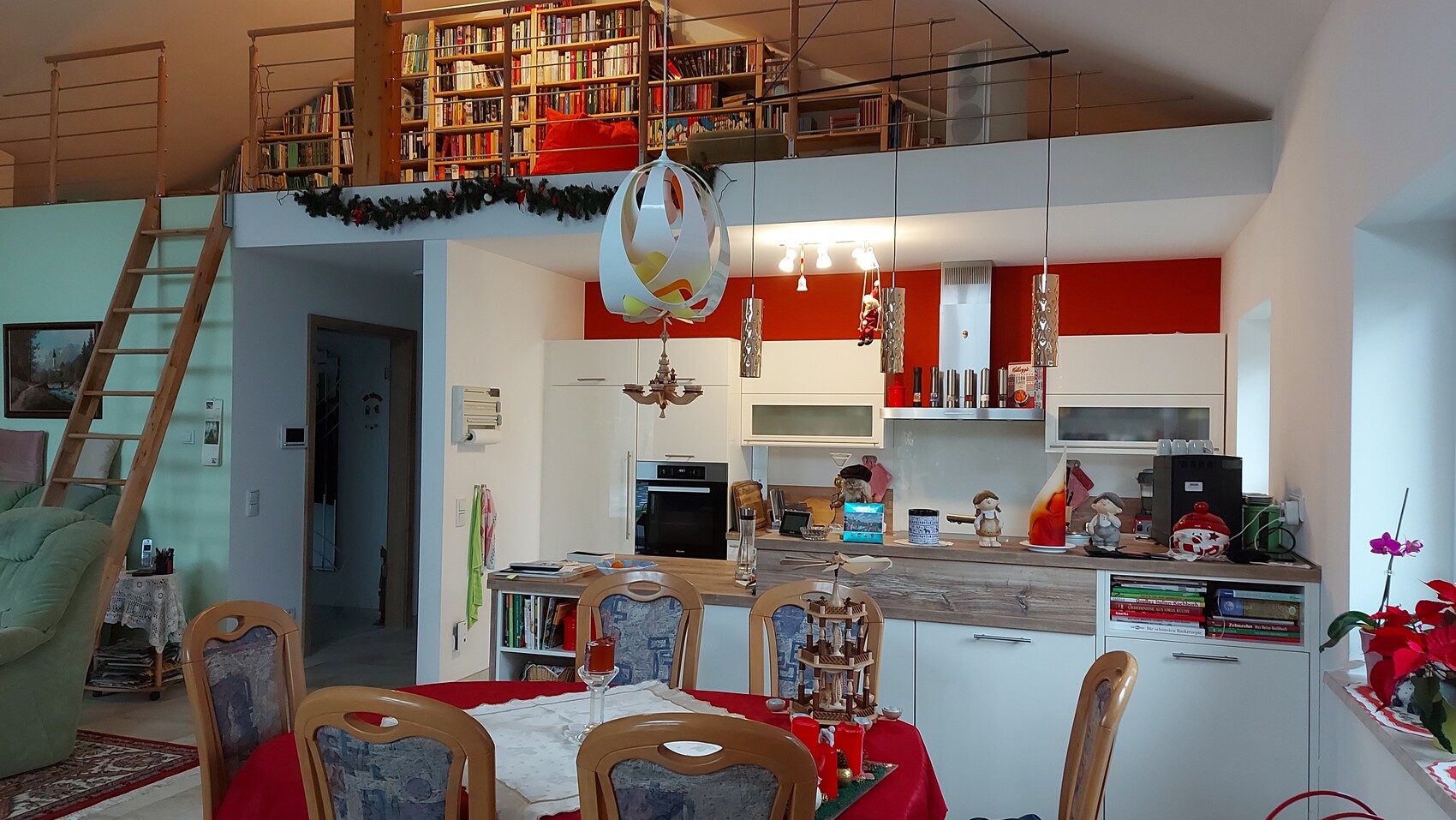

motorradsilke16 Dec 2020 06:32Nida35a schrieb:
Half of the house has a cold roof attic,
the other half has an open space warm roof with a gallery and a play area for the grandchildren Do you also have a picture of the gallery? How do you get up there? Via the stairs in the bedroom?
I think the idea is great, but it’s probably quite complex and expensive?
