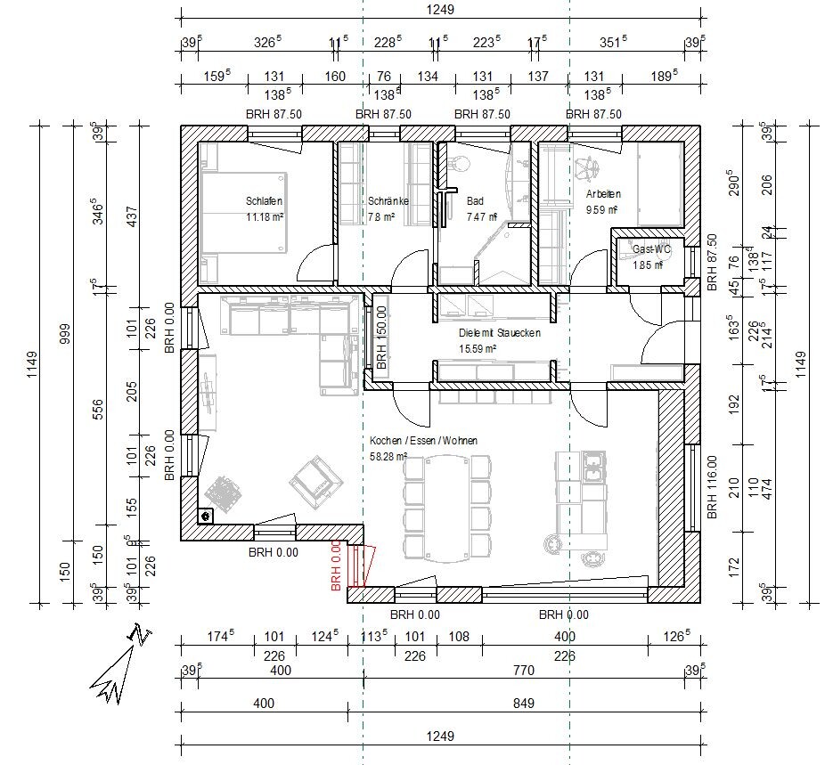

Hello everyone
I am opening this for discussion.
The utility room is integrated into the carport and is located on the boundary. Apparently, this is not an issue.
Best regards, Portoalegre
2D floor plan of a house with living room, kitchen, dining, bedroom, bathroom, hallway, and utility room.

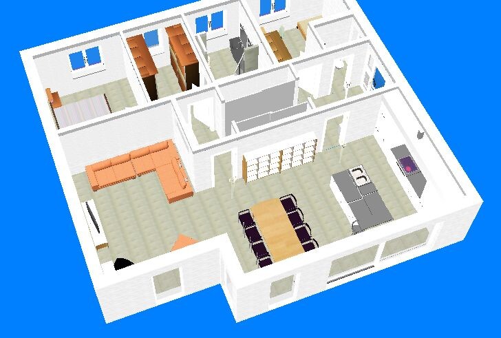

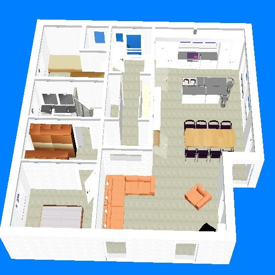

kbt09
6 Feb 2016 11:20
It’s really inconvenient to have to go through the mudroom to get to the bathroom 😉.
This is more how I could imagine it.
Grundrissplan eines Einfamilienhauses mit Küche, Essen, Wohnen und Schlafzimmer
Isometrischer 3D-Grundriss eines Hauses mit Wohnzimmer, Küche und Essbereich
3D-Grundriss eines offenen Wohnbereichs mit Küche, Esstisch und Sofa
Portoalegre
6 Feb 2016 11:32
kbt09 schrieb:
It’s all the worse when you have to go through the mudroom to get to the bathroom 😉.
This would be more like what I imagine.
Another option is to access the bathroom from the bedroom.
I’m quite impressed with your design.
MarcWen6 Feb 2016 11:40
Portoalegre schrieb:
Our priorities are not in the hallway or the bathroom. After 30 years of marriage, we have realized this for ourselves.
Then relocating the bathroom to the garden shed will surely give the colleague at the district building office plenty to do.
And always be sure to close the door in the guest toilet—blue knees probably aren’t comfortable in the long run. 😉
