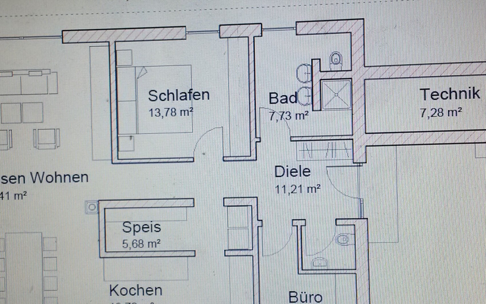

I am opening this for discussion.
The utility room is integrated into the carport and is located on the boundary. Apparently, this is not an issue.

Then let’s get to the point... after all, enlarging the bedroom, bathroom, and pantry should lead to something different than this:
Besides, I don’t think this layout works well since you have to pass through the entry hall from the bedroom to get to the bathroom.
For clarification: is the bottom of the plan facing south? How far is it set back from the street?

Downstairs faces southeast. Sorry for the measurements; I didn’t have them with me on site.

Without a truck maneuvering license, the restroom is not usable 😀
Is the washing machine still running live in the living room?
Does the hallway still have 80 cm (31 inches) width?
