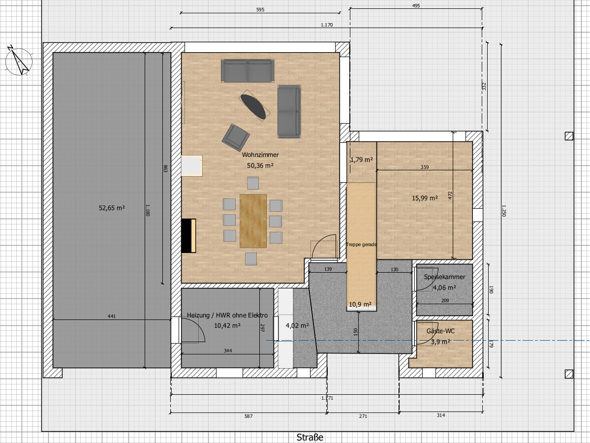

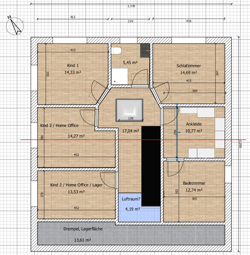

Hello! We are currently on the third iteration of the plans for our house together with an architect. The two images below are based 90% on the architect’s proposals for the ground floor, while I have currently designed the upper floor myself. The orientation on the plot is fixed, meaning we get evening sun from the left side of the plan. At the moment, our terrace faces south, which is unbearable during summer, so we have moved the seating area to the northeast. That doesn’t bother us since we plan to have outdoor heaters anyway. The garage must remain on the left side of the plan because all utility connections are located there. The house will have an asymmetrical gable roof with a 35° pitch facing the street (southwest, for photovoltaic panels) and 25° facing the garden. The ridge runs parallel to the street. As a result, the garden side has almost no knee wall, while the street side is about 1.80 m (6 feet) high.

Here are the images
Floor plan of a house: bedroom, child 1, child 2/home office, dressing room, bathroom.

Hmm, not really. Maybe you could share the architect’s complete drafts. For your upper floor, I would immediately ask where the children’s bathroom drains to? Through the living room? I’m also not very keen on the room layout with these angled door intersections.
The start of the staircase on the ground floor is kind of annoying, isn’t it? You’ll probably spend most of the time maneuvering around it or stepping over it. Is there a cabinet in front of the utility room entrance? Planning a cabinet door there would seem very odd to me. It’s one of the most frequently used doors. You want something sturdy with a proper handle for quick access. No soft-close or any unnecessary gimmicks.
The setback in the entrance area is also a very unfortunate choice if it creates that useless niche in the guest restroom.
The site plan on the property is missing.
Even if you don’t want a sunny terrace right now, that doesn’t mean you have to block it out completely. Facing east is probably the darkest orientation you can pick. With that huge garage on the west side, I would find it too dark.

That doesn’t help in this case, since the latest plans are very different—the kitchen has moved and is much too small. We’ve already changed that and I’m waiting for the updated plans. I just sketched a quick version myself in advance.

For your upper floor, I’d ask right away where the kids’ bathroom drains to? Through the living room? Also, the room layout with these angled door junctions doesn’t look great to me.
Good point, I’m not really happy with that either, but I can’t think of a better solution if the small bathroom stays. We could move it completely down over the utility room, but then I’d have a kids’ bedroom directly next to the master bedroom, which I wanted to avoid.

Is there a cupboard in front of the utility room entrance?
Yes, it’s meant to be a “hidden” entrance, similar to concealed pantry doors. The longer I look at it, the more I think I’d end up constantly hanging jackets there. We’ll see.
K a t j a schrieb:
The recess in the entrance area is also really unfortunate if it creates that useless niche in the guest bathroom.
True, the recess is currently 75cm (30 inches), but I actually quite like it. Maybe the wall will just be made thicker and the niche will go away.

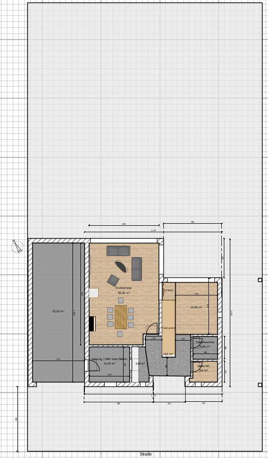

Attached below.

Just because you don’t want a sun terrace now doesn’t mean it has to be completely ruled out. Facing east is about as dark as you can get. With that huge garage on the west side, it’d be too gloomy for me.
There will also be a terrace in front of the living room, but I quite like the covered seating area in front of the kitchen. We currently live very close by, so the sunlight situation is well known. Neither visually (glare) nor thermally is it comfortable to stay there for long. The sun really shines there until it sets. I’m hoping the glass surfaces in the living room will still bring some light to the seating area.
Floor plan of a house with living room, kitchen, dining area, hallway, bathroom, and garage.

There is clearly no architect in sight or on site. The staircase is always in the way. Overall, the house feels like a darkroom.
It used to be said that "anyone can plan on a large scale," but even that has to be questioned here.

Phew. Strong opinions here. Anyway, could you give me a few points to help me understand what exactly is so bad about the ground floor? As I mentioned, I designed the upper floor myself, so that’s not the architect’s fault. I moved the staircase out a bit to create more space upstairs; originally, it was almost flush with the wall and didn’t protrude as much.
Adding more windows on the ground floor is really difficult because on the right side of the plan there’s a garage, and next to it a two-and-a-half-story building. On the left side, there’s also a garage right on the property line, and next to it, toward the garden, there’s a neighbor’s terrace. People end up looking in from the side. Only the front and back have nothing like that.
In the architect’s first draft, the garage wasn’t as long toward the garden, and there was a side window there.
