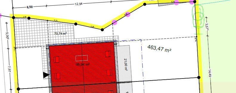

Here is the floor / site plan (north is up):

RahliMarcel29 Apr 2017 10:30ypg schrieb:
Where is north? It seems to me that although the child’s room is large, it is facing north?No, it has a west orientation; the bathroom faces north.
The door on the ground floor leading to the bathroom definitely needs to be relocated. It is very cramped there, and it won’t be long before the doors bump into each other.
I find the position of the refrigerator problematic. First, it is quite far from both the cooktop and the sink, and second, the walking paths are further restricted by the “kitchen island.” Additionally, I prefer to have a counter space right next to the refrigerator to temporarily place items when loading or unloading. However, this is also probably a matter of personal preference.
On the upper floor, I would definitely recommend installing a proper window in the office, and I would position the window of the lower room more toward the center of the wall. Having it right next to the wall is not ideal in my opinion.
Apart from the fact that door widths are usually around 90cm (35 inches), 74cm (29 inches) really seems quite narrow. Everything looks nice on the plan, but in reality, it will be small and possibly too late to change it.
As for the kitchen island you often see in American movies and TV shows, I don’t have any personal experience with it yet, but I can imagine it looks good. However, it is a bit of a longer walk to the sink.
