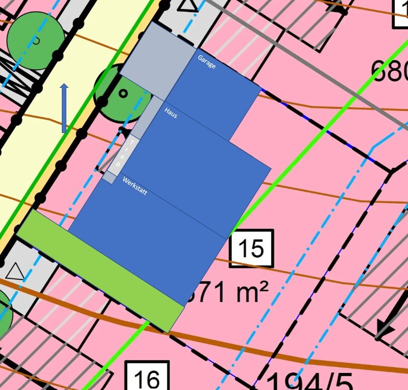

hanghaus20237 Feb 2023 11:01By the way, I have unsubscribed from the thread; all the popcorn for the Simshausthreads is really adding up on the hips, and our house has a flat roof, so I can’t install a grease extraction system in the attic ;-)
hanghaus2023 schrieb:

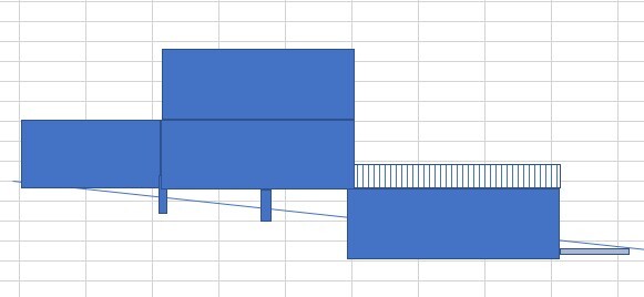

Here is one option. This provides access to the workshop on the south side.
Are you still working with a floor area ratio of 0.4?H
hanghaus20237 Feb 2023 13:13K a t j a schrieb:
Are you still working with:
Floor area ratio: 0.4?Yes, that’s why the path on the south side is green.So, to summarize the basics briefly:
The floor plan shown needs extensive revision, and combined with the slope and the garage, it is financially borderline. Including the requirements for the basement will definitely exceed the budget.
The question remains:
Are you willing to compromise on the basement, for example by reducing the size of the workshop, or can you significantly increase the budget (would a bank still approve this, and would that still be feasible with children, or would the wish to have children have to be sacrificed and the house planned smaller accordingly)? Are you prepared to invest that much additional money specifically for the workshop basement?
K a t j a schrieb:
For rough location sketches, you would need the precisely measured plot including all building envelopes, setbacks, or other zoning plan details. Contour lines were somewhere already, I believe. The contour lines are relatively inaccurate; we have fully surveyed the plot using a grid of 4.5 m x 3 m (15 ft x 10 ft). I can gladly compile the information, at the latest by the weekend.

I ask again, where is the construction taking place? In Bavaria, in the greater Regensburg area.
Are you planning to do the carpentry work yourself? That would certainly be possible. The garage, in principle, is not a big problem—if it weren’t for the green flat roof... Perhaps switching to photovoltaic panels as a standalone roof covering might be an option (which is also allowed according to the zoning plan). I’m happy to receive inspiration on this. Recently, I heard of a green metal roof where the vegetation grows between the standing seams.
No ground-level exit haydee schrieb:
How do you plan to get materials from the street into the workshop? Do you never want to use a crane or similar? In my design, there would be two large doors in the basement facing south. A gate in the fence allows access relatively close to the workshop.
Load-bearing columns There is no doubt that a few will be necessary. These must be positioned according to the structural engineer’s specifications. This again depends on the building method and the loads above. However, the columns can certainly be minimized; I am not overly concerned about this at this stage.
150 sqm (1,615 sq ft) living space * 3000 Euro = 450,000 + 50,000 garage + 150,000 basement + 50,000 landscaping = 700,000 If the garage is postponed or completed entirely as self-build, the cost would come closer to approximately 650,000 €. There may also be potential savings on landscaping since agricultural equipment is available.
So, if one is cautiously optimistic, it could be said that, in theory, with some compromises and a lot of own work, it would be achievable.

Here is one option. This provides access to the workshop from the south. Thank you very much! You are really putting a lot of effort into this, which we appreciate. Since costs are often discussed, where exactly are the cost advantages found here? Is it because less earthwork is required?
From the presentation, I assume it is built on stilts with point foundations?
How much additional effort is involved for the extra floor slab (or ground slab of the house)?
