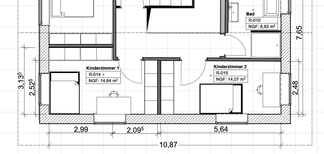

I have attached a picture with the children’s room measurements; the depth is about 2.5m (8 feet).

Huge basement space up to the garage with this budget. Cutbacks can definitely still be planned there, but as mentioned before, having no basement at all is definitely not our goal.
A room depth of 2.50 m (8.2 feet) is too shallow for a living space like a children’s room. You can clearly notice that the closet doors next to the bed no longer open properly, let alone having space to stand in front of them.
