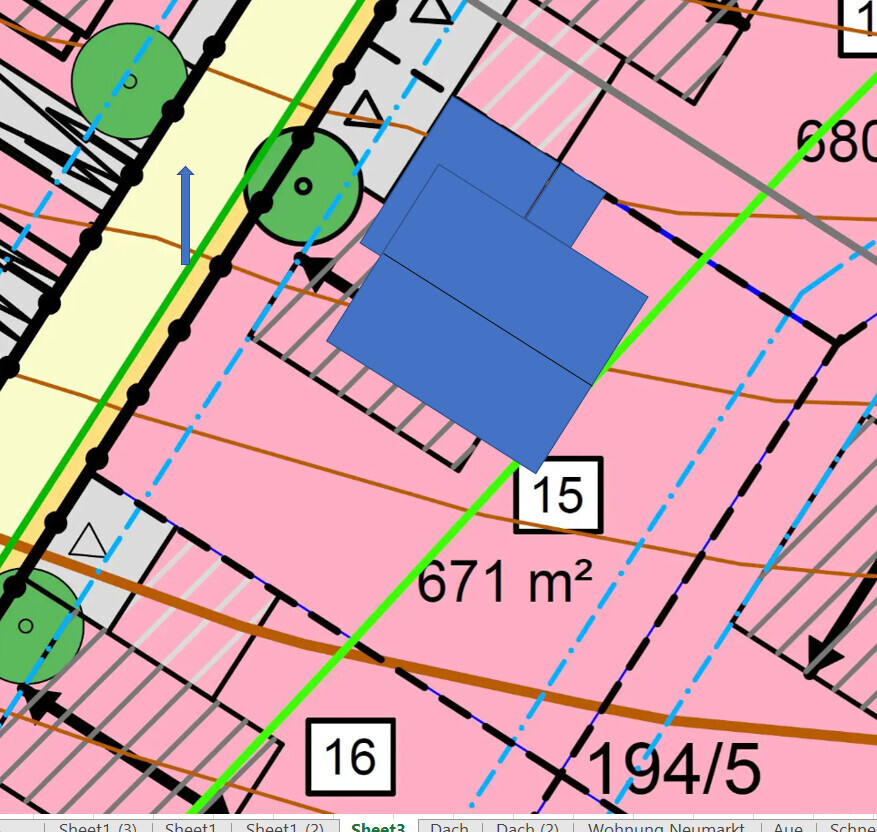

hanghaus20236 Feb 2023 12:14H
hanghaus20236 Feb 2023 12:23That might work fine for the planning stage. However, I’m not even convinced that it should actually be implemented that way. With such a huge basement, it will become unaffordable for you. Therefore, my suggestion is to omit the basement or lower ground floor. It works well without it too.
You have exactly 1 m (3.3 ft) slope over the 9 m (29.5 ft) parallel to the street in the house area.

I have planned a layout option for the positioning on the plot.Thank you for your effort. From the drawing, I can’t quite tell where the garage would be located. On which level?
