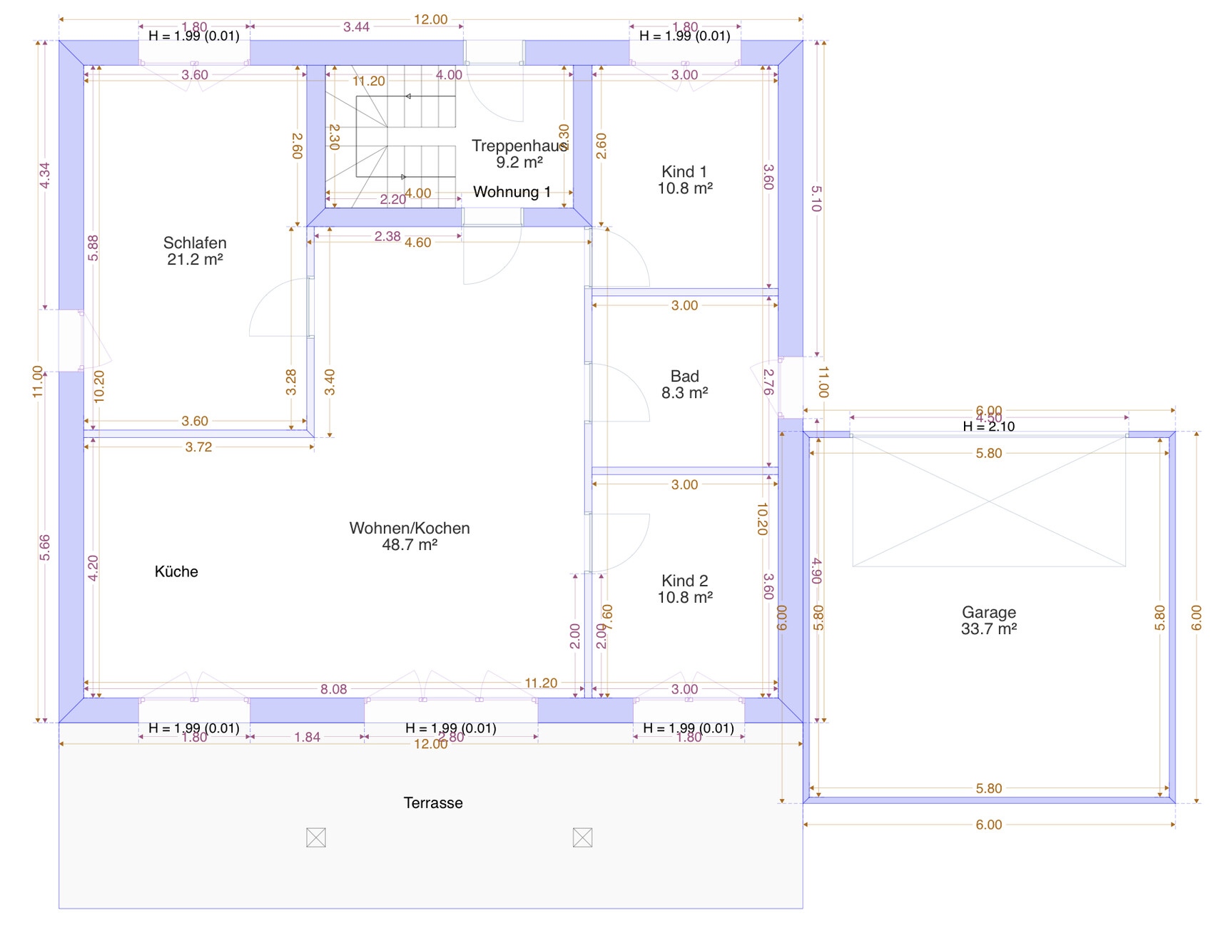

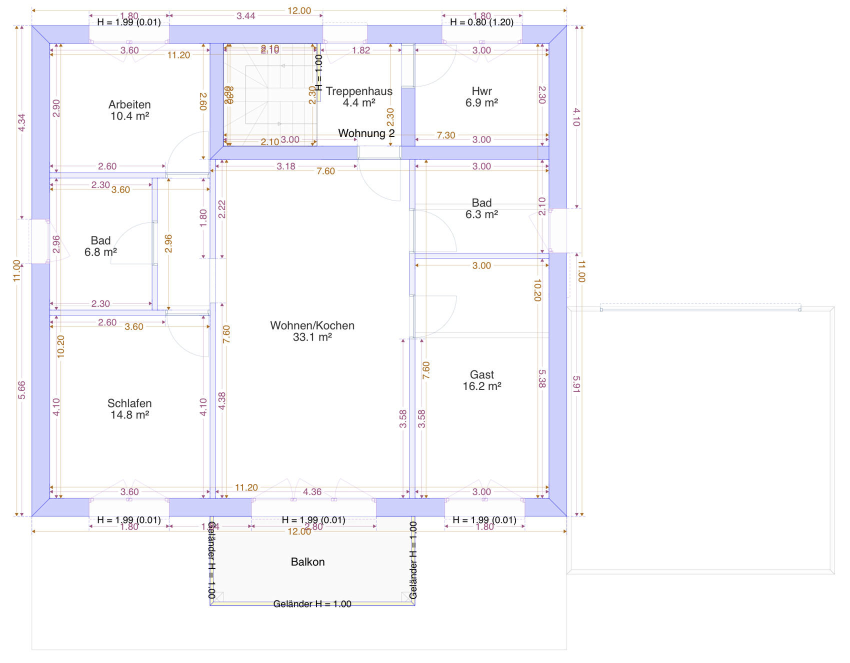

we plan to build a house with two residential units on a 472m2 (5,079 sq ft) plot of land (Unit 1: 143.39m2 (1,543 sq ft) / Unit 2: 69.57m2 (749 sq ft)).
The second unit is intended for my parents, while the main unit is for my family, which includes my spouse and three children (ages 7, 13, and 17).
Since our plot is relatively small, we want to build a compact house to maximize the garden space.
We are currently in the final planning stage and would appreciate your feedback on our project.
We have a feeling that we might have overlooked some important aspects or not paid enough attention to certain details because our planning focus was mainly on the compactness of the house.

K a t j a schrieb:
Well, the children are 17, 13, and 7 years old. Apart from the little one, I think you can expect a certain level of pain tolerance from the other two.??? – the parents of Claudia-Maren were meant.https://www.instagram.com/11antgmxde/
??? - It was meant to refer to Claudia-Maren’s parents.Huh? The point is that three elementary school children would definitely create a mess in the cloakroom that Grandma and Grandpa might find overwhelming. But at 17 and 13 years old, the two older kids can surely manage to hang up their jackets properly and put their backpacks in the closet.
MarlenP schrieb:
Since it concerns our own family, the shared hallway doesn’t bother the parents. It’s not ideal, but we have to be willing to compromise here. Aha, it doesn’t bother the parents, but you do… yet you would accept the compromise. But actually not…?!
MarlenP schrieb:
That would probably mean 1 or 2 children’s bedrooms would have to be in the attic. No. The house will remain roughly the same size because the space requirements don’t change.
MarlenP schrieb:
The student plans to stay in town after finishing university (also has a job prospect lined up). MarlenP schrieb:
But it’s exhausting to speculate about what will happen in 10-15 years. It doesn’t matter what happens in 10-15 years. True. But as the planner, you need to know whether the student will stay at home (for whatever reasons), or if it can be encouraged that they look for their own place. Sorry, but the key issue here is a room that is somehow too large for a senior apartment and doesn’t really belong to you.
Sunshine3875 Sep 2022 22:32To be honest, there are quite a few "ifs" involved. If I were you, I would either plan a nice granny flat for the elderly family members and more space for your own apartment, rather than prematurely accommodating someone who might want to live somewhere else after graduating. If that does turn out to be the case, I have a simple idea to suggest. You could place the seniors’ apartment and the student’s one-bedroom unit on the first floor, arranged in a way that the space can easily be converted into a four-room apartment. Then, the spacious apartment would be on the ground floor for you. Although this wouldn’t be fully accessible, I know many people who still manage to live on the first floor at an advanced age (sometimes with the help of a stairlift). If this is possible, I would consider it a suitable option. Essentially, this would be a classic two-family house with identical layouts on both floors, but with the option to separate the units. A house with two four-room apartments is also easier to sell later on, unlike your original idea, which is unfortunately much harder to sell.
Basically, the original poster wants two houses for the price of one. In my opinion, that’s the main issue where the project is currently failing.
Well then, make a buildable proposal with four bedrooms, living room, kitchen, dining area, utility room, staircase, bathroom, guest toilet, plus two parking spaces and a terrace, all on this plot in one level. I’m curious.
That’s not to say it’s impossible, I just find it challenging.
Sunshine387 schrieb:
To be honest, there are quite a few “ifs” here. If I were you, I would either plan a nice granny flat for the seniors and more space for your own apartment instead of rushing to accommodate someone who might move elsewhere after finishing their studies. And if that does turn out to be the case, here’s a simple idea: place the seniors’ apartment and the student’s one-bedroom flat both on the first floor, but in a way that the apartment can easily be converted into a four-room flat. Downstairs could then be a spacious apartment for you. It’s not barrier-free, but I know many elderly people who still manage to get upstairs (sometimes using a stairlift). If that’s possible, I would plan this as a suitable option. That way, in principle, you have a classic two-family house with identical floor plans on both levels, just with the option to separate part of the living space.
Sunshine3875 Sep 2022 23:17Of course, this is really difficult, I admit that. Here is my suggestion. Yes, there is a room missing downstairs, but you could sacrifice the kitchen to create an additional room there. Then you would still have only about 33 m2 (355 sq ft) of living/cooking space like upstairs, but that might just be enough. Or two children could share a room, or the eldest could move upstairs into the student apartment and the student would get a tiny house in the garden. That’s pretty cool too, right? Of course, this is not meant seriously. Maybe it inspires a new good idea for you now.
