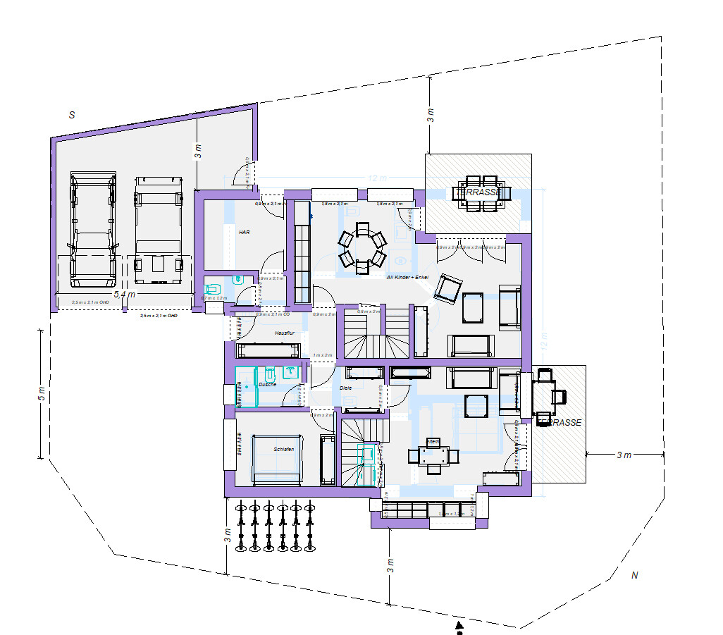

Site plan: building II WD 30 with red hatching, outlines and driveway.

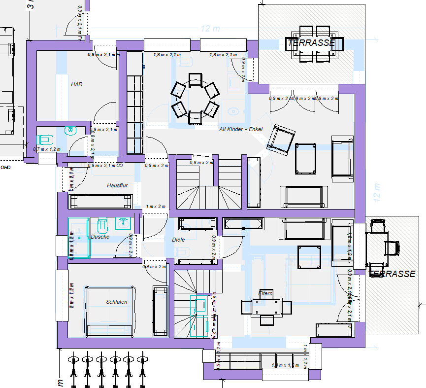

Floor plan of a house with living room, kitchen, bedroom, bathroom, stairs and garage.

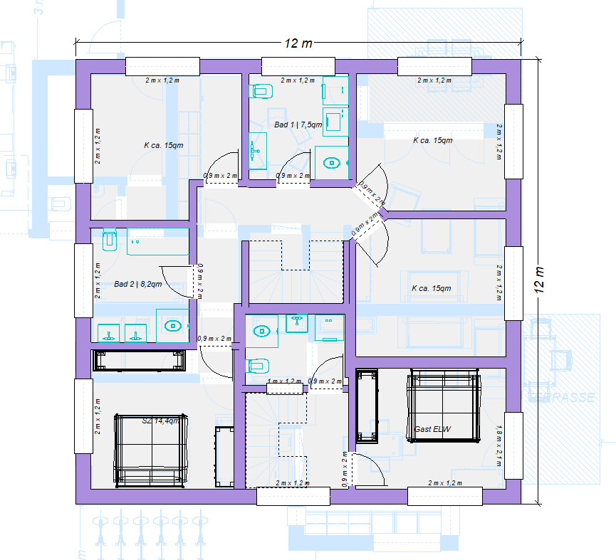

Floor plan showing bedrooms, children’s rooms, bathroom, hallway and staircase.

Garages/carports must be at least 5m (16 feet) away from the street, at least in our building area.
Deal breaker. So the first design is off the table. To save it, we’ll rotate the layout, which isn’t as disadvantageous as one might think:
Detailed floor plan with living room, kitchen, stairwell, and terrace
Ground floor plan of a house including terrace, living room, kitchen, dining area, hallway, bathroom, and bedroom.
House floor plan with several rooms, kitchen, bathrooms, and stairwell
Here you can clearly see how tight the distances really are – including for the terraces.
Garden? That’s only a distant dream, quite literally.
Maybe you could get permission to build a covered area for bicycles within the setback zone along the street as shown – that’s worth asking about. On the upper floor, I would like to bring natural light into the hallway from above through the roof. That depends on the roof shape, though. A flat roof is probably too expensive but would be perfect for skylights.
Other than that, I think this design could be approved.
