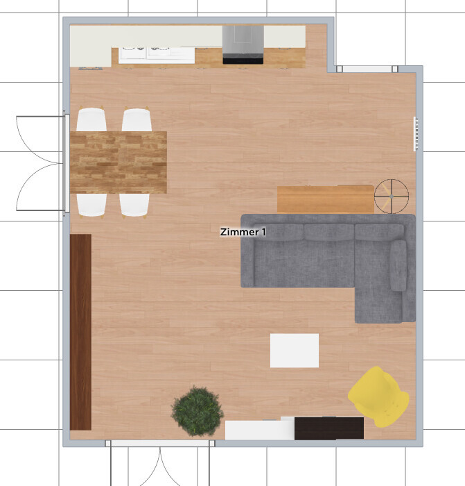

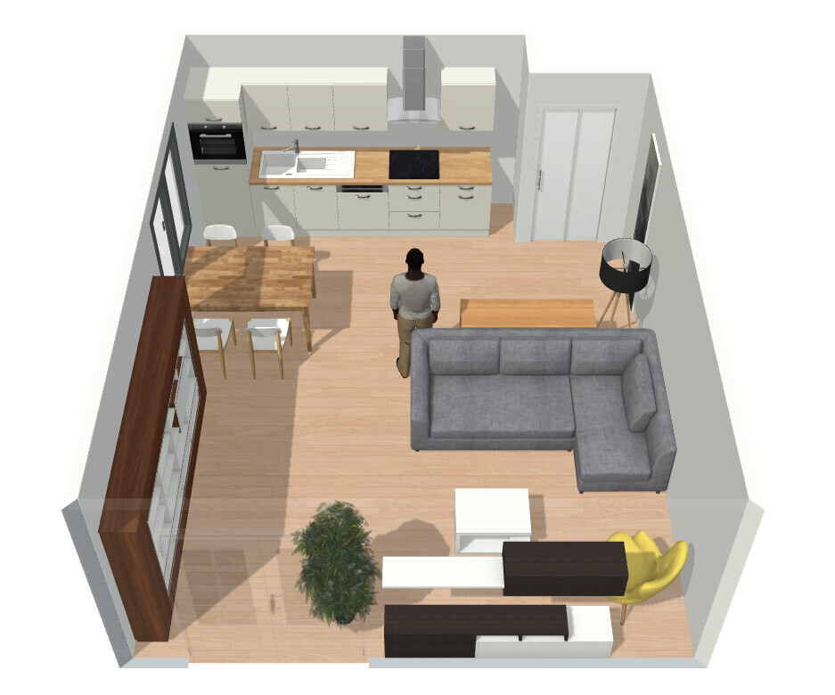

10 Aug 2016 19:46
I gave it a try, and I have to say that furnishing the space is possible.
However, I wouldn’t fit three people into this living room.
The furniture dimensions are standard – the kitchen is just a placeholder.
