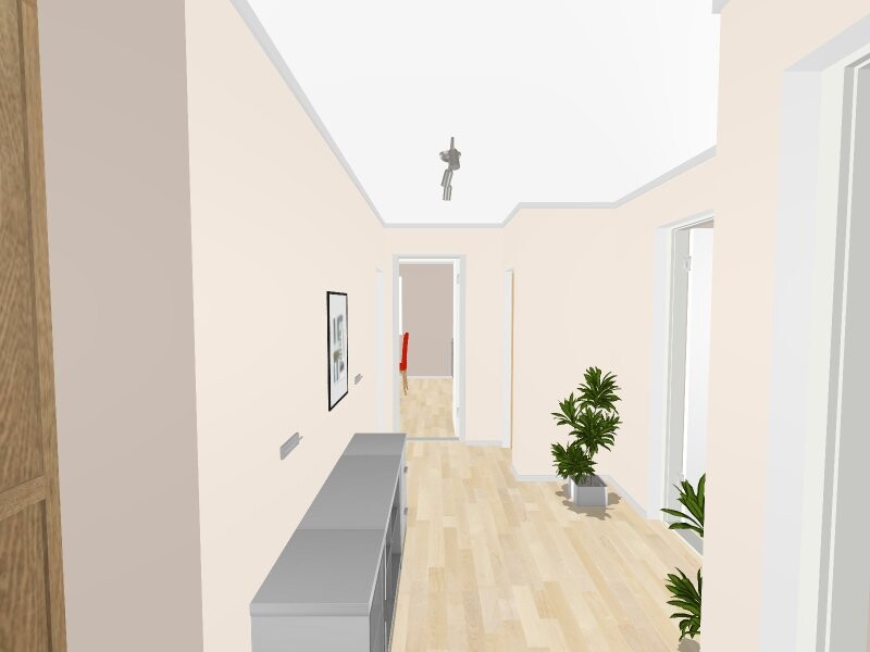

I’ve added a picture here showing what the hallway looks like, for example, with a recessed wall next to the WC.
I generated this in about 5 minutes, so it’s definitely not optimal.
However, in my opinion, this has nothing to do with a long corridor like you’d find in office buildings.
Of course, it’s not a completely open space either, but that’s not what we want.

26 Feb 2015 14:46
derelvis schrieb:
But in my opinion, a long corridor like in office buildings has nothing to do with this.
Not at all. Fortunately, it is prohibited to block main circulation paths with furniture if they are below a certain width, such as narrow corridors.
At home, you can still cautiously move around corners at a snail’s pace, but at a normal workday pace, by the second day you will definitely curse having furniture in that corridor because it gets in the way. Passing each other there is also not an option 😉
Nice software, isn’t it? I have it too – you can nicely view every little picture.
It reminds me of a recent floor plan discussion where the corridor had three corners and ledges on one side, and on each wall, no matter how short, there was a sideboard – completely unusable. But the thread starter (and thus the user of the software) had fallen in love with that picture of the corridor 😱
derelvis
26 Feb 2015 16:10
We already have a very similar corridor (about 1.5 m wide (5 feet), just longer) and also have a writing desk there.
The fact is, I would like to have suggestions on how to work around this issue.
You don’t like the hallway, I understand that by now, and you don’t have to. 🙂
