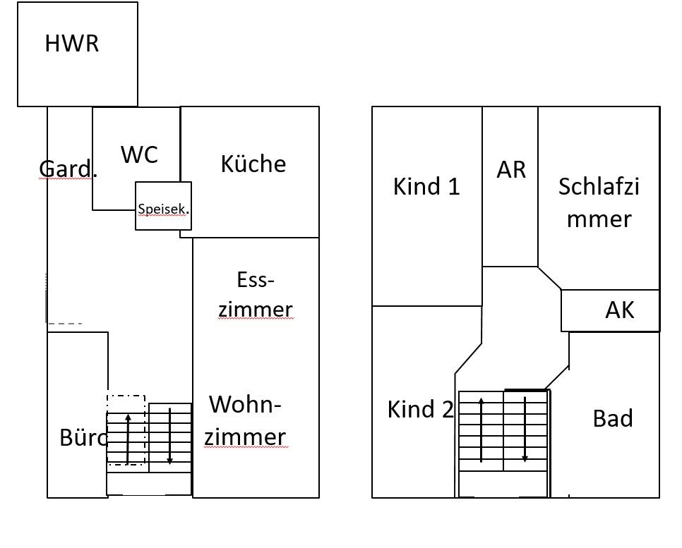

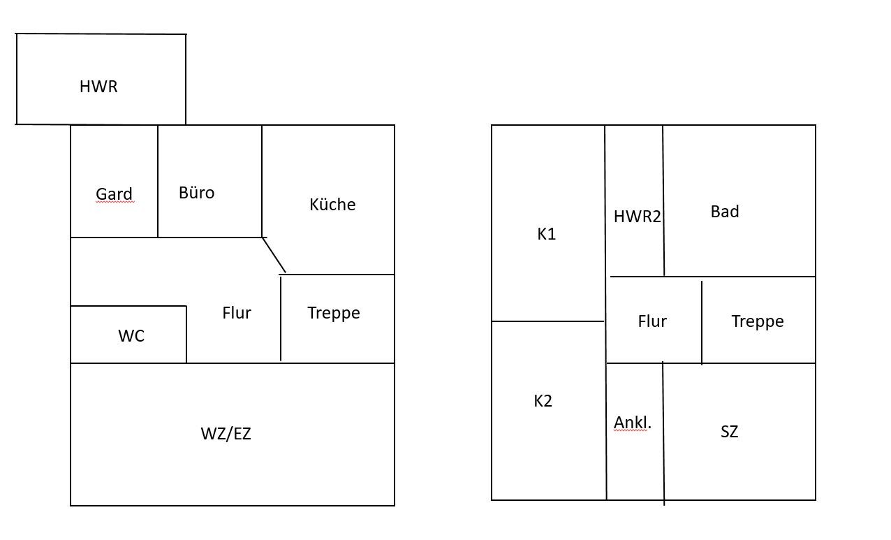

hausnrplus257 Mar 2020 11:59
Tell me, the model that is said to be closely related to this design can only be similar in its external dimensions or layout.
The company starts from a blank sheet of paper, and none of the example floor plans even come close to ours.
Attached is again an approximate drawing of what the company’s original design was (bay window and dormer included, which I didn’t quickly add).
On the ground floor:
However, the living room was too narrow with that layout, and the WC window next to the entrance has already been widely discussed here, and we are also against it. Therefore, the WC was moved to the north side = more space for the living room.
Furthermore, the front door can be shifted somewhat more centrally under the bay window.
The front door should ideally open to the left, so the office and hallway were swapped. The WC was then placed next to the kitchen due to existing plumbing connections (also, no window option next to it because of the utility room).
On the upper floor:
We simply swapped bedroom/dressing room and bathroom/utility room 2, since we prefer to sleep in the northeast rather than the southeast.

Our original idea was the staircase in the south (see attachment). We really like it upstairs, but downstairs it breaks up the south side and the office loses the evening sun. Unfortunately, it also creates long corridors. See pictures.

haydee
7 Mar 2020 12:19
The rooms don’t need to be larger; the ducts need to be removed.
Different stair position, different hallway, not centered straight through. Everything completely rethought.
Office, WC, cloakroom — no ducts; kitchen closer to dining or terrace.
Upstairs, you can swap the bathroom and bedroom.
We have sloped ceilings in our second apartment — should be similar to yours — I have bumped my head so many times in the bedroom, and the toilet in the bathroom hangs a bit lower.
Having the kitchen completely separate from dining and living areas is not ideal with children. You can’t be in two places at once.
Cooking and dining together allows you to combine housework with supervising homework or playtime.
A large sliding door to the living area lets you connect or separate the rooms as needed. There’s a reason the open-plan concept is popular.
A kitchen facing the terrace isn’t just convenient for quick breakfasts outside; it also significantly reduces the distance to the snack cupboard, coffee machine, and beverage station.
Kids, if allowed, live mostly outdoors. With mild winters like this one, the outdoor season never really ends.
The original floor plans are not very impressive either.

hausnrplus257 Mar 2020 13:55
haydee schrieb:
The rooms don’t need to be bigger; the ducts have to go.
Different staircase position, different hallway, not running through the center. Everything completely reconsidered.
Office, toilet, coatroom—no ducts there, kitchen closer to dining area or terrace.
Upstairs, you can swap bathroom and bedroom.
Where to put the staircase? In the middle of the house? Your idea was putting it in the corner, but you didn’t respond to the triangular landing. Or how do you fit a staircase into a corner? And as I said, only one skylight in the bedroom?
The hallway has to be in the middle if the main entrance is in the middle.
Main entrance facing north? That was also an idea, then you get a west-facing room, but with the laundry room in the north, the kitchen loses a window side.
Rearranging everything without changing the useful positioning related to the cardinal directions? That is exactly our problem. Hence our participation here. We realize the ducts are problematic. That needs to change, but we don’t know how!
Upstairs: bathroom and bedroom are as desired now. We swapped them according to the builder’s drawings.

haydee schrieb:
Kitchen completely separated from dining and living areas is suboptimal with kids. You can’t be in two places at once.
Cooking and eating together lets you combine housework with helping kids with homework or supervising play.
A large sliding door to the living area allows you to connect or separate spaces as needed. The open-plan trend has its reasons.
With children: Definitely something we consider. But an open kitchen, although not desired, only for the 4-5 years when you have toddlers?
Trends? They’re a matter of taste… urban villas? Anthracite window frames? Concrete-look tiles? Black floor tiles in the bathroom? Open tiled shower? Handle-less black kitchens? All white walls? … I could go on forever. All trends, but none for us.
I’m not saying the open-plan trend doesn’t have its reasons. It’s just that we have different priorities.
haydee schrieb:
Kitchen to terrace is not only convenient for quick breakfasts outdoors, it greatly reduces the “sand dunes” around the candy cupboard, coffee machine, and drink station.
Kids, if allowed, live outside. With mild winters like these, the outdoor season never ends.
Quick breakfasts on the terrace aren’t really our thing. The point about dirt is valid, though! Supports having a terrace door near the kitchen.
You could put the terrace entirely on the east side. But then there’s the long-discussed topic of the “optimal terrace” location. Ideally, a terrace all around the house, depending on the season and weather/temperature.
What do you think? Terrace only on the east for better connection to dining/kitchen, or east-south terrace for more flexible sun exposure and temperature control?
I want to thank you again for your input here. In general, it’s only helpful if there are alternative proposals.
A (to exaggerate) "put all rooms on the south side" just isn’t feasible… so, for example, the staircase would be awkward there: where else to put it?
Do you think a different staircase design (that would break our hearts) would bring the ultimate solution? ....
