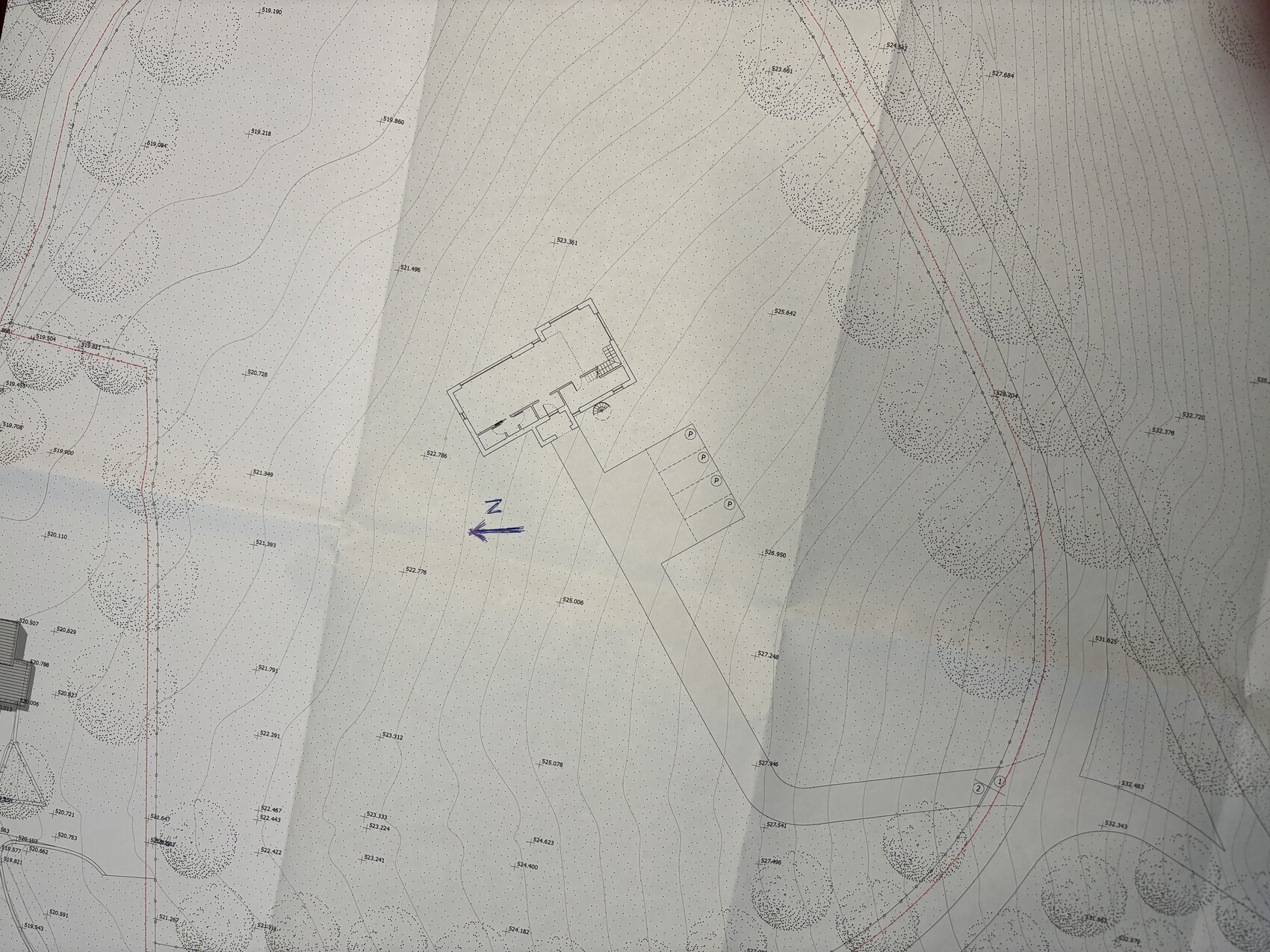

About the project: We have purchased a plot of land in Tuscany (10,500 sqm (2.6 acres)) located on a hillside (I would say a moderate slope / with an elevation change of 2m (6.5 ft) across the area where the house will be built), overlooking a small town in the valley and the hills of Tuscany. The plot faces northeast. The house (and later a small separate studio as well as a pool) will be a gathering place for the entire family.
The architects have already created initial floor plan drafts and have also consulted with the relevant authorities regarding size and construction method to ensure that the volume can be built as planned. An official building permit / planning permission has not yet been granted, as it is still early in the process.
I have attached a topographic map showing the house positioning as the architects suggested it would be most sensible, especially considering the view (towards the northeast). There is another house nearby that is already connected to electricity and water. The water is sourced from a spring. The pipes run along the lower edge of our plot, meaning the water must be brought up to the house (height difference about 7m (23 ft)).

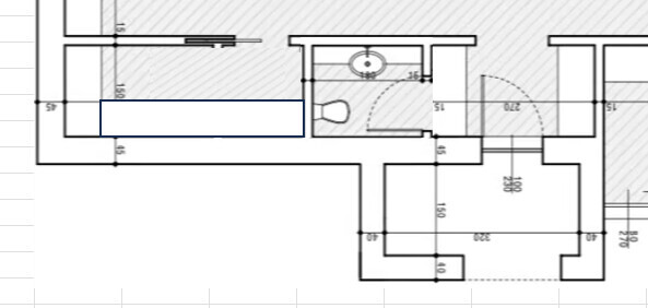

I'm not a floor plan expert, but having a toilet next to the kitchen is definitely not acceptable. Also, the kitchen/dining area feels very narrow and elongated. Furthermore, you enter the house directly without a proper entrance area. The staircase to the upper floor is also, in my opinion, quite terrible.

hanghaus2023 schrieb:
There is a 2.5m (8 ft) height difference around the house area. Your budget won’t cover that. The site development alone will cost around 100,000. Please rotate your plot so that north is up.

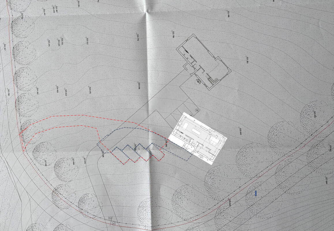

hanghaus202323 Oct 2024 12:45I have slightly repositioned the house. There is only a 10% slope. The site development has been reduced by 50%. The house is approximately 3 meters (10 feet) higher.
In red, an alternative access route without a 15% incline. Although in Tuscany, a 15% incline should generally not be a problem. Or does it snow there as well?

There was also criticism about the toilet next to the kitchen. At first glance, it wouldn’t bother me because of the sliding door and hallway buffer, but I find it a bit odd and unpleasant that the bathroom and pantry share the hallway.
