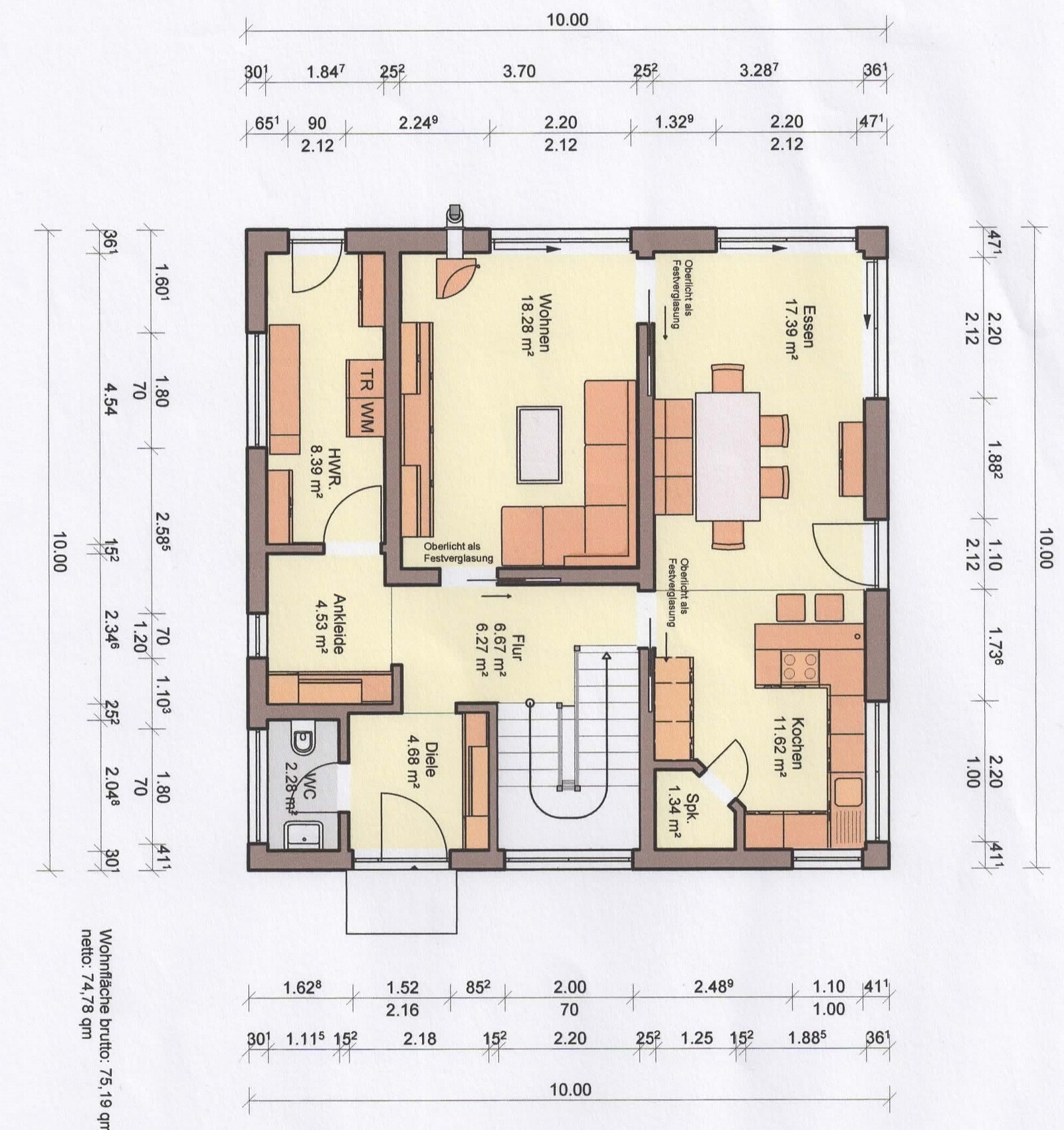

Schneckham9 Jul 2016 14:38Hello everyone,
After a lot of back and forth, we have found a floor plan that we like.
I left out the basement in the attachment since it only shows the essential walls.
We would appreciate your opinions.

Who designed it: initially by us but later refined by a university of applied sciences company
What do we particularly like?
The option to separate the living room from the dining room
What don’t we like?
Utility room is a bit narrow
€320,000 with floor and special requests
€330,000 (excluding basement)

What we don’t want to give up: the half-landing staircase.
We are open to suggestions, though.
The house is currently planned with the dining room in the southwest corner.
I hope I haven’t forgotten anything.

The site plan is missing. The north arrow is missing. Where is the terrace, etc.?
Master bedroom .. why have a walk-in closet and a separate bathroom, but with the bedroom as the central hub?
What is the purpose of the utility room on the ground floor? You have a basement, right? And what is intended for the basement?
I don’t find the living room too narrow, but I’m still unclear about its location and layout.
This pantry corner in the kitchen .. What is it for? You have a basement.
I have difficulty visualizing the exterior views and don’t see any clear intention behind the window placements. How do the elevations look with the windows included?
Architects would likely criticize having the sewage line run through the living room.
Personally, I find the layout lacks spaciousness—there are too many walls obstructing the view. However, this is subjective and depends on individual preferences.
The basement is overlooked in this design, and using the bedroom as a circulation area is not well thought out; you could do without a walk-in closet. This could be balanced by swapping the two rooms.
So, a few basic things are going wrong here, some of which have already been mentioned.
The upper floor (parent area) should be reconsidered. The bedroom's focal point is counterproductive. By the way, I would never want to sleep under the window. The door opposite later blocks the option to mount a TV.
MarcWen schrieb:
The upper floor (parent area) should be reconsidered. The bedroom’s pivot point is counterproductive. By the way, I would never want to sleep under a window. A door opposite will later block the option to mount a TV.I’m only noticing this now: from an energy efficiency standpoint, the bed position is terrible. With a window at the head and openings in every wall, it will be impossible to rest properly if you’re even slightly sensitive.
