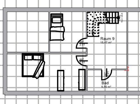

Ibdk1411 Nov 2021 16:52
My first idea – quickly sketched as usual and without exact measurements.
Black-and-white floor plan of a house with bedroom, bathroom, and living area.
11ant11 Nov 2021 17:10
Bayerwaldler schrieb:
Unfortunately, there is no more space available for this in the rest of the house. Do you have any saving ideas for a floor plan like this?
We don’t even have an idea of the “rest of the house” yet. You just appear out of nowhere here at our garage, and we don’t know ANYTHING about your background on Melmac, Shumway!
On what basis are we supposed to come up with any saving ideas?
