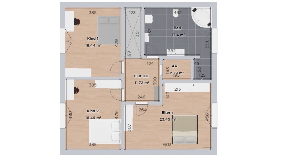

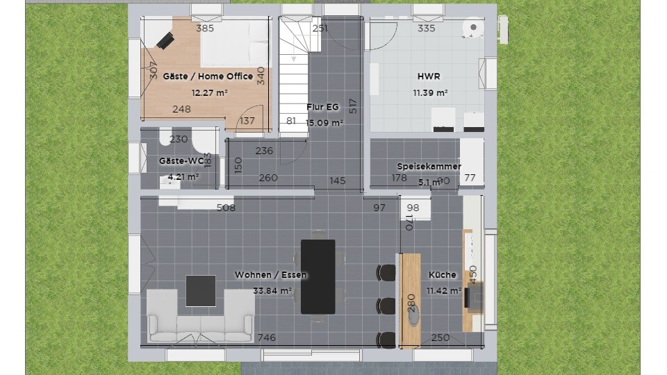

As recommended, I mirrored the house, integrated a shower into the guest bathroom, planned a 1.80m (5 ft 11 in) casement window with a sill on the upper floor, as well as a roof window above the toilet @ypg. There will be a storage room with a door under the stairs. The sliding door between the hallway and the living/dining area was removed to allow more light in.
According to the general contractor, the exact planning of the rooms and interior walls will be done during the detailed design phase, so he advised me not to worry too much yet. In the kitchen, we would like a window strip of about 3m (10 ft), so the furniture still needs to be redesigned (this has not yet been done in the attachment). I am also still discussing the wardrobe in the bedroom with my wife.
What bothers me a bit is that the guest room is now on the west side next to the double carport. What do you think? Do you have any other suggestions or opinions?

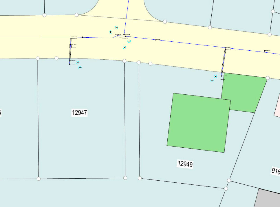

P.S.: To the east of us is the property of my in-laws. There is a 3m (10 ft) path between the properties. Would it be better to mirror the house “back” again or leave it as it is?

It already looks really good!
Would additional double casement windows on the upper floor in all rooms be useful, or were they just not shown on the plans?
We also have a kitchen counter like that but ultimately decided against bar stools since the dining table is right next to it, and we didn’t miss having the stools. Otherwise, I think it would be “too much” with too many chairs at once. We have shelves partly with doors facing the dining area, which is also handy for storing items you might often need for meals.
Does a 2.79 m² (30 sq ft) storage room make sense? Your bedroom is quite large; maybe it would be better to take some space from there? We have a 6 m² (65 sq ft) storage room upstairs, and I wouldn’t want it any smaller, as otherwise it’s not very useful…
11ant18 Feb 2021 15:14
chrisw81 schrieb:
Does a 2.79 m² (30 ft²) storage room make sense?
Probably not on its own, but having a separate vacuum cleaner for the attic instead of carrying it upstairs is quite convenient.
