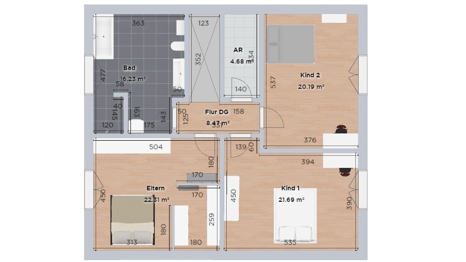

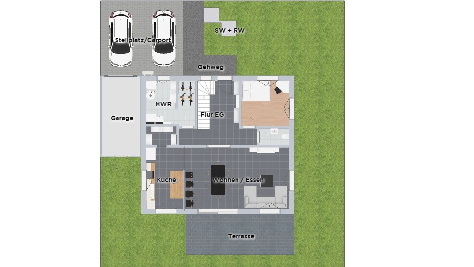

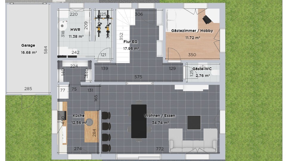

Mr.Graves13823 Dec 2020 12:01Hello everyone,
Thank you all for the initial helpful opinions and suggestions. I have now revised several things (see attachments):
- The "storage room on the ground floor" is intended, for example, for two bicycles/sleds or similar items. I have integrated this room into the utility room.
- Replaced the narrow stringer staircase with landing by a quarter-turn staircase and moved it closer to the utility room.
- Removed the door from the hallway to the pantry; now access is only possible through the kitchen.
- I have not yet finalized the kitchen design. It is planned as either a galley or U-shaped kitchen. Would you recommend removing the west or south window? Or keeping both? The kitchen dimensions are spacious at 4.50m x 2.74m (15 feet x 9 feet). Our current kitchen is U-shaped and measures 3.23m x 2.23m (11 feet x 7 feet). A 45cm (18 inch) wide granite countertop is planned to serve as a bar on the wall (about 130cm (51 inch) high).
- What do you think about the walkway to the front door? I have tried to avoid SW + RW for aesthetic reasons. Can grass be allowed to grow over it, or would you recommend integrating these materials into the walkway?
- The issue with the cabinets under the limited-height sand-lime bricks unfortunately cannot be solved differently due to regulations. I am thinking of cabinets designed for sloping ceilings.
- A shower on the ground floor is not desired @Schimi1791.

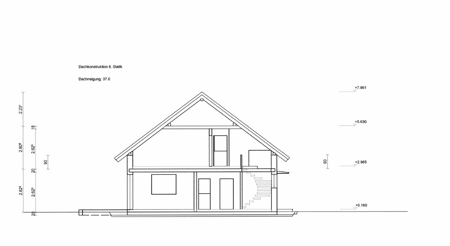

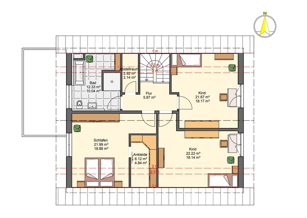

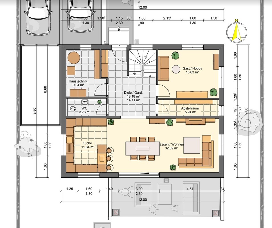

Attached are the cross-section and floor plan from the general contractor (for external dimensions of 12.0 x 9.80 m (39.4 x 32.2 ft)).
